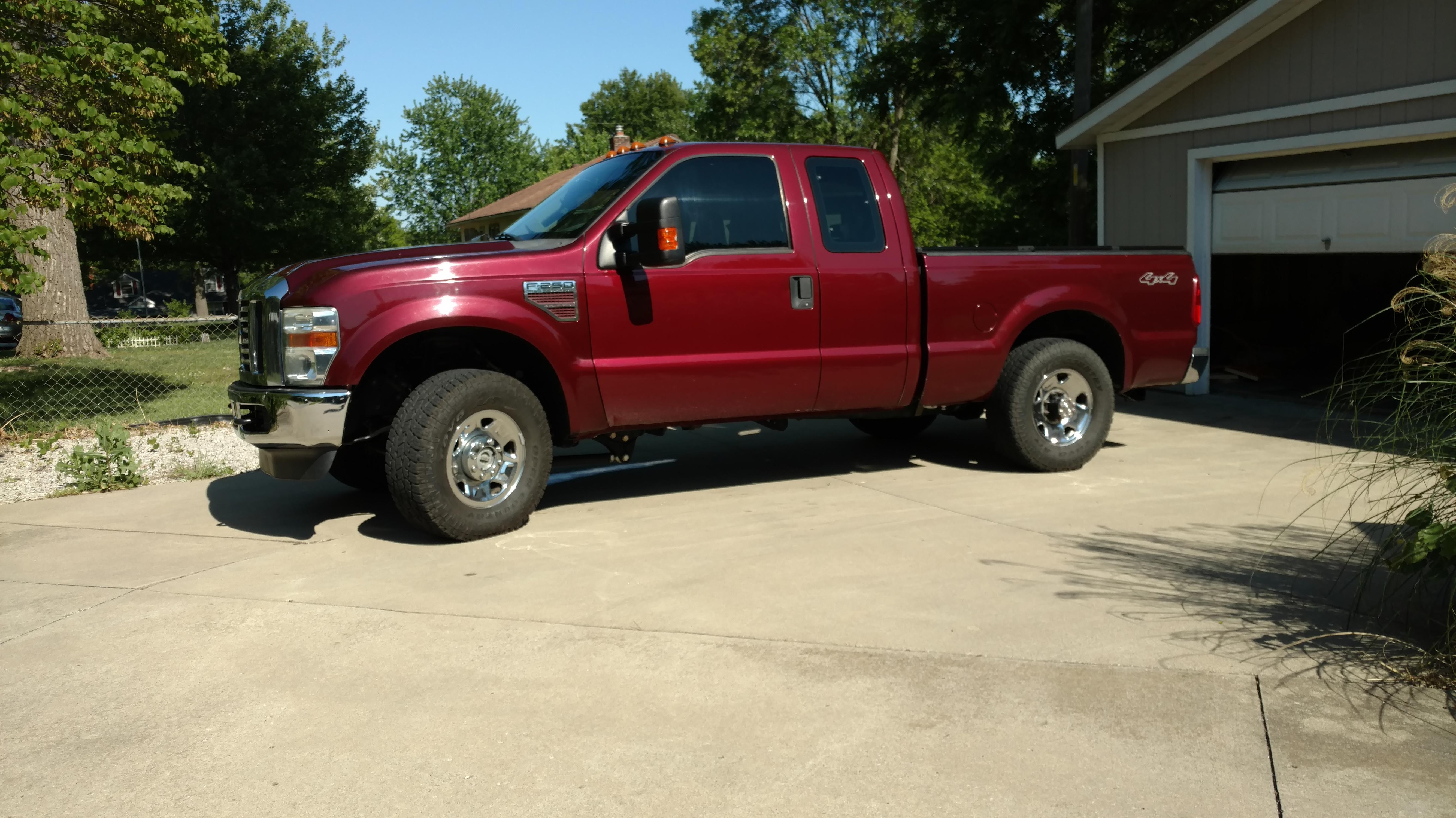

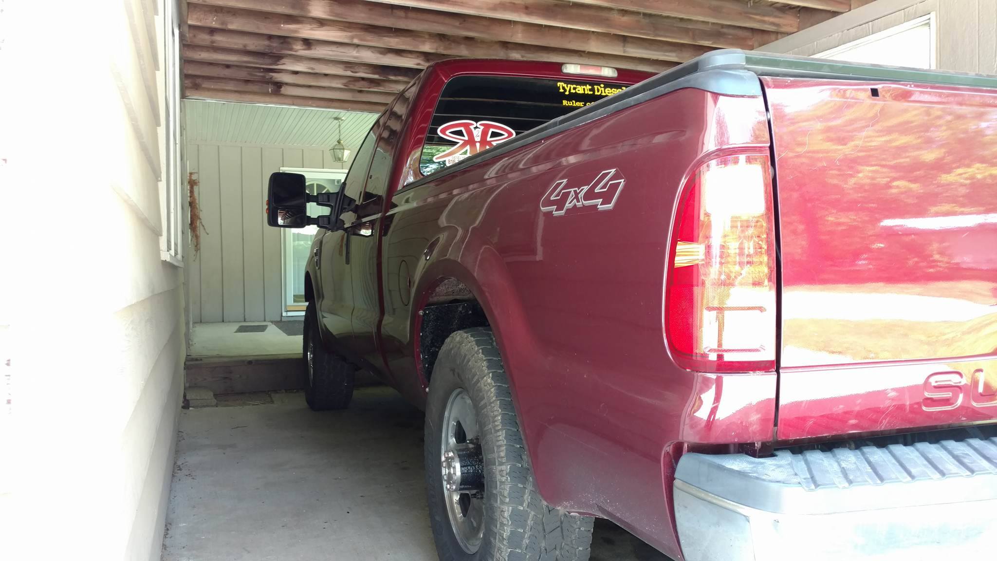

Also I dont recommend 4800 springs and no rear block with fat leaf removed, my truck was super squatty. I put the block back in when we got the bars on Tuesday and it looks much better, fat leaf still out. 4400's and no block/fat leaf would probably be just right.
Attached a few photos after the rear-end was in and rear block out. Its not super obvious b/c my driveway is slanted, but rear is squatted looking. I'll get a new photo of it with the block in ASAP.
