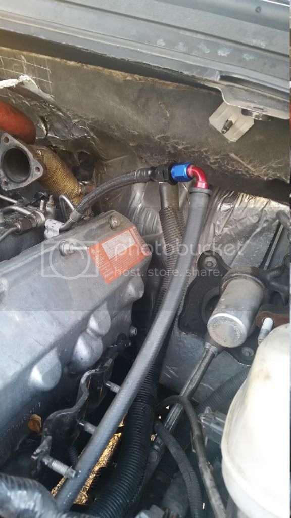

Here's a few pic's of Morgan's fuel bowl delete and a mini write up of my install.
1st off, everything is good - High quality pieces and we'll thought out.

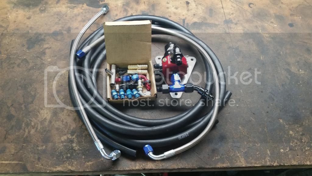

This is a pic of what comes is the dual pump delete kit.
I had the turbos off so access to the hpfp was no problem.

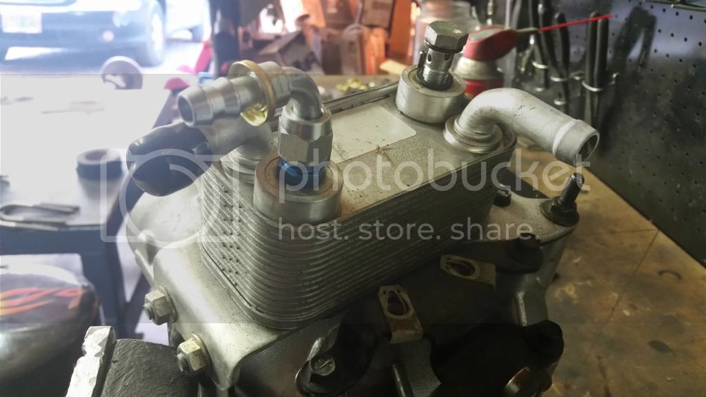

In the kit are 4 AN adapters.
2 for the 2nd pumps feed and return ports.
1 for the feed on the factory hpfp
1 for the exit of the factory fuel cooler - if the factory cooler is kept
I chose to delete the factory cooler.

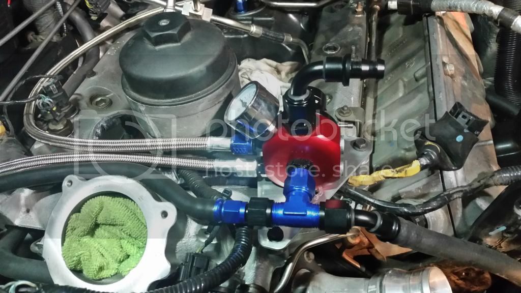

So I used the supplied line splice on the factory flexible return line that's before the cooler.
Here's were the T fitting comes into play.
I removed the hard plastic cover on the wiring and routed the wires under the regulator.
Overview
Impression :
Top notch kit with all the right parts and flexibility to fit a wide array of setups.
It's functional, has that custom look, yet simple to install.

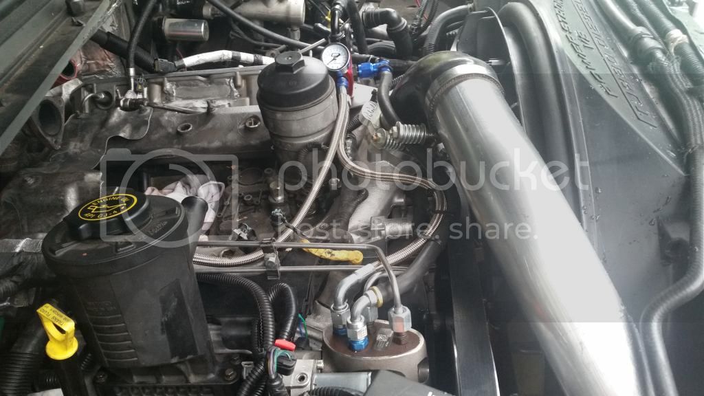

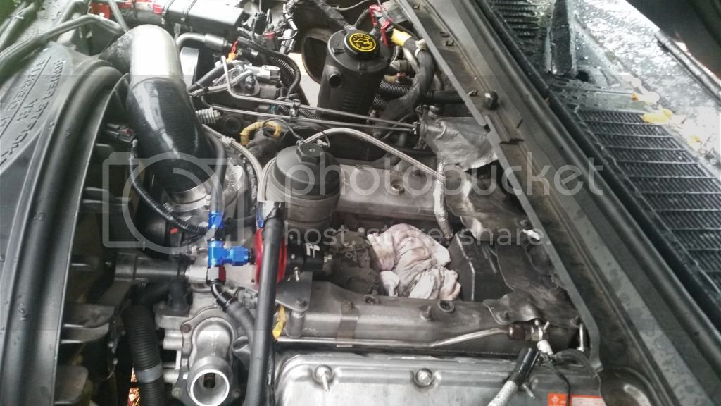

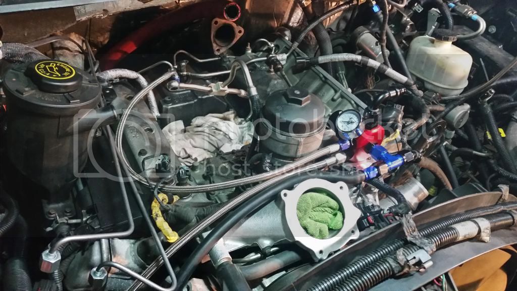

Final installation is now complete.
Figured I'd add the fully completed pics to this thread.
Also big thanks to Steve at AP, absolute performance,
he hooked me up with a steal of a deal on this kit.
