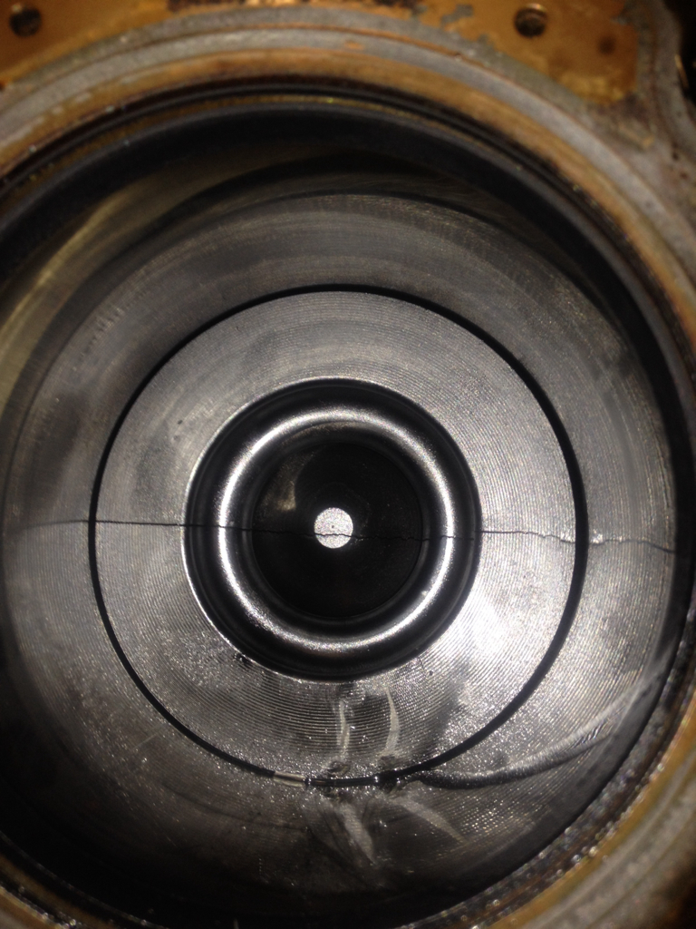

As the title states the truck is a 2008 f250 ccsb it was featured in the June issue of diesel power. the truck was my daily driver until a couple mouths ago. In the middle of harvest it started a miss and had low compression in two cylinders.

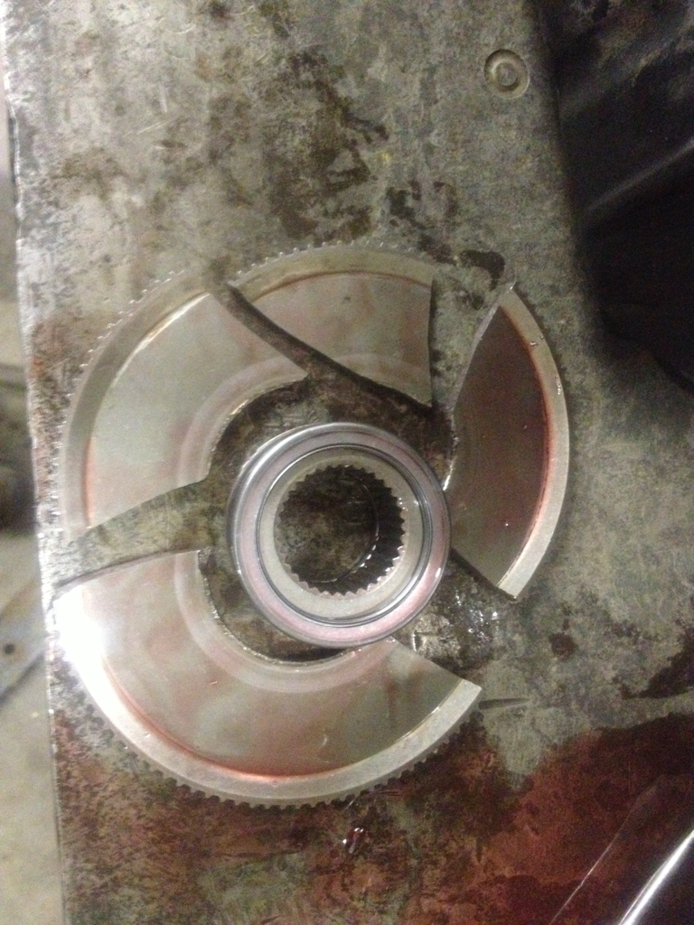

Then it got expensive fast I hooked it that night and bloke the low reverse hub and ruined almost everything from the converter and input shaft to the output shaft. Not a good day to say the least.
Finally got it back together with a new rcd convertor and input shaft and Morgan built the trans again and added billet internals. At that point it ran for a while, I dynoed a scheid and layed down 811.1 hp. It ran into fall and hooked one more time. It ran for about three weeks. Then one day it started a miss and had a lot of blow by so I parked it until about a week ago.
