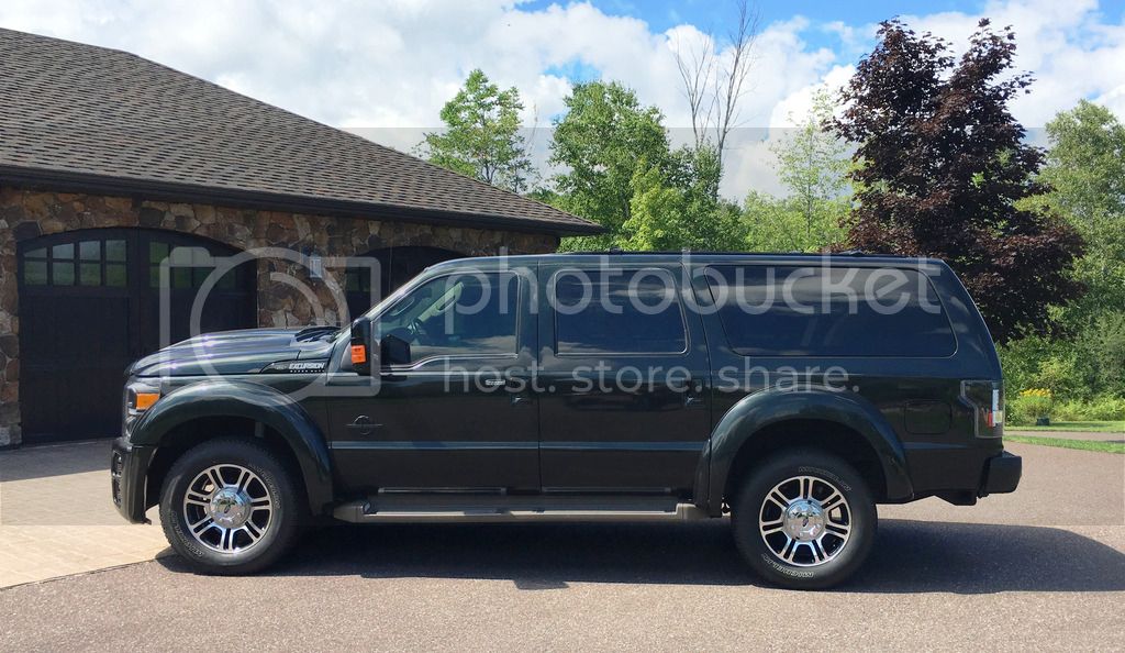

Picked up a 2005 6.0 Eddie Bauer with just under 70k miles.
Bullet proofed it:
Head Gaskets OEM 18 MM Dowel
SCT X4 Programmer
ARP Head Studs
Sinister Coolant Filter
Custom Diesel EGR ******
Intake/Exhaust Gaskets
4" MBRP Exhaust System, Turbo Back T-409 Stainless
MBRP T-409 Stainless Catalytic Converter Test Pipe
High pressure oil stand pipes
Dummy Plugs
STC Fitting
Turbo Oil Drain Tube Update Kit
Steel Turbo Oil Feed Line Update Kit
Cleaned out exhaust back pressure tube
3C3Z9T517AG Blue Spring Upgrade Kit
Riffraff Diesel Billet Compressor Wheel 05-07
Edge Insight CTS Monitor
CAC Intercooler "Hot Side" Boot Kit & SS T-Bolt Clamps
Upper & Lower Oil Pan Gaskets
Bed Plate Seal
Timing Cover Gasket Kit Set
Rear Main Seal W/Rear Cover Gasket
Low Pressure Oil Pump and Seals
Valve Cover Rocker Box Carrier Gasket Set
Exterior Conversion

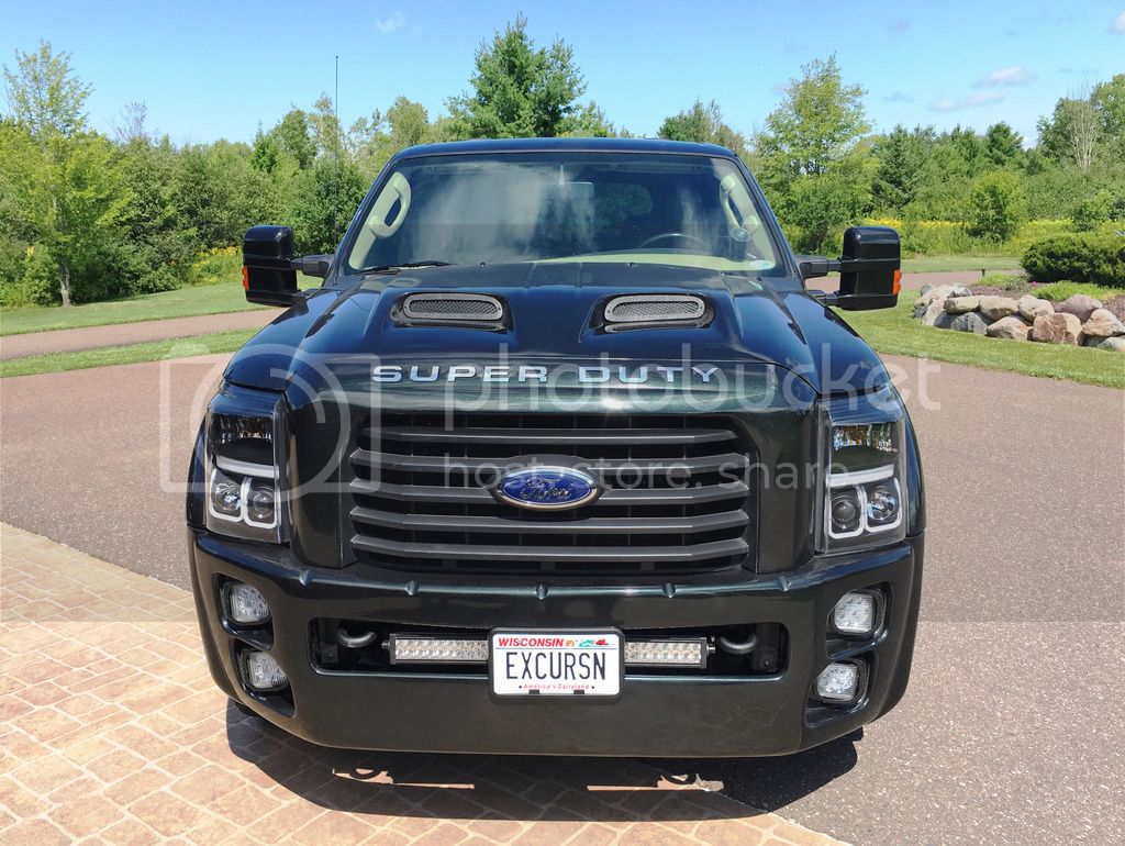

2016 Ford Front End
Double LED Fog Lamps and LED Light Bar Between Tow Hooks in Custom Double Front Bumper
Custom Hood Scoop
F-550 CUSTOM FLARES.

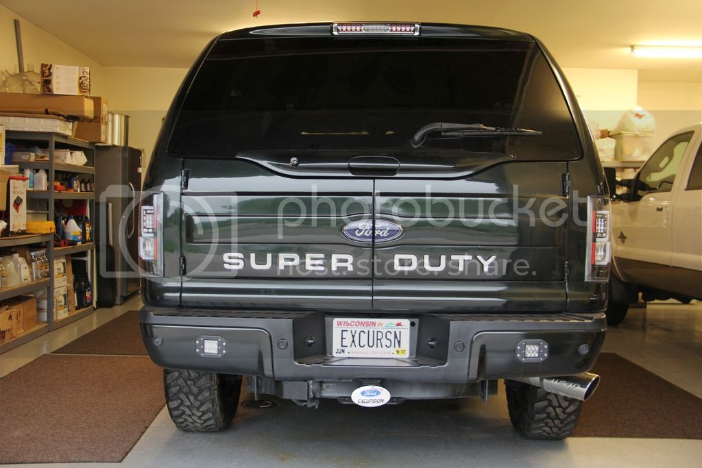

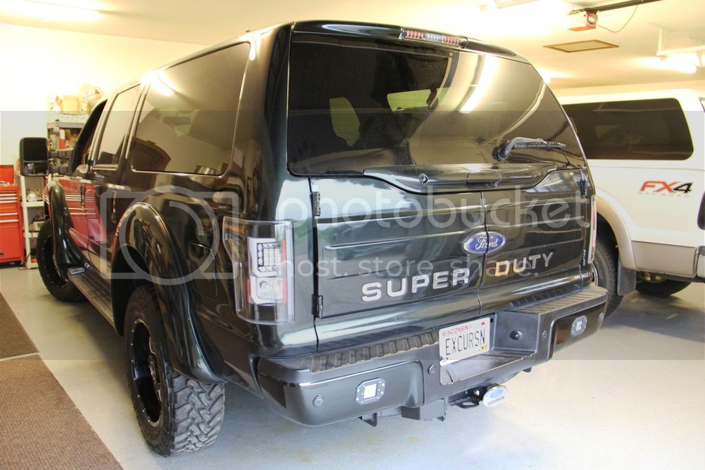

Updated F-150 Tail Lights
Custom Platinum Super Duty Rear Barn Door Emblem
Rectangular 2016 Super Duty Fuel Door
Tow Mirrors
Updated 6.0 and Super Duty Emblems
2015 KR Running Boards
Rear Bumper W LED Back Up Lights
Custom headlights, Tail Lights and 3rd Brake Light
Stock Original

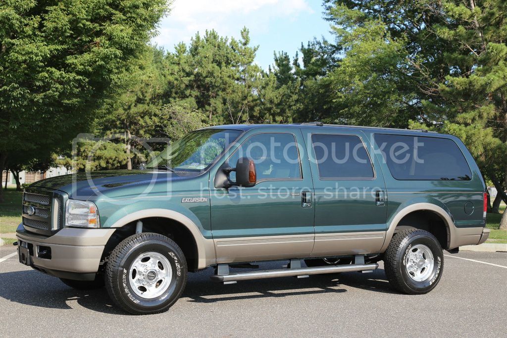

Info From Semi Amusing Sale Ad:
2005 FORD EXCURSION 4X4 EDDIE BAUER ~ ~ POWERSTROKE TURBO DIESEL (68.643 ORIGINAL MILES) 1-OWNER CLEAN CARFAX GARAGE KEPT NON SMOKER BEST COLOR COMBO (ASPEN GREEN) COLOR VERY RARE! ALL THE OPTIONS! REAR DVD ENTERTAINMENT REAR CAPTAIN CHAIRS STEERING WHEEL CONTROLS HEATED SEATS MEMORY SEATS ADJUSTABLE PEDALS REAR PARKING SENSORS HOMELINK NEW TIRES ORIGINAL OWNERS MANUALS ORIGINAL WINDOW STICKER OF $ 55.630 !! CARPETS PROTECTED SINCE NEW RUNS AND DRIVES EXCELLENT ALWAYS SERVICED AND DETAILED NEVER HAD A TUNER! ALL STOCK!

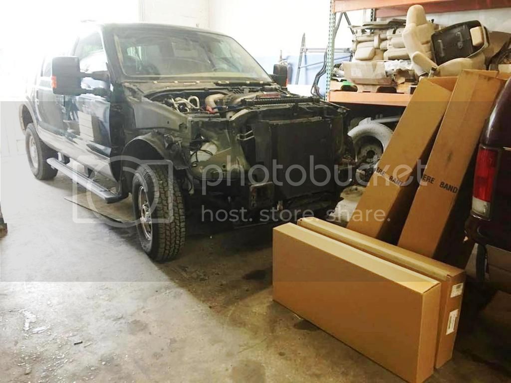

The Conversion
Bullet proofed it:
SCT X4 Programmer
ARP Head Studs
Dummy Plugs
STC Fitting
Bed Plate Seal
Exterior Conversion
2016 Ford Front End
Custom Hood Scoop
Tow Mirrors
Stock Original
