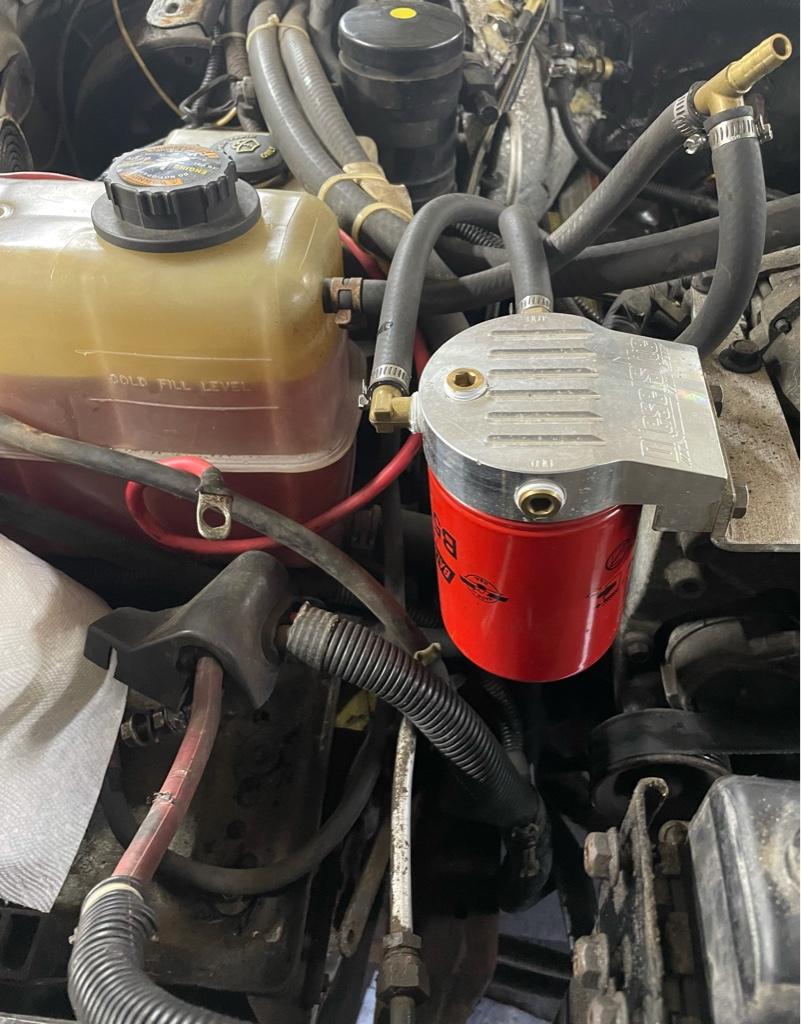

Busted this off today taking off the shroud.
Should I EVEN TRY to fix this or
Replace it?
I really didn’t want to buy a radiator at this point in time but I might be fugged.
Your thoughts?
The plastic nipple goes to the plastic coolant reservoir and coolant filter.

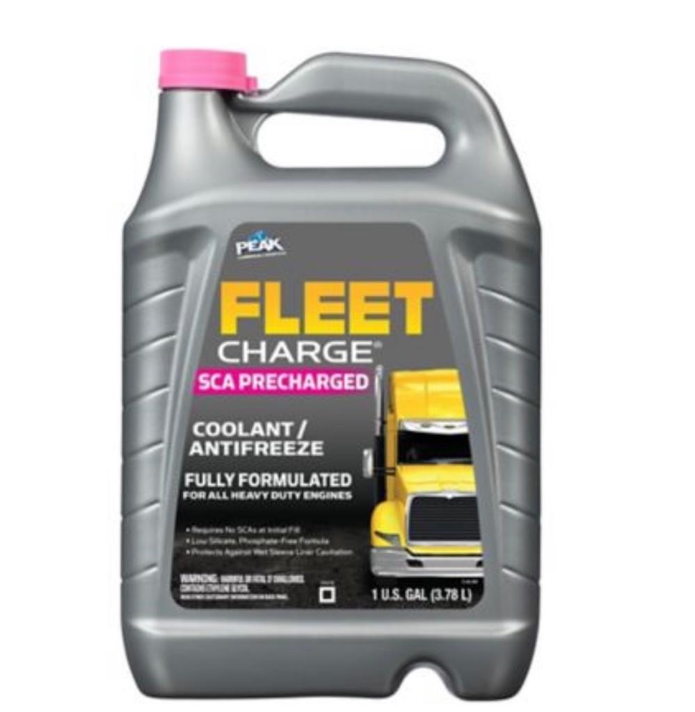

But what coolant are you using?
Sent from my SM-J737V using Tapatalk
Bugman
Aug 20, 2011
1,292
6
Gypsum, Co
I was thinking that.
The first change that I did using it a mechanic asked me where I got the pink coolant from.
We ended up flushing it out for a water pump change out. But it is a good coolant.
