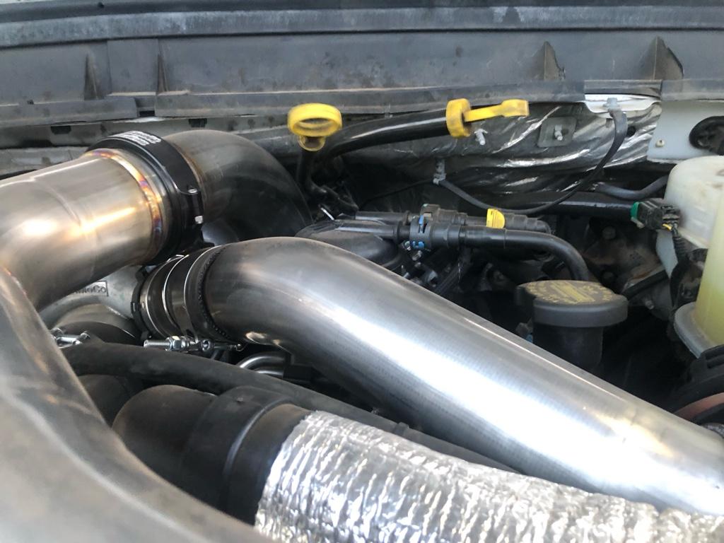

Could you possibly post a picture of how you have that bracket mounted? Recently did the same NL piping kit as well as their intercooler. I think* I can see how it’s supposed to be mounted but would require some real movement of both dipstick tubes. I contacted NL about it and they said they have no pictures to provide and that it can only be mounted one way. Mine are currently wrapped with a shop rag and taped as to not bounce around and ding up the piping.
Appreciate any pics you could provide.

I will try to remember to pop the hood and get you some pictures tonight. I need to pull the ranchhand tonight anyway to get powder coated so I should have the hood up.

There was a tab on the oil dipstick too that I think mounts to the factory plastic intake “y”, that I had to cut off. It was hitting the elbow. But that’s how they sit in the engine bay now. I haven’t tried changing the fuel filter yet though.

Awesome man thanks. That made it a breeze. Lined up pretty well for me with no modification. Fuel filter replacement looks like it’ll be fine but we’ll see.
