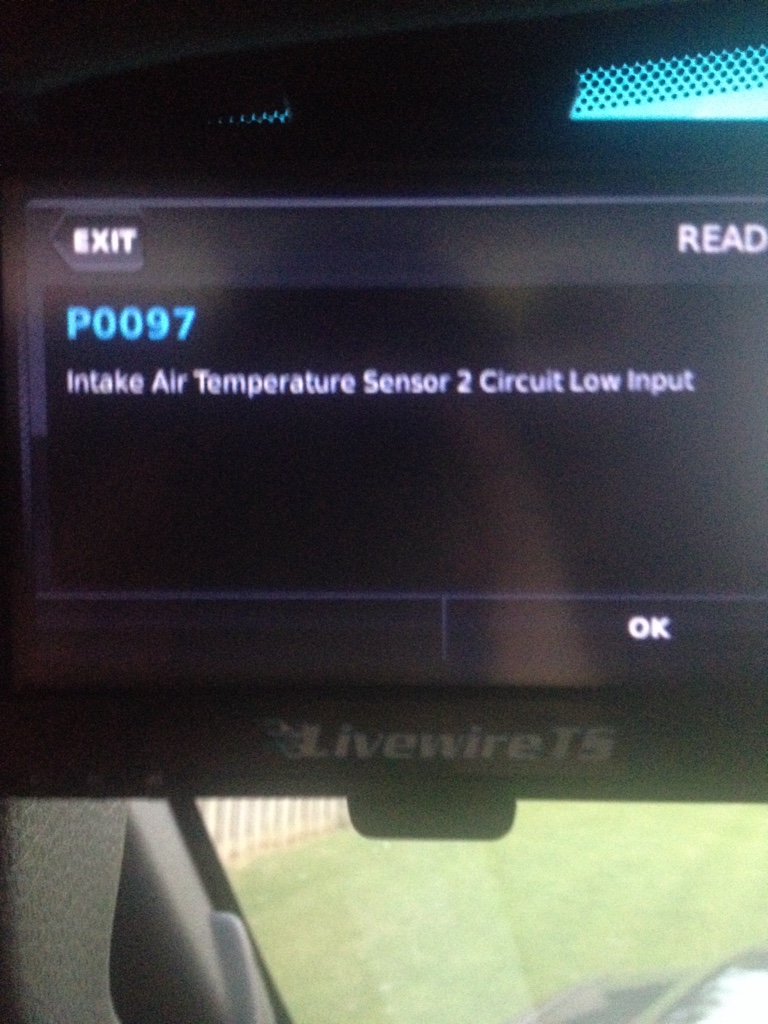

P0097 with deletes
[QUOTE="tbsimmons, post: 1243592, member: 2026"] I have had the EBP sensor take a crap for no reason. So the IAT just going bad doesnt surprise me. Like posted above, check the wires for continuity first. I also had the EBP sensor problems that was broken wires right at the plug. [/QUOTE]
