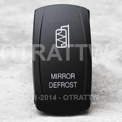

I wired mine using a Carling switch like this so I could turn them on and off. I installed full power (fold and telescope) 2008+ mirrors on my '02.

Do you happen to have the part number for that switch?

You can actually get the switch covers laser engraved from a variety of vendors with just about any graphic you can imagine. That particular graphic is fairly widely available so I would shop around.
Here is one supplier that has a ton of examples of Carling switch covers:
http://www.otrattw.net/home.php
