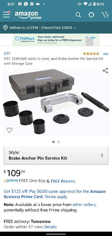

Looking for opinion on brand/model for u joint removal/installation. Thanks!

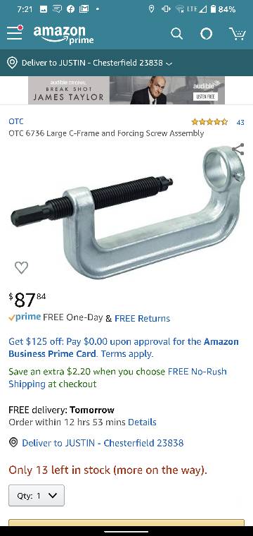

Pretty sure my vice doesn't have the range of motion. Would this be a better one than the one I ordered?Screenshot_20200220-072124.jpg

I had to use the bigger clamp on a 550 shaft, there was no way the smaller one was fitting.

I went ahead and picked up the longer one too. Hopefully I don't need any inserts to just push the u joints out. I can always make something on the lathe though. Thanks again for all your help!

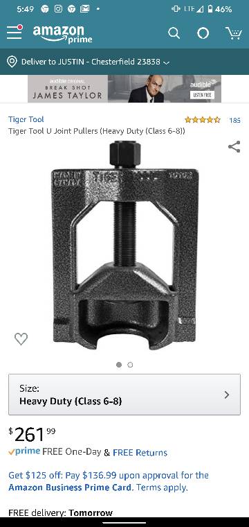

I got a couple of OTC type c clamps. Wondering if it would be worth it to pick up one of these too? O realize that isn't.the right size either.

Not unless you are going to use it on larger shafts.
View attachment 51645View attachment 51646View attachment 51647
Sent from my Pixel 4 XL using Tapatalk
Nah. Just use the above method. Lil heat with that otc tool and they will fall out.
Just clean up the inside of the ears with a Emery wheel small enough to get inside and maybe a snort of fluid film and press them back on.

Thanks for the info Jake! I may hold on to the bigger one as it may come in handy for ball joint removal on other vehicles that might need more room with the adapters in place. I have cut the old ones out with a cutoff wheel the last time I did them and it worked great. I used a press to remove them after that. I'll let you guys know how I like the new tool.
