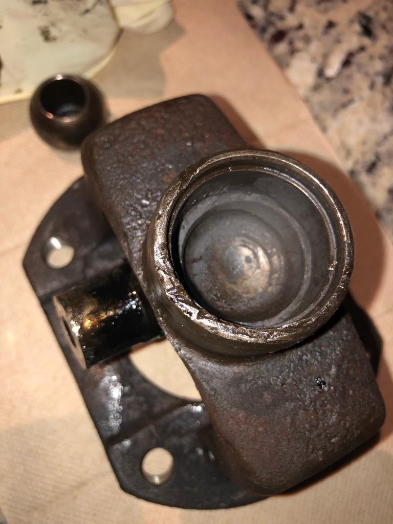

Hi, I was experiencing a severe vibration while accelerating that came out of nowhere. Felt like the whole driveline was going to fall off the truck. I checked the driveshafts and felt some play where it connects to transmission in the rear. When I took it off, the play was actually coming from the CV ball. There’s damage around the slot where the spring goes and around the cv ball around. Would there be any issues if it was put back together this way or is it best to get a new driveshaft and be done with it?

Do not run that. Get a driveline shop to cut the yoke off and replace it and balance the shaft. No need to replace the shaft

I was quoted more to repair than to replace from local driveshaft shop, but that’s without them knowing the damage to the double cardan.
Which part are you saying can be cut? The part of the yoke where the CV ball goes into?
When you say the shaft doesn’t need to be replaced, does that include the part the spring goes into?

You may be able to just get the whole double cardan replaced. Depends how bad the wear is if you need to cut the ends off or not. Should be less than 200 for a full rebuild and balance.

I was quoted close to $800 for rebuild lol
Replacing the double cardan is fine. I’m just concerned about the piece built into the actual driveshaft where the spring drops in and the cv ball flange goes into.

That all gets replaced when they cut the end of the shaft off and weld on the new joint.

Get a new drive shaft. It may still available from ford. It would be $500++ to rebuild in my experience and have regretted every time I tried it.
