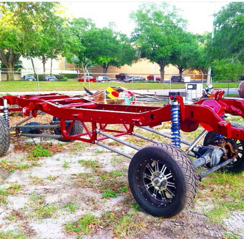

A few people have asked to see my lift so I figured I would put up some pics on it. If u have questions s just ask. I'm not afraid to let anyone know how I did it!

Its a full custom true parallel four link. She rides like a Cadillac and handles like a mustang lol. Not really but close. Not top heavy on turns drives 130 no problem. Pulls sleds with no issues and holds the road on takeoff 100 times better than stock. Its about 12" of lift on 37x22's

Just Creeped your Insta.... Looks decent. What did you do for lateral support on the center section? I didnt see anything underneath so IDK how you tied it into the frame other than welding it to the bottom.

On lifts like this.. is it possible to tuck the center section high and tight for as much clearance as possible?
Yeah I could have but when u do that angles are the devil when it comes to drive line to pinion, and the axles moving when the suspension travels. I did it like this for the way I'm using the truck. I don't plan on rock climbing and such

Looks not too bad! You even got your rear track rod going the right way!

Nice build! Where did you get the allen style bolts for the heims and what size are they? What coilovers are you using? Any better pics of the brackets that bolt on to the front axle that allow heims to be used on that end and where are they from? More pics of the frame would be great.

You even got the shocks with the reservoirs up front for the stabilizers!
Is it just the angle of the picture but it sure looks like your caster is a bit off? Got any better pictures of it finished?

Yeah if you don't mind the Queston what was the bill after EVERYTHING was done? Tires, the whole custom set up, I'm loving it!

I tried not to keep track of the bill lmao. I probably have 15k. I have 5k just in rims. They have the machined windows painted the same Ruby red.

Its in pieces again now but I put the pinion back in the stock spot now. I was having a little bump steer with it angled up.
