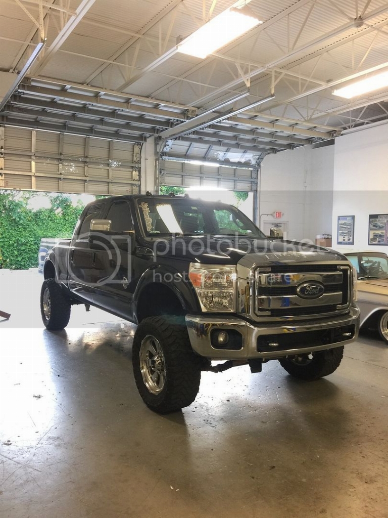

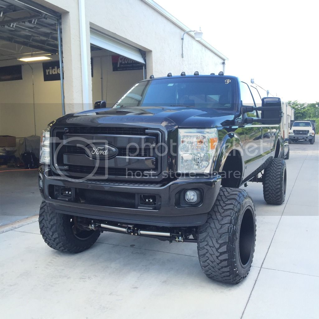

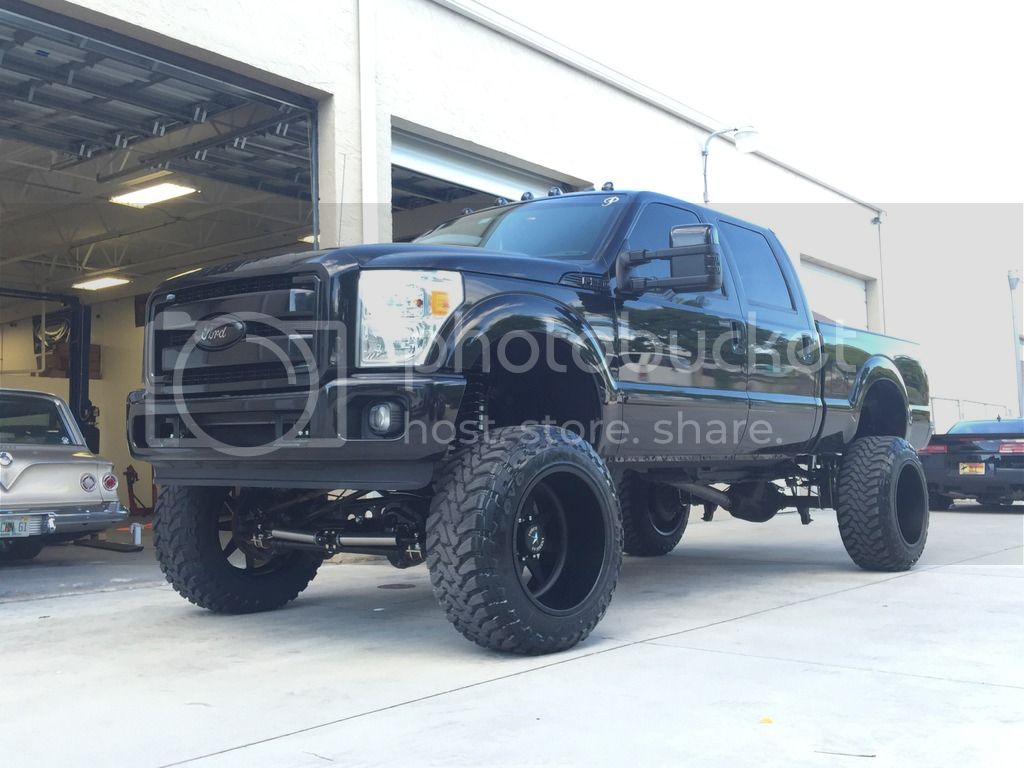

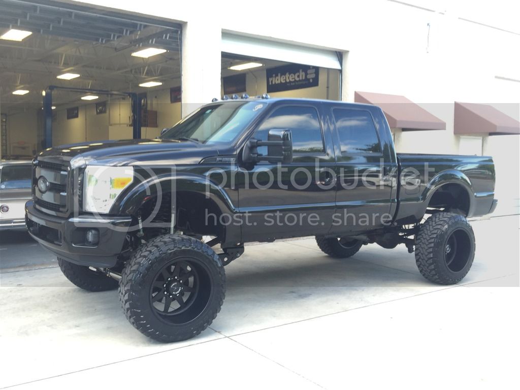

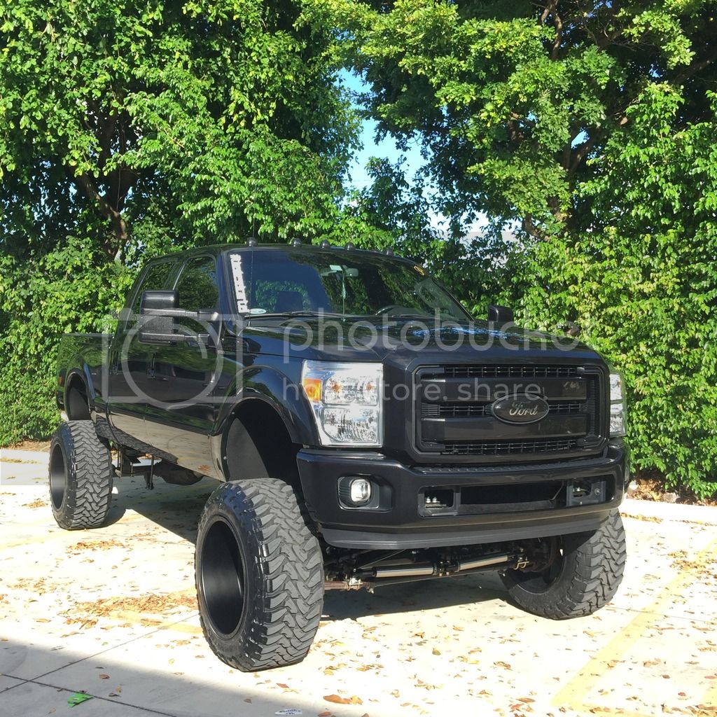

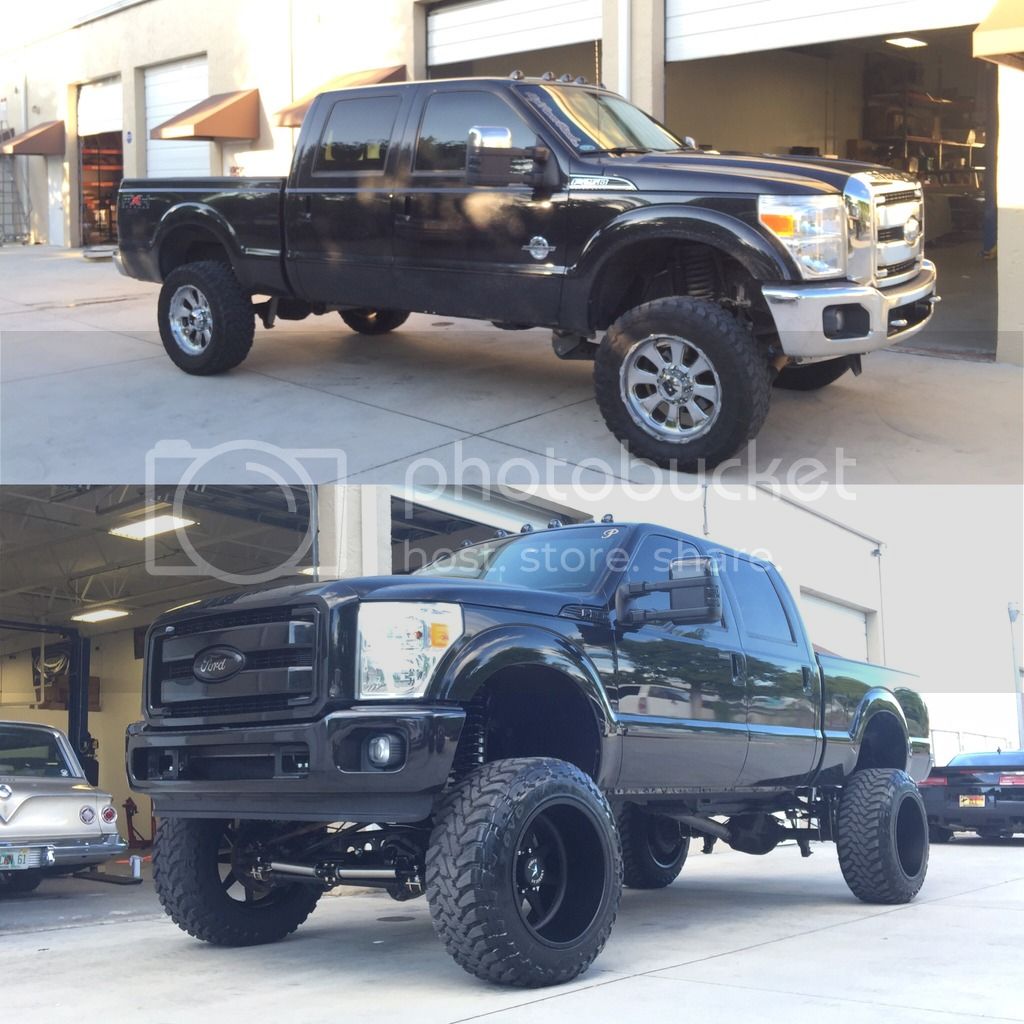

Had a customer with this 2011 come in to see me about doing a makeover on the truck a few weeks back.
We ended up doing the following.
10" Fabtech Lift
22x14 Black American Force Wheels
37" Toyo MT Tires
AMP Steps
Painted all the chrome bumpers, grille, side badges, mirrors, etc.
H&S Intercooler Pipe Upgrade
Next up will be Rigid Fog Lights, Custom Headlights, and 40" Curved Bumper LED.
Before and After

I know you stated that you painted the chrome bumpers...are those powder coated or did you actually scuff and shoot them?
Truck looks great!
BK39
Aug 5, 2011
1,058
Texas
Josh you guys do great work. This is just another truck that turned out really nice from Diesel Cartel.
1,759
South Florida
Truck looks great!
They are painted. The truck is Tuxedo black so theres no powder that will ever match the metallic in that paint. They get scuffed well, adhesion promotor, epoxy primed, then base and clear.
