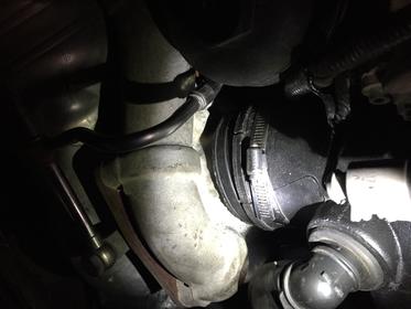

We put a new engine in my blue turd then the fuel stsyem commited suicicide. So i went big and studded the engine and put a full intake and exhaust and a 7000$ new fuel system. With a modest 125 hp tune it nearly pegs the manometer. And also it seems like the intake doesn't seem to fit properly its like the boot slups off its adapter. Im not to concered about this if i wasnt pulling such restrictions ,does anyone else peg there guage like me and on a modest tune abd with such a restriction any intake leak would be found. So thats what im kinda worried about ive read about afe tubing not being correct. Read they were working on itbut could not get any answers from the forums. And has any ine ever put there air duct and seen a noticeable difference ive got 29,000$ tied up in a 25,000$ truck i can't afford a new engine. Im going to give them a call tomorrow and ask them about it

The AFEs do not move enough air for these trucks. I stuffed in an insanely long filter into my AFE setup until I decide exactly what I want to do turbocharger wise. My part number is 75-11262 for the AFE kit.
Dropped EGTs and quit sucking in the filter minder.
BTW, the kit from 'No Limit Performance' moves way more air. http://nolimitfabrication.com/index.php?route=product/product&product_id=57

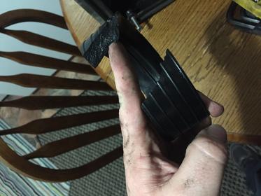

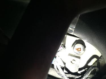

Tried to make it fit better broke a sensor, can any ine tell me what it is? Broke the coupler, and fits like garbage. I hope they will send me one that fits at least

I can't tell what that is on my phone, but if you broke a sensor putting the elbow in, it will be the map or intake temp sensor. They both sit right under the elbow. Ps the no limit will solve your life problems.

I did the same thing to my afe, ripped the rubber coupler deal. Wish I would have been a member here when I purchased the crap afe setup. I had not heard of no limit before becoming a member here.
