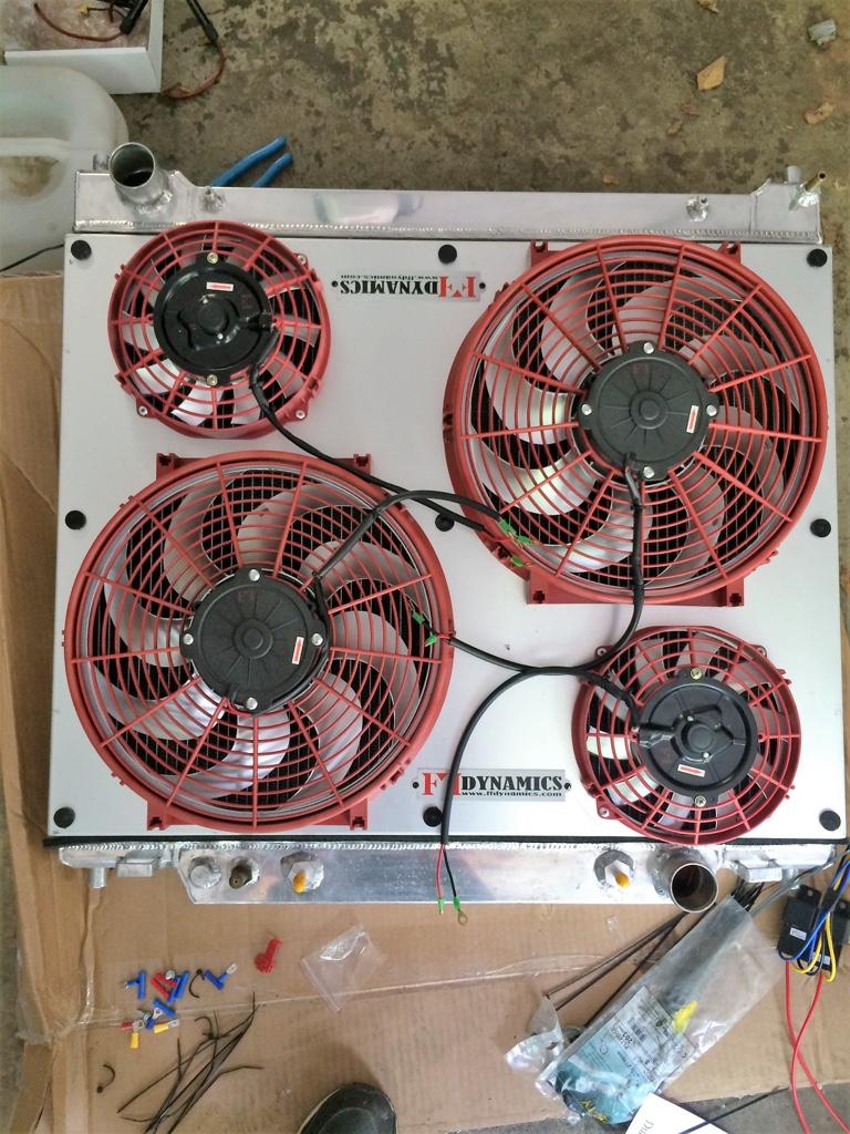

I have the same problem. If i bump the idle to 1200 sitting still it seems to work correctly.
Otherwise once we get moving even just a little the air is ICE cold.
Have looked for other options as well. The SD pully might be a good solution.
There just isn't room to put the condenser out front on an OBS.
Would love to put a electric fan but there is no room.
Maybe something like this would work for you.
Freed up tons of room out front
