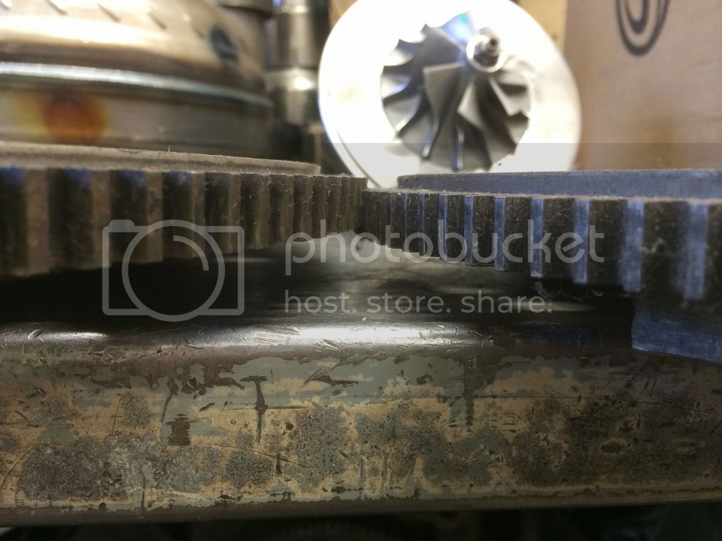

this is a 6.0 and a 6.4 flex plate sting flat on the bench

Sold my trans...its in another 6.4...with my original 6.0 flex plate and converter...still no issues ...FWIW

I ran a 6.0 converter / FP combo on mine and there was a noticeable vibration at idle. Ended up pulling it out and putting the 6.4 stuff back in. But the 6.0 stall did seem to work better for the single from what I noticed.
