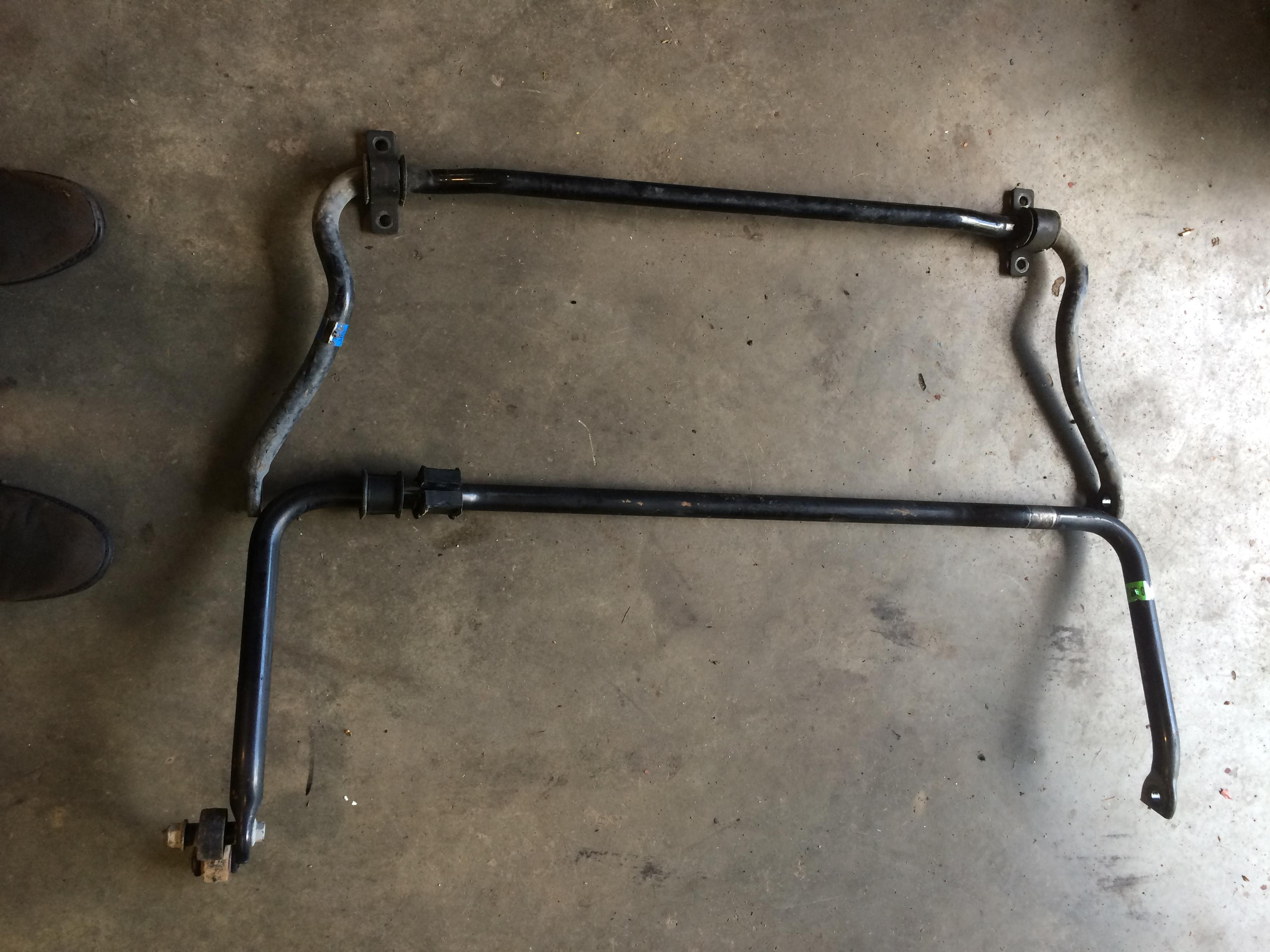

I don't know how big the Hellwig bars are, but I put one on mine of a 08 F-550. It took care of the body roll after my 4link.
If he does any type of boosted launches or sled pulling he is going to want a 4link. IMO.
I also put on a 06 F-350 rear sway bar, because they are about 10x bigger then a stock 08, and stay above the rear. I've got the same traction bars and it was all a bolt in deal. Plus, I couldn't beat the price..in comparison to Hellwigs. :thumbsup:

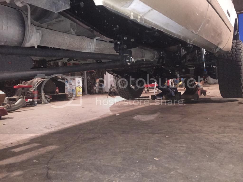

Here is pic of the difference between the 08 250 and 550 front bar.
Gearhead
May 19, 2011
2,152

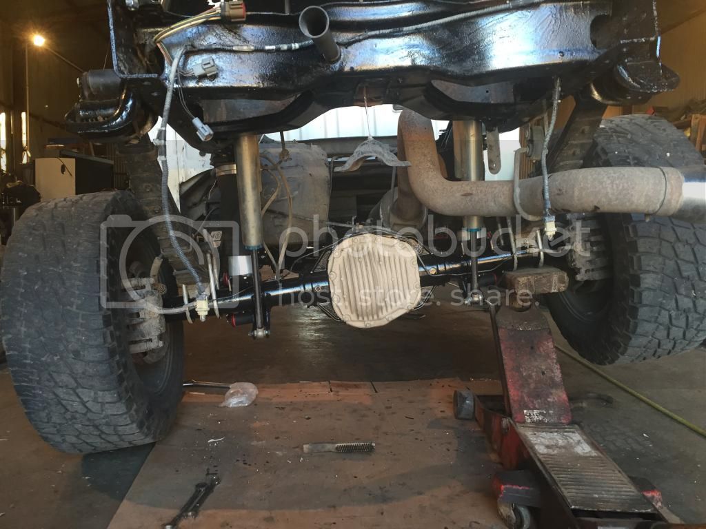

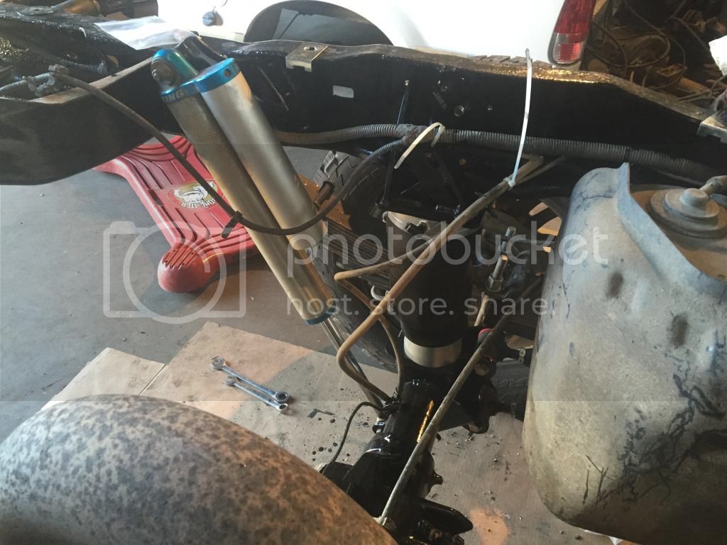

Looks like it has some travel! What's with the rear axle being so far forward?
The Deaver springs move the rear axle in an arc. Under droop, the rear axle moves forward to keep the driveshaft happy. I thought it looked kind of odd too, but it is only slightly forward at ride height compared to stock.
