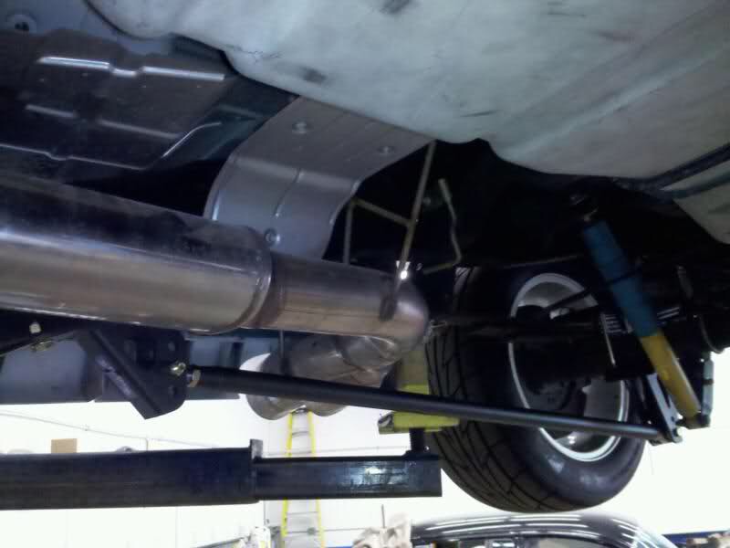

Have you installed these on a Lightning? The exhaust can be a challenge on those trucks since it exits right about where the forward mount for the arm belongs.

As long as the exhaust isnt under the frame it really shouldnt be an issue. You'd just have to give me a few pictures
It does exactly that. Hugs the inside of the frame rail past the door and then it promptly exits stage right, just behind the cab.
Not my truck, but this picture explains it.
