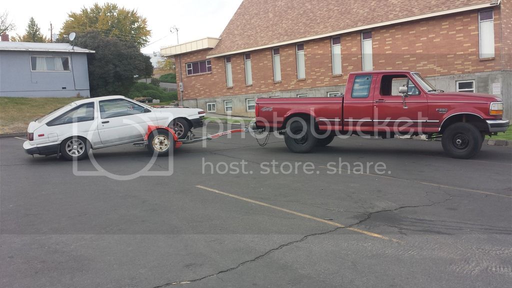

So, I live in Wisconsin, aka the Rust Belt, and bought a car in Portland OR to revive my race car.
Needing a new-to-me tow vehicle anyways, I scanned Craigslist, and started making calls/texts/emails. I originally wanted a 2wd, and found a perfectly maintaned '95/7.3/Auto fleet vehicle, but whoever answered the phone was kind of a dick and wouldn't spend 10 minutes on a Saturday morning to sell me his vehicle. The second choice was a '98 Ram 2500 / cummins/manual/2wd, but he was out of town for the weekend, so it came down to door number three: a '96 F250, Extended Cab, 4x4, 7.3, 5-speed. I guess I could live with a 4x4. Called the guy, and he even picked me up at the airport in the truck so I didn't even have to get a cab to get to his house.
So, after a 2000+ mile drive, and some excitement with passenger steer-tire issues (first one separated in Utah at the end of day one, leaving a huge bulge in the tire, and then the spare exploded in Des Moines rush hour the morning of day 3), I figure I'd register here and start learning what I need to do with this truck to keep it solid and prevent any future calamity.
The previous owner seemed nice, but rather lacking in mechanical knowledge, so who knows what he did or did not service or paid to have serviced.
I'm pretty sure I need rear shoes, with an e-brake adjustment at minimum. when it was going on the flatbed after the blowout, some fluid was leaking from the right-hand frame rail. not strong smelling, and not tasting of anything much either, so I'm hoping just dripping from a water separator or something?
I'll be putting new tires on all around, (235-85-16 10-ply Toyos) so that will get the speedo correct again, although make it look like I'm running on pizza cutters. once that's done, I'll determine if the slight shake/vibration is from unbalanced tires, or if there's a u-joint starting to go bad.
Gonna do an oil/filter/fluids change all around, probably including diffs, transmission and xfer case, I'll be able to check the drained fluid and make sure everything's good.
