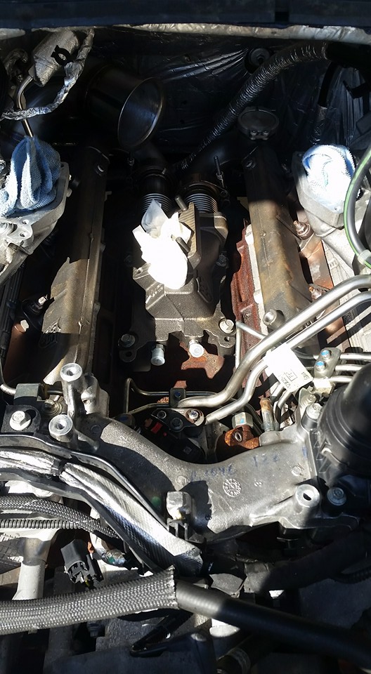

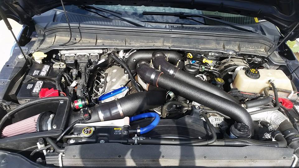

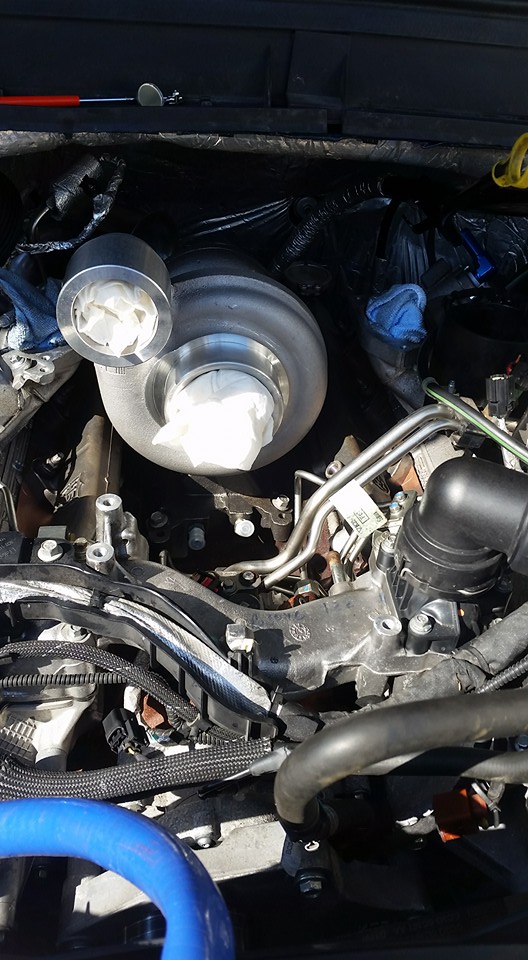

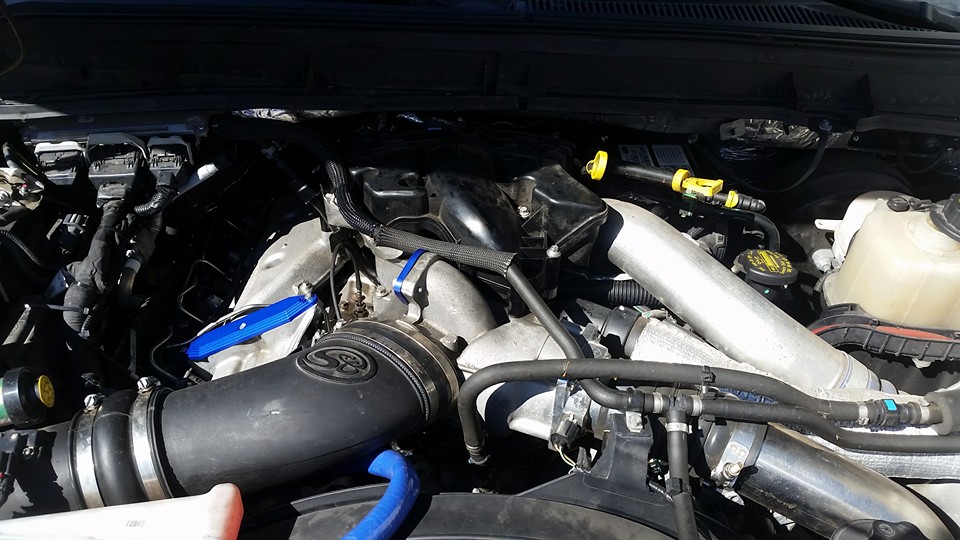

This weekend I finished up my H&S Turbo kit and H&S CCV kit install. I started Wednesday afternoon and removed all the stock parts.
Thursday afternoon I installed the new exhaust manifolds, the turbo pedestal and the CCV Kit.
Friday afternoon I installed the turbo and all piping.
Saturday morning I changed the engine oil and filter so she would have fresh oil flowing through her and added the coolant back in.
Right now I am running the H&S tune off their website.
No leaks and no problems at all so far.

Attached are a few pictures.

I really like the finish on the piping. Looks factory and the piping just flows nicely in there.
