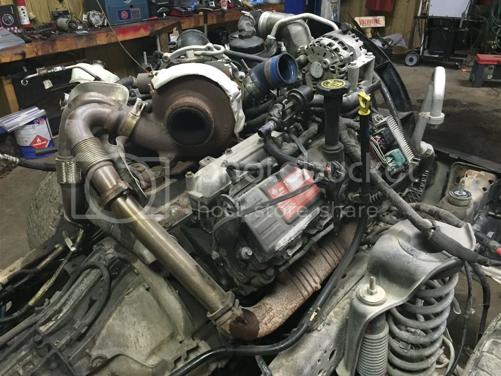

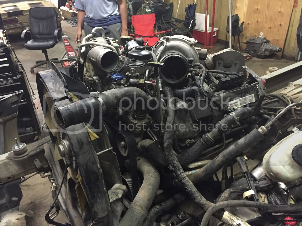

Cab off. Going to start tearing into it tomorrow night.

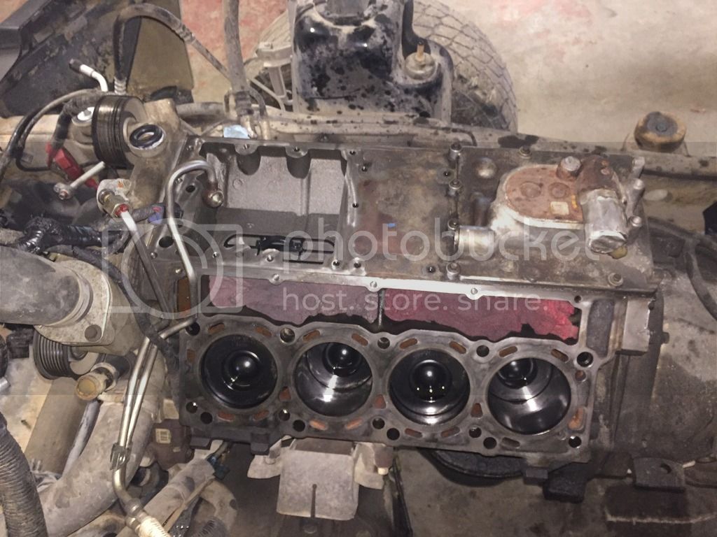

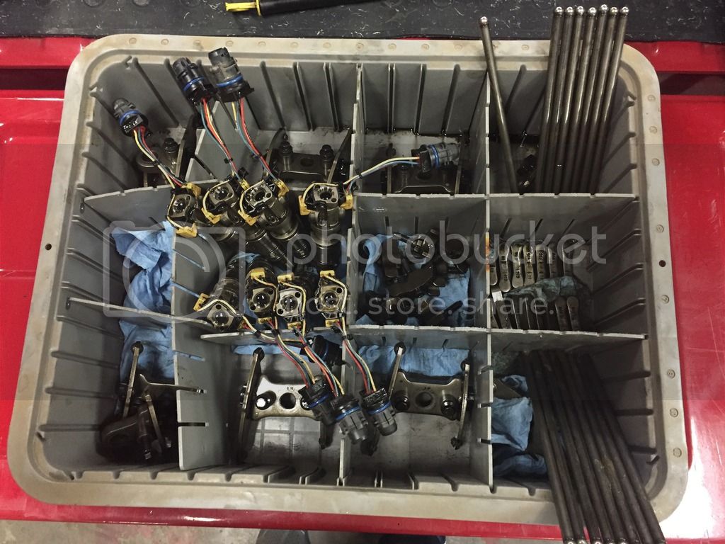

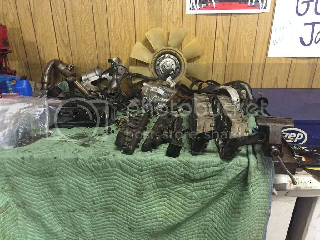

It's all apart. Heads off to machine shop tomorrow. It's all cleaned up and ready for reassembly. Going to do new oem injectors,oem oil cooler,oem head gaskets,all oem seals and gaskets,stc update,arp's,clean turbo,dummy plugs. Any other tips or tricks would be appreciated.

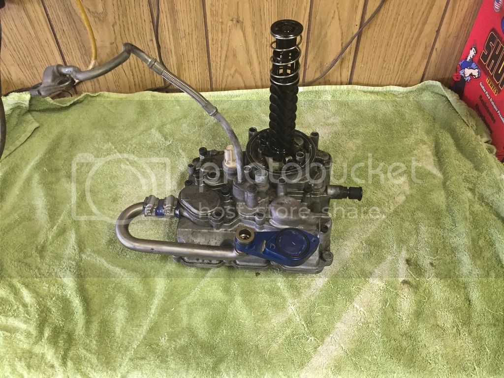

Oil cooler ready to be disassembled for new oil cooler and resealed.
