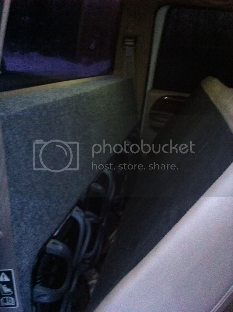

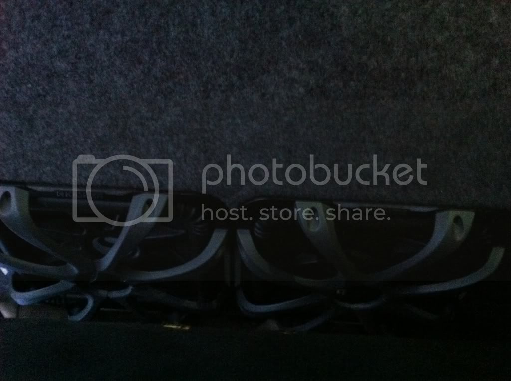

I dont have any real good pictures but here they are.
The back seats moved forward about 3 or 4" I cant remember for sure. The box is huge though. I had 4 L5 10's in the truck before and the box was a lot smaller. And now I have a zx2500.1 powering them

very cool
I can't move my seat forward that much my kids are to big lol
thanks for the pics
AKHILF
Jul 6, 2011
709
Eagle River Alaska
My friend thats 6'2 sits back there his knees touch the seat only a little. Let me put it this way, theres still more leg room that a quad cab cummins
