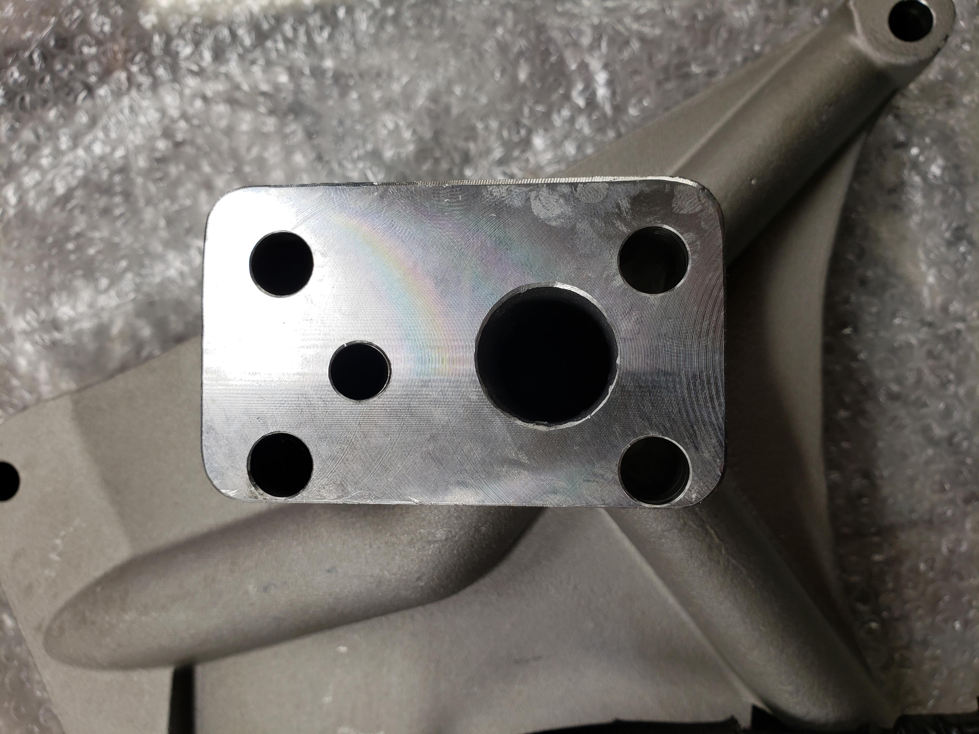

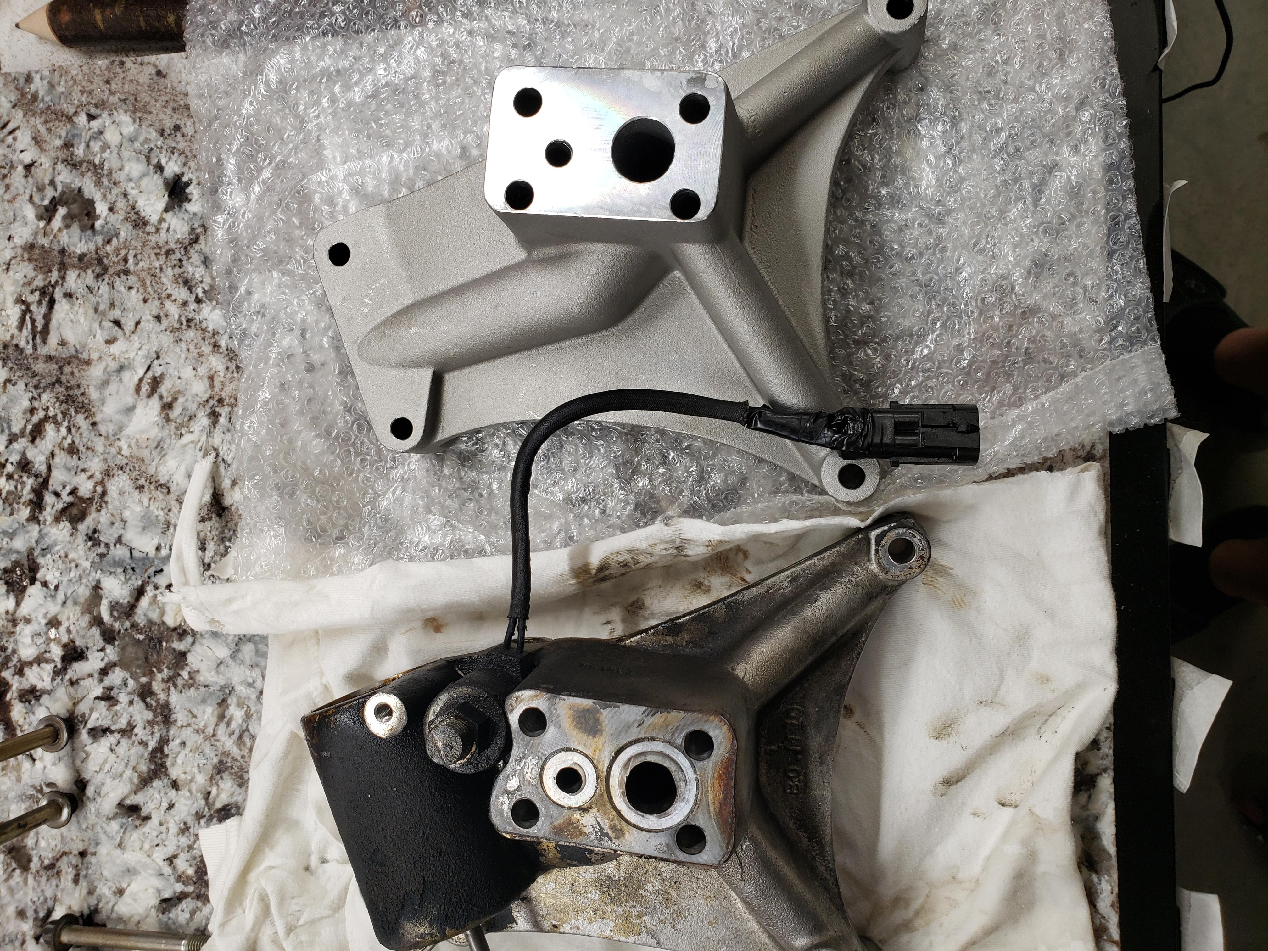

Hi guys, I ordered the ebpv ****** pedestal from a place a few months ago and just got around to doing the job. I got the turbo pulled last night and just went to swap the pedestal this morning, and upon unboxing the new pedestal I noticed that 2 of the 4 mounting holes for the bolts that mount the turbo to the pedestal are WAY off to one side. I'm worried that if I install this thing, the pedestal is going to crack and break when I start driving. Am I worried about nothing? Do you think this pedestal is safe to use? Or is this pedestal defective and I need to send it back and get a replacement?

It probably will be fine, but DANG those holes are close to the side. Those bolts aren't under alot of torque, nor is the pedestal.

Oh good grief you're right! I didn't even notice that. I went and looked at some others online and they're all flat like mine is too.

I'm more worried about the vibrations from the engine and bumps in the road and stuff though. Do you think that's cause for concern or am I overthinking this?

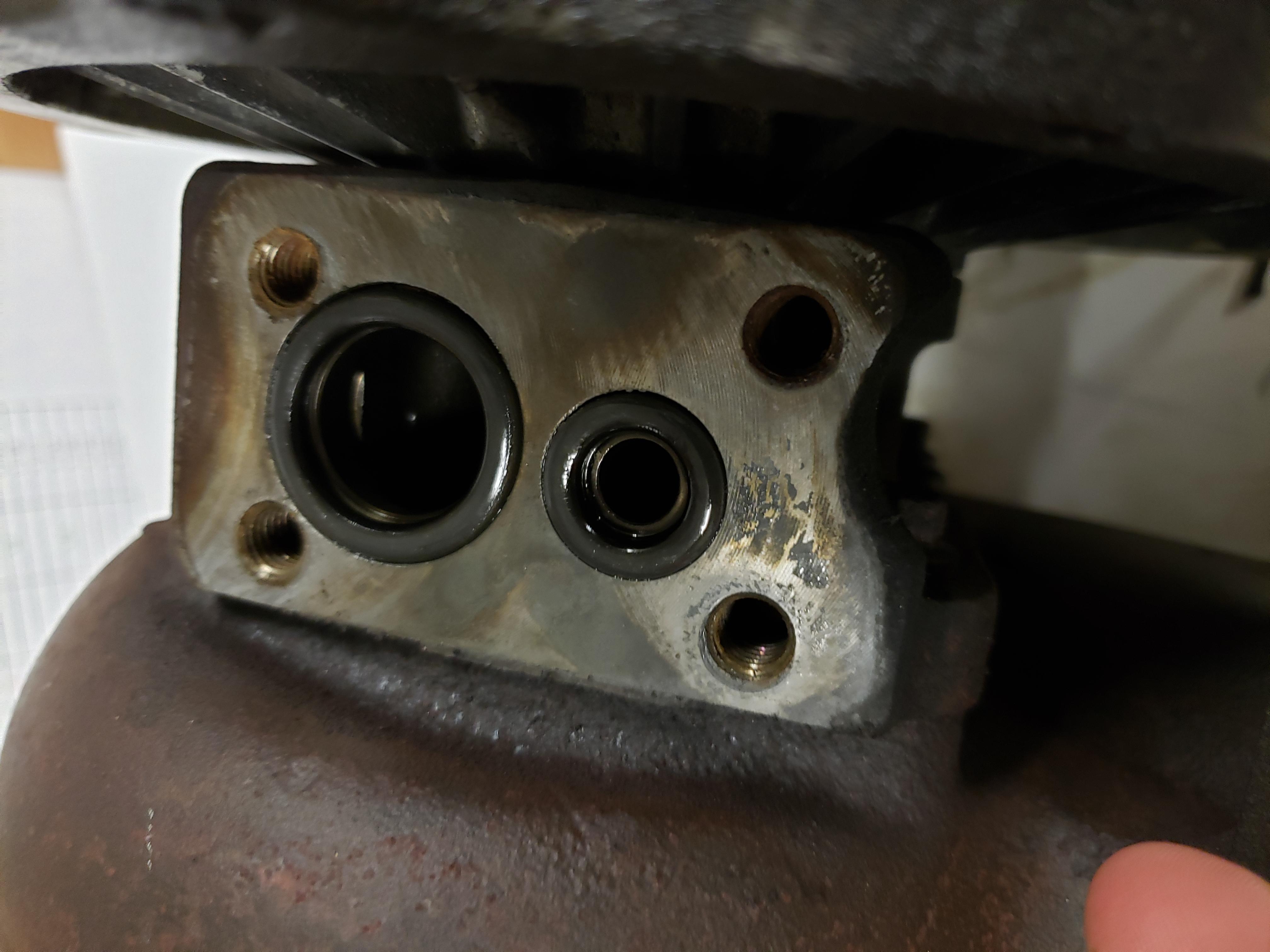

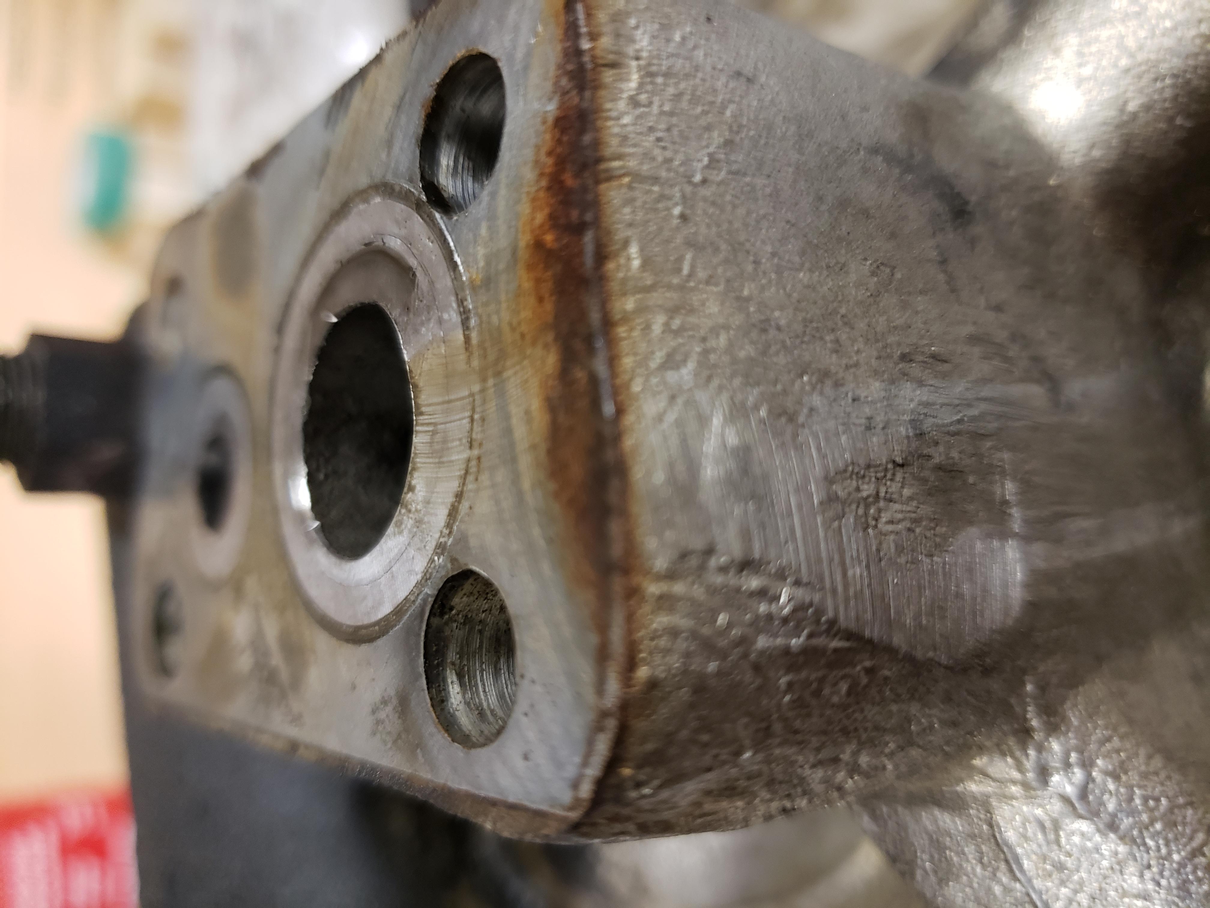

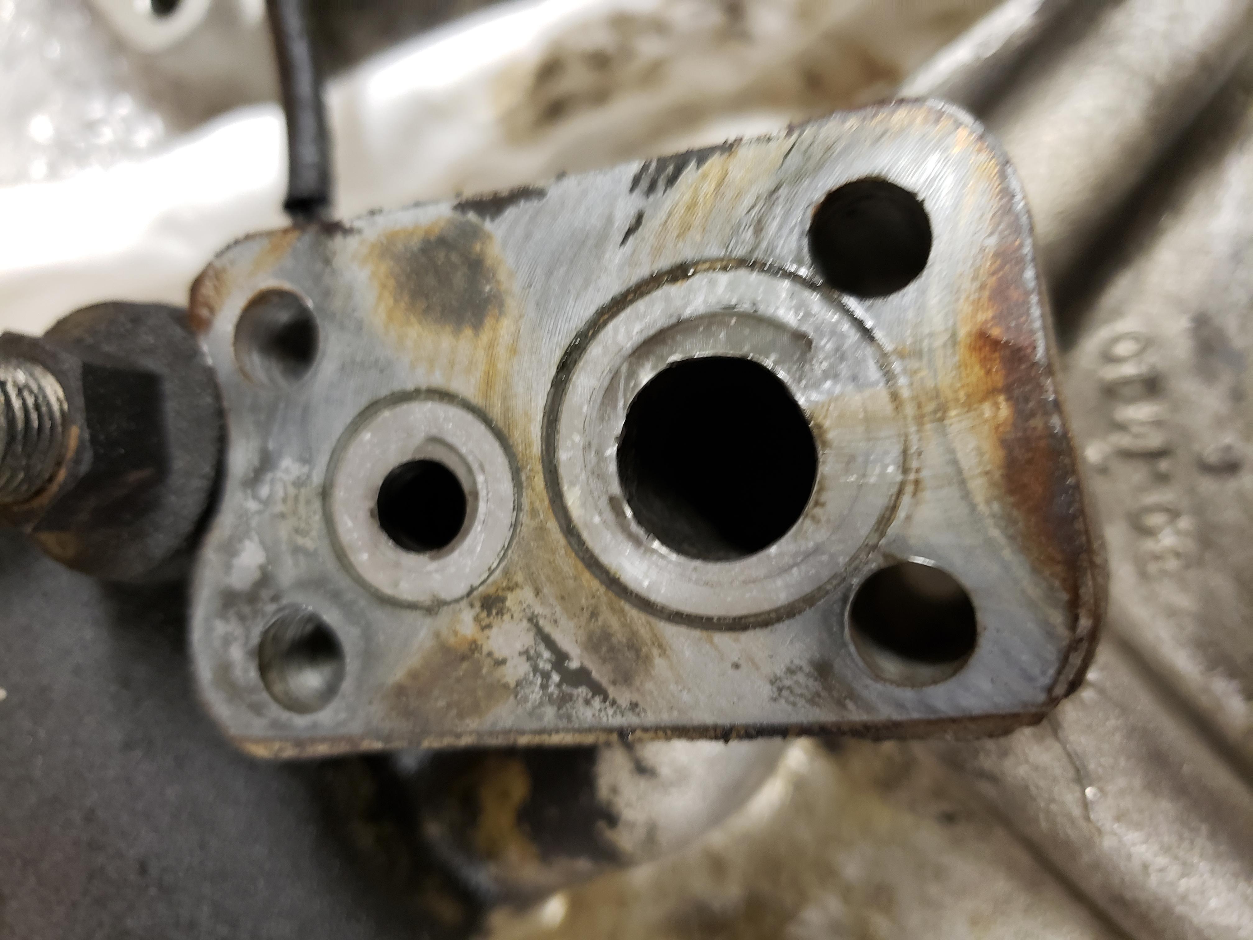

Relief cuts for o rings
Ok so I took a closer look at the old pedestal as well as the underside of the turbo when I got home. The relief cuts for the O rings ARE in fact on the turbo side, NOT the pedestal side. *whew*. The ring you see in the earlier pics of the old pedestal is actually just the clean steel where the O ring touched, and then where the grime starts beyond that. I felt it and it is actually all flush. Just an optical illusion. In the pictures I'm including here yoi u can a little better what I'm talking about. 2 angles of the pedestal, and one of the underside of the turbo with the O rings still in the relief cuts.
