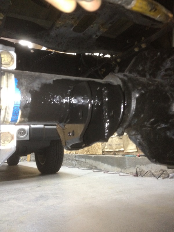

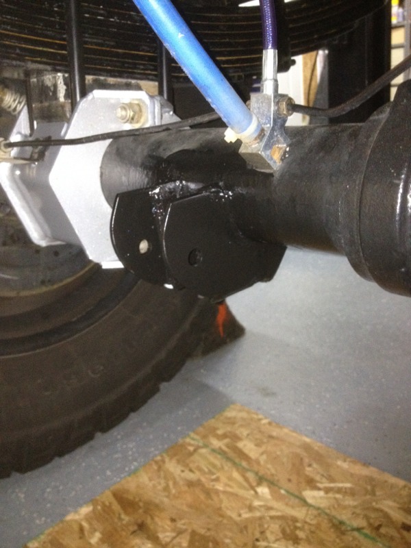

Got my rear shock mounts cut off and painted last night. One more task completed in the list of many.

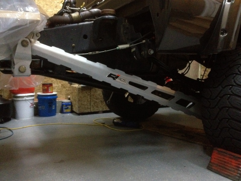

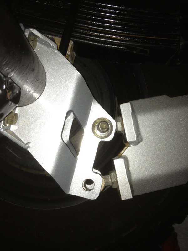

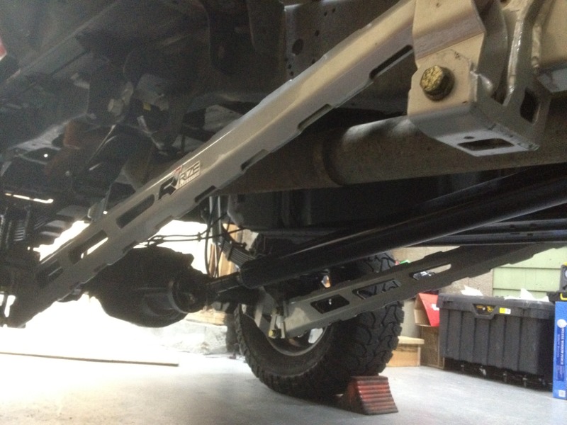

I also got my Rize bars mocked up. I'm havin an issue with the lower heim joint on the drivers side. I can't get it to line up and I think it is due to the angle between the axle mount and the bar. I have not done the passenger side yet and can't say for sure if this is an overall problem or it's isolated to one side.
At this time the top heim is all the way in and the bottom has about three threads exposed on the inside of the bar. It appears that the only way to get the geometry right is to lower the front of the bar.
Is there a limitation to the amount of lift the Rize bars can accommodate?

Tragedy averted. Figured out the minor alignment issue with the traction bars.

Danbonzo
Jul 10, 2011
420
Redding,CT
How much stress did you feel on traction bar when you leveraged it up into posistion after anchoring the bottom heim in place?
