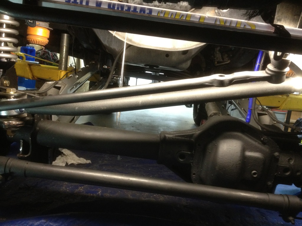

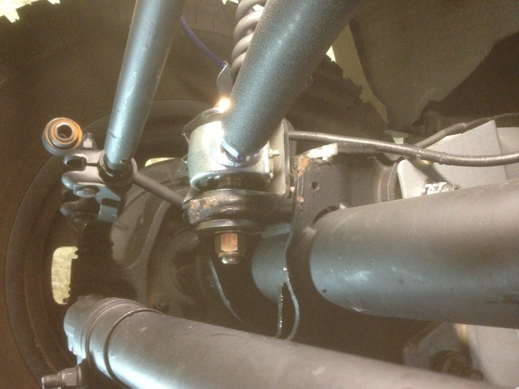

As anticipated the track bar is much happier above the axle. In regards to matching the steering arm, the road test will be the true test.

Looks much better on top. Perfect world. The track bar should be the same lenght and angle of the drag link. For zero bump steer at least. BTW. Thats a big ass truck :D

Thanks bud. As it is now the drag link is 13 deg and the track bar is 13.25 deg. I might have to drop the front end about a half inch because I might be a tad higher than the rear. I can't tell inside the garage.
If I put a level on the bed rail and compare that to the floor the back is higher. But anyone who has done any carpentry knows, what is level......doesn't always look level.

Correct, depends on what one is "sighting" against. Congrats on finally getting your front end zipped up. Now you just need a trans, Intercooler, NOS,..... Lol

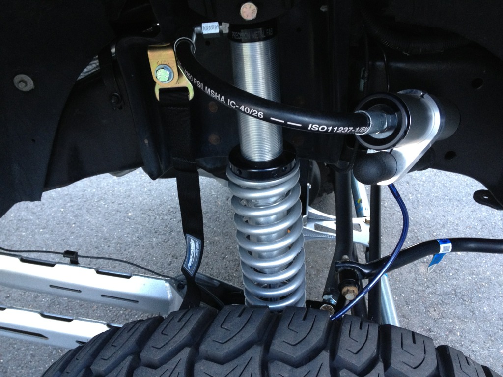

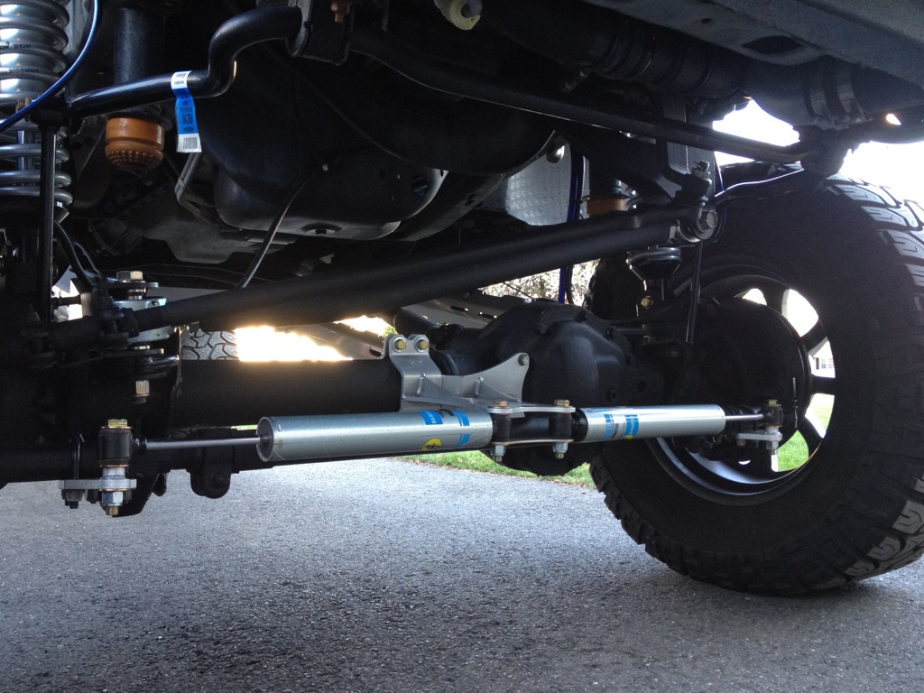

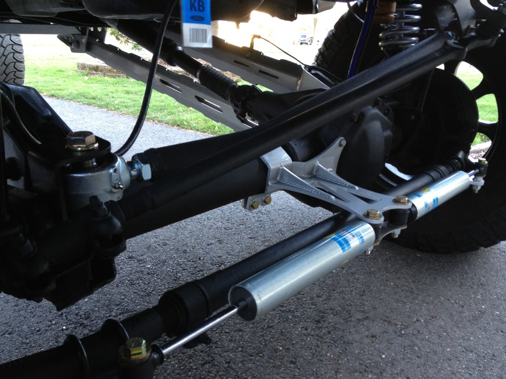

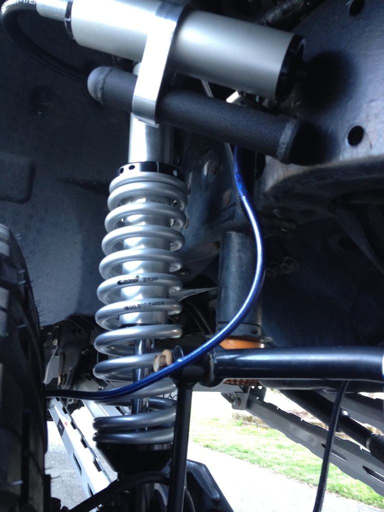

Well, it's finally off the lift and rolling. After assembling, adjusting, reassembling, grinding, disassembling, painting, then final assembling the product is worth the work. My limit straps and shock conversion brackets showed up. I still have to make sure I have enough slack to allow enough drop. I currently have about 2.5 in beyond where the truck sits weighted. I have some brackets to add two more inches should I need it.
I still have to test drive and check for anything I screwed up but I can't till my exhaust gets back from HPC coating. Once all the springs settle in I will readjust the coil-overs for proper rake. I'm sure there will be some castor adjustments to make as well.
I also still have to see what my front drive shaft angles are. Preliminary movements show that It spins freely with no binding and clears the cross member. Only the angle gauge and calculator will tell for sure.
