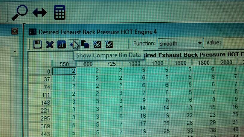

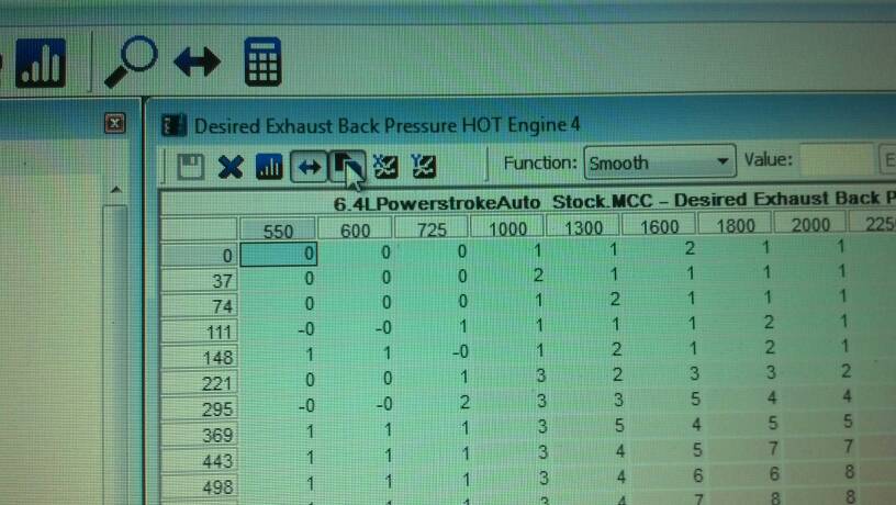

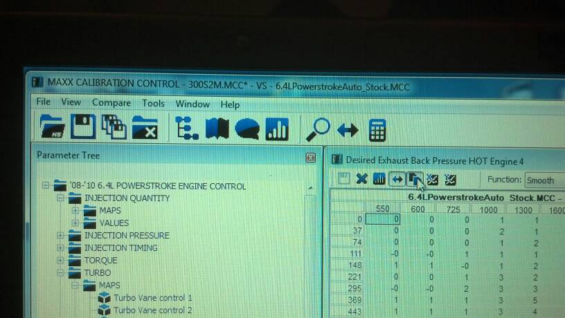

Go to the upper menu to the compare icon. Select load tune. Browse the tune file and then check the box you have selected.
Next select the compare bin data icon in the sub menu. This shows the factory graph.
From there you can select the compare difference icon. This will show you the plus or minus difference between the two.

If you have done it correctly it will show it in the top bar.

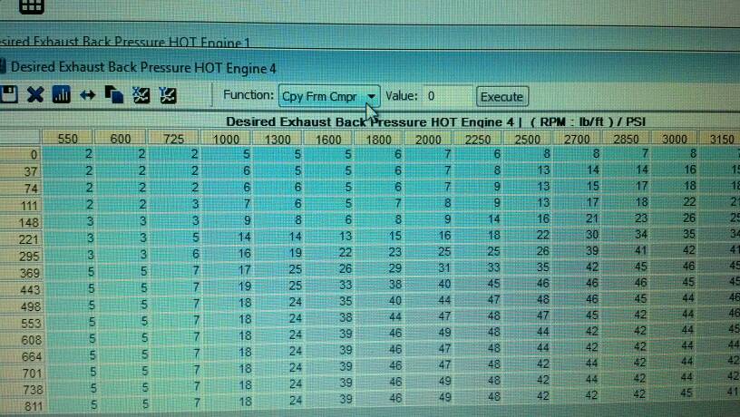

From your compared tune you can change your function to cpy frm cmpr. Value 0 to keep it the same. Highlight the entire graph or what you what to change and hit execute. This will pull the graph from your compared tune and transfer it to the tune you are building.
