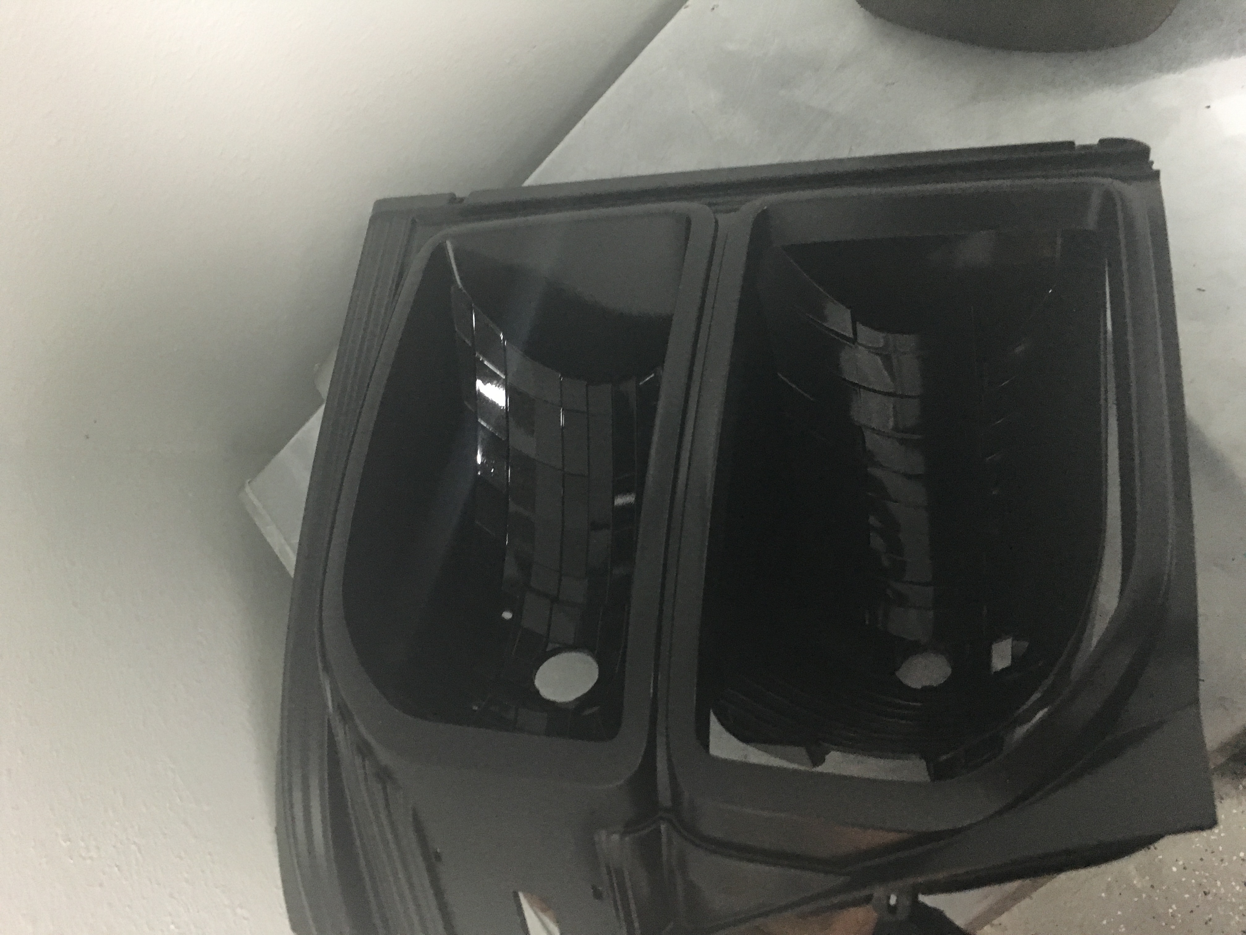

just finished up my retrofit on my truck check it out ! i need to adjust the beams just slightly and prolly order 55w hids i used my old system and not as bright as i want ! i just esed the mini h1 with dummies up top with apollo 2.0 shrouds and halo just white
how i mounted the dummies
just grinded the stock socket to fit the mounting washer
how i glued the halo on (not my pic but i did it the same way )
black metallic paint

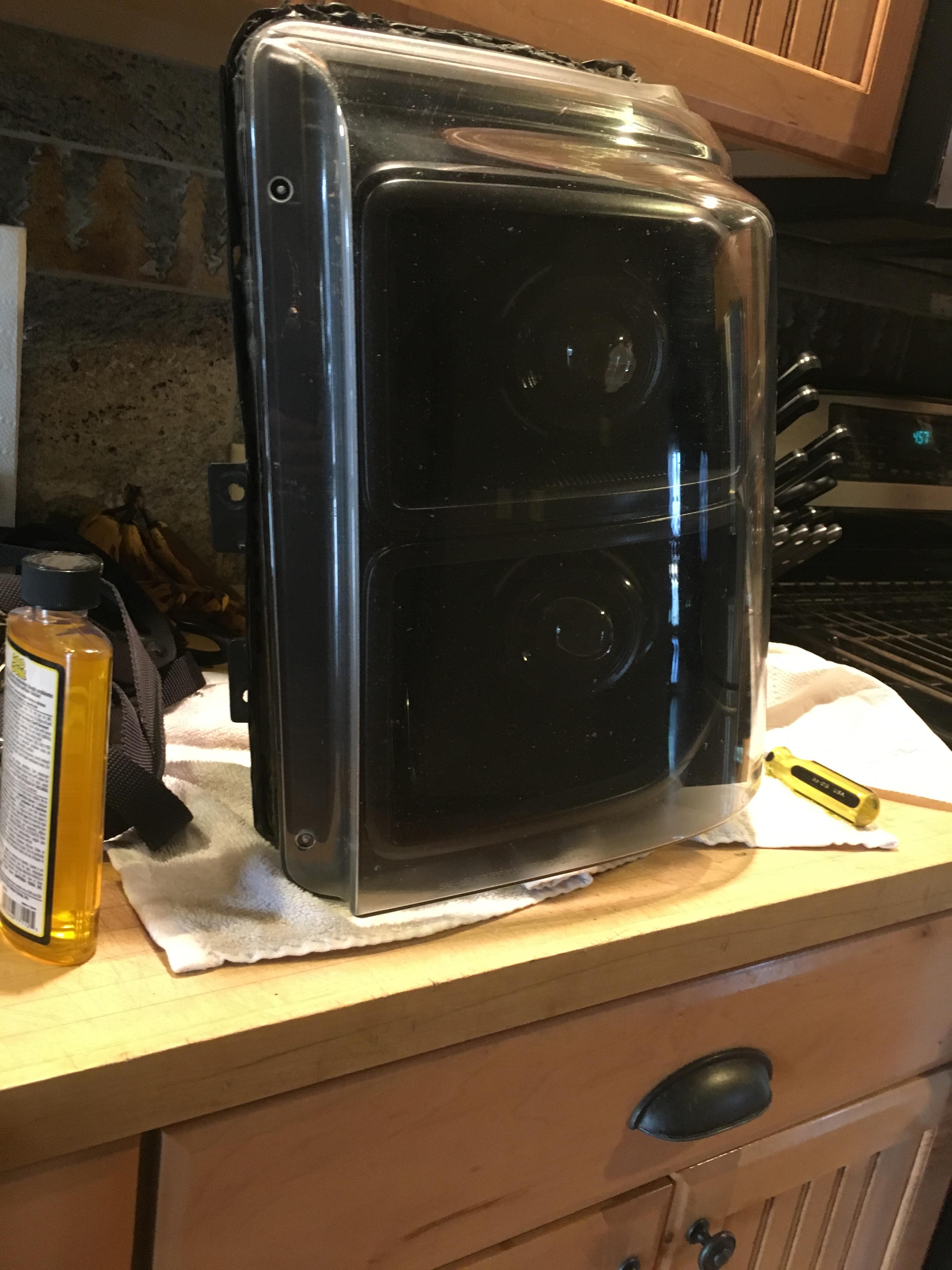

starting to look good
im happy with the results definitly makes a huge difference
have about 8 hours or so into it and like 250 bucks
