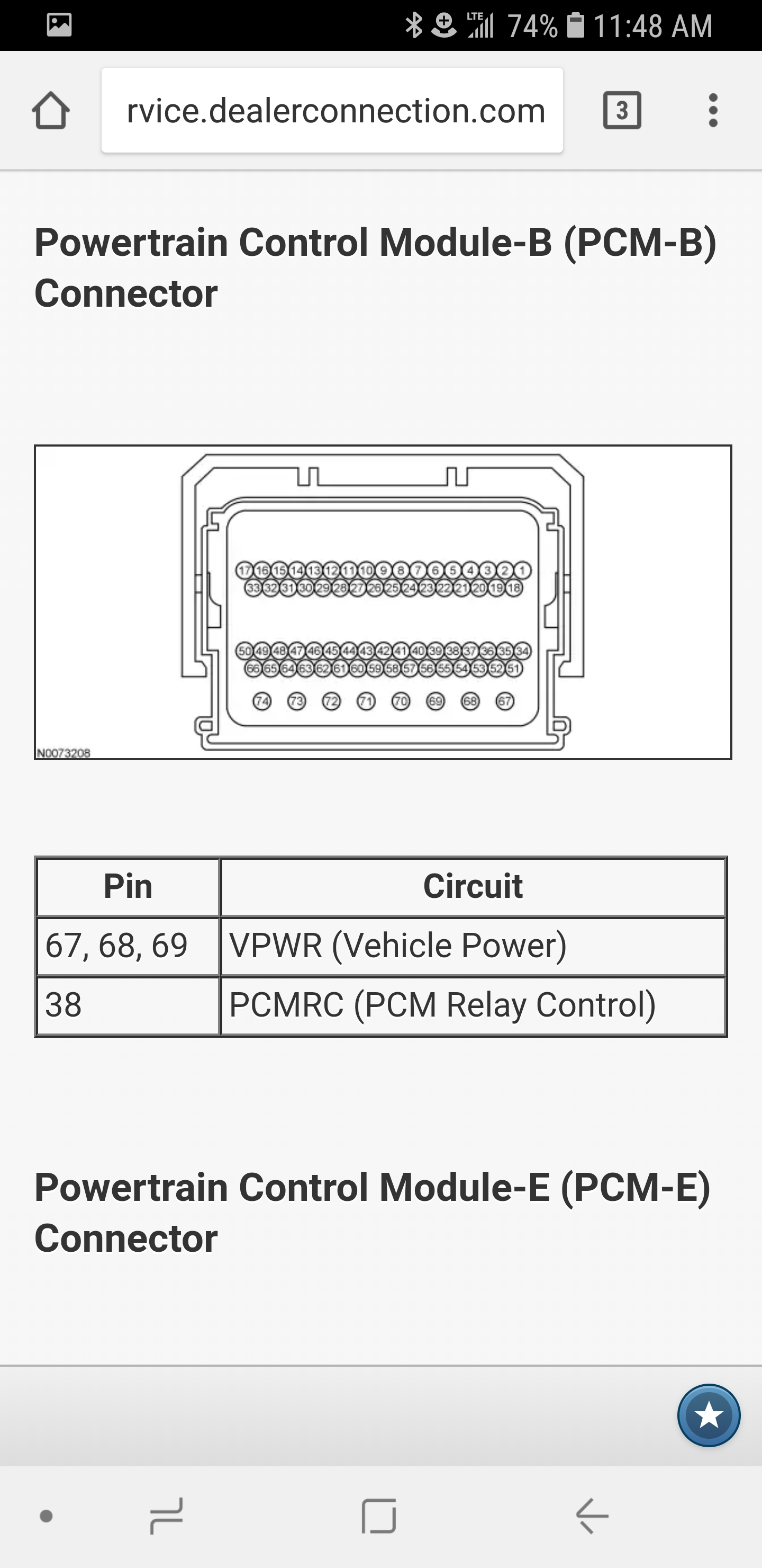

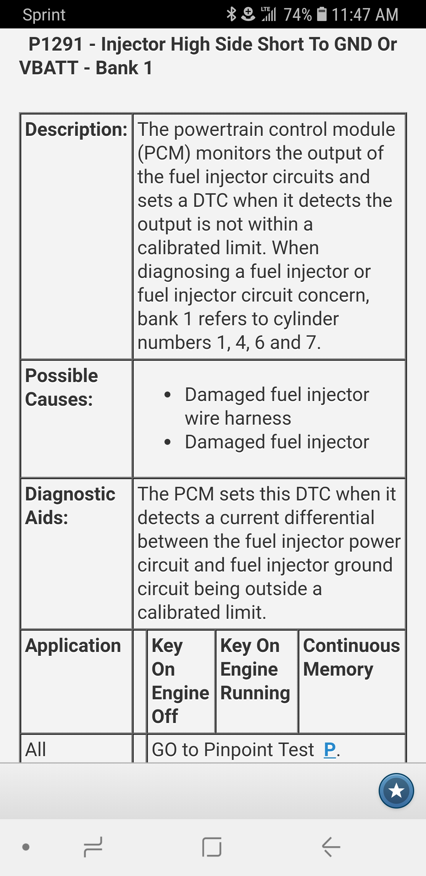

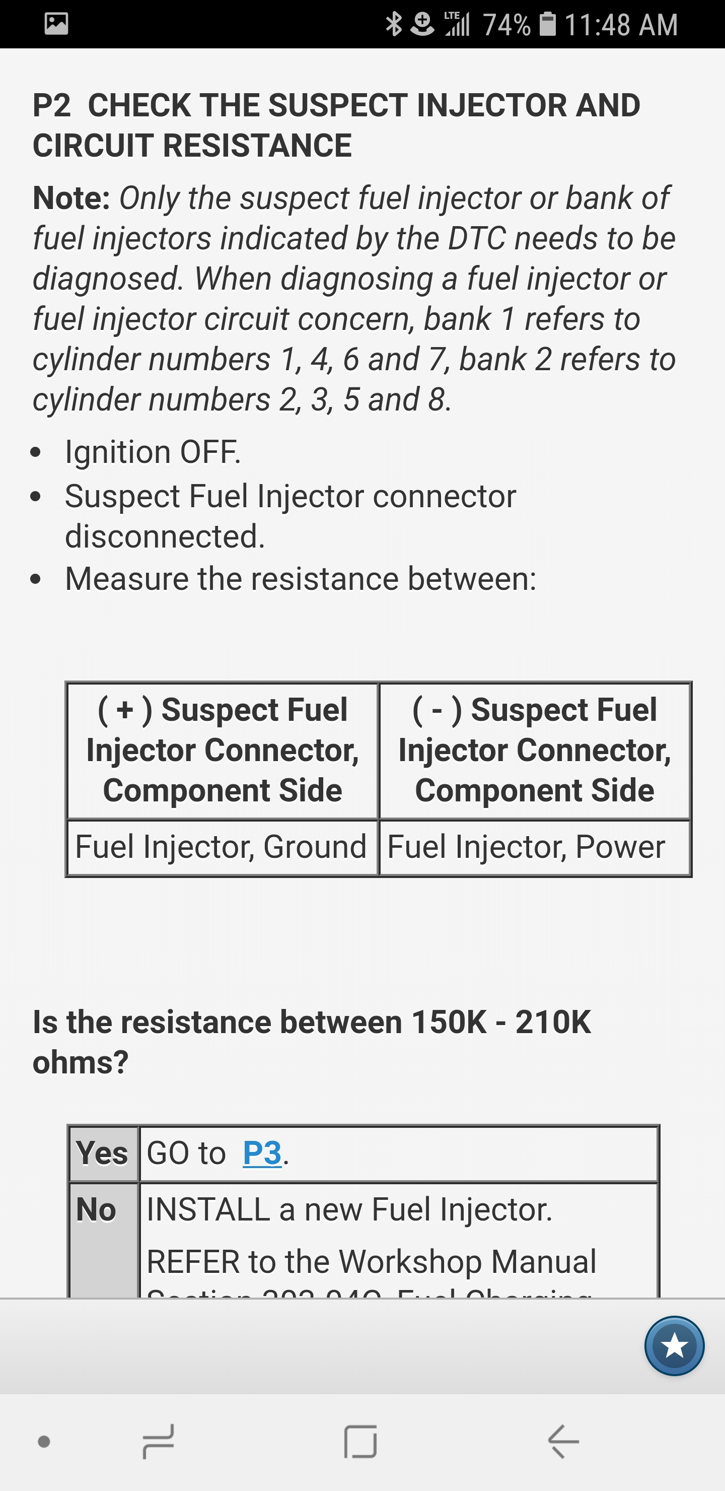

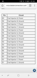

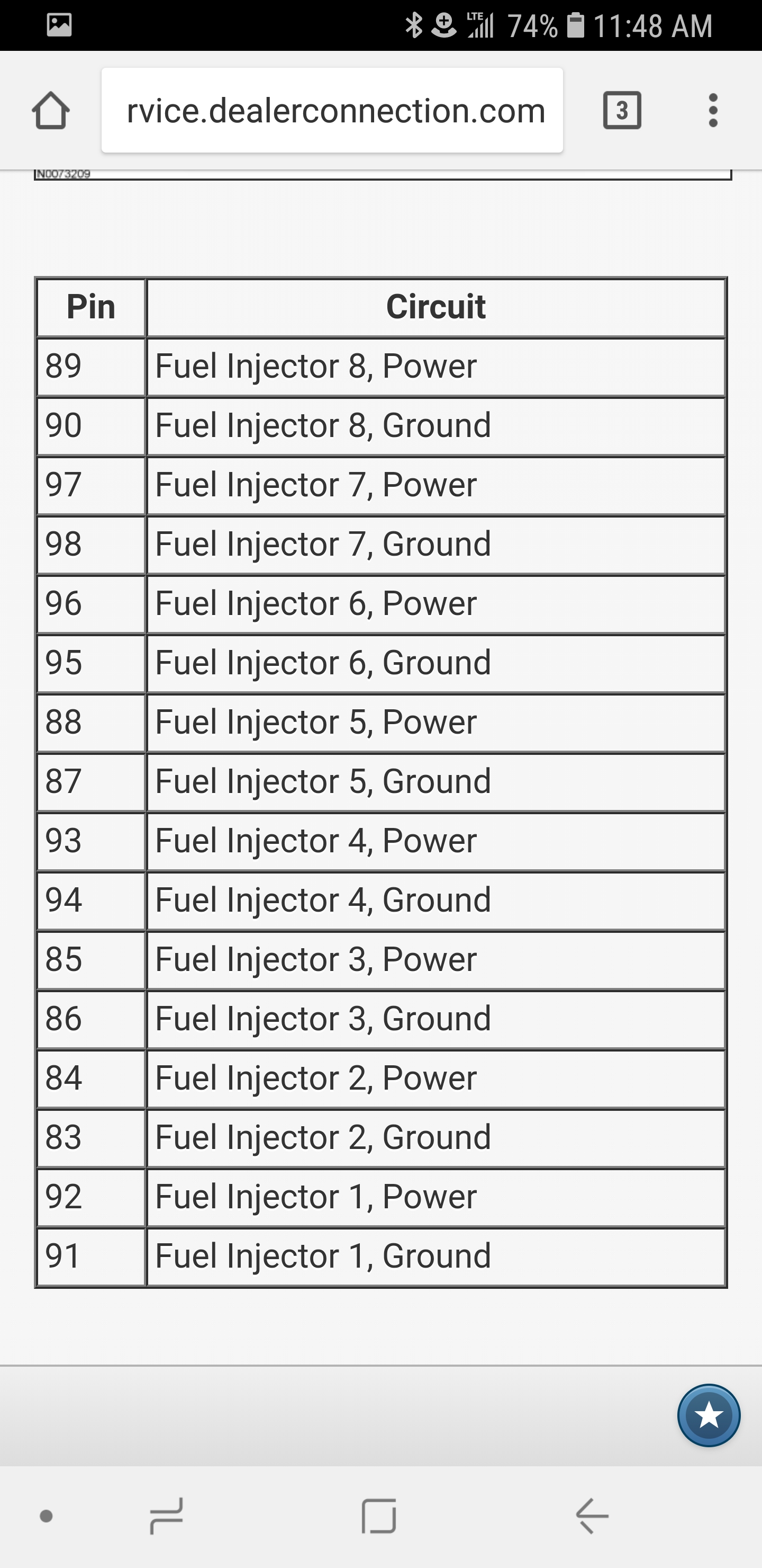

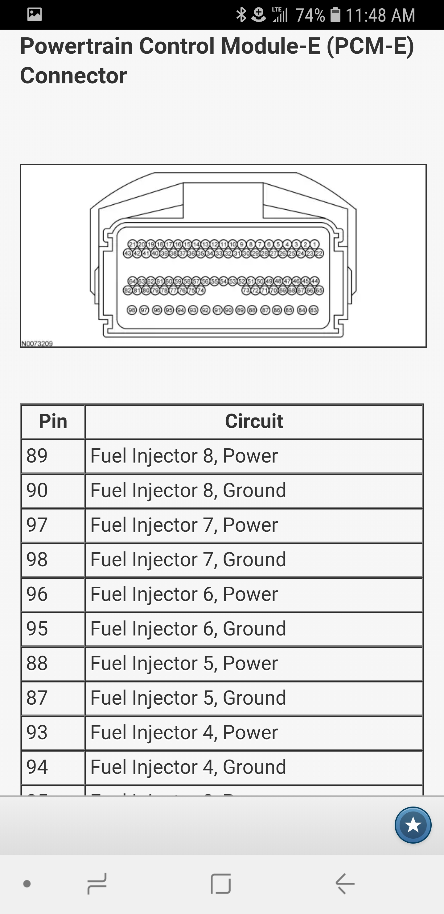

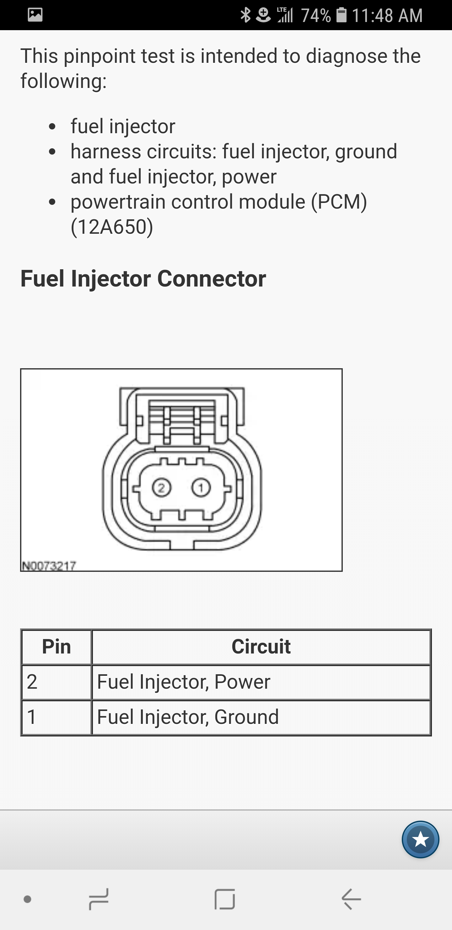

Here. Simple enough

So I brought the truck into the dealer and they pulled the code. Did a system check and everything passed. Couldn’t do anything as I expected. Brought it back with it running like trash and they diagnosed it. Passenger front right injector missing, center two on drivers side missing and back injector on passenger side missing as well. Ford replaced all 8 injectors and truck has been fine since. Thank god I went for the extended warranty!

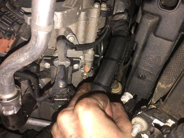

So brought the truck to dealer today, currently they have no diesel tech. And what the head tech found out was that the wiring harness was rubbing on the egr cooler, something ford suggested to look into, don’t know why they didn’t when they did injectors. I have yet to drive it much to see if this fixed the issue but he said a wire was rubbed through. I hope this fixed my issue. If not, back to dealer, if it did, I got all 8 injectors replaced either way under warranty! I’ll include some pictures. Can see where the harness was rubbing against the cooler and I believe the harness runs to the injectors just from the little time I took from checking it out.
I hope this helps anyone else with bumps and running like trash. Once the warranty is out, egr cooler is going in the trash!!
