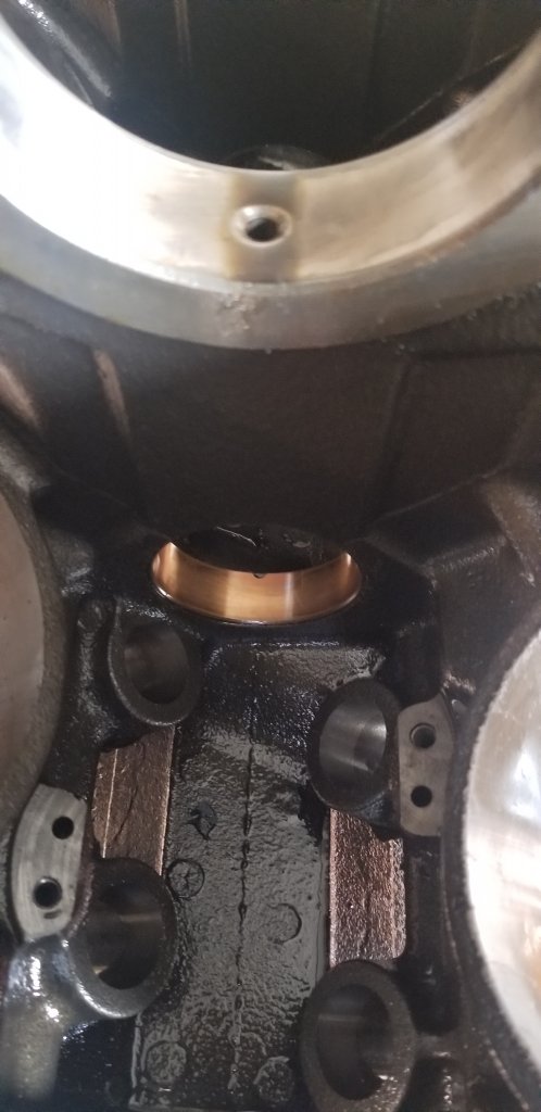

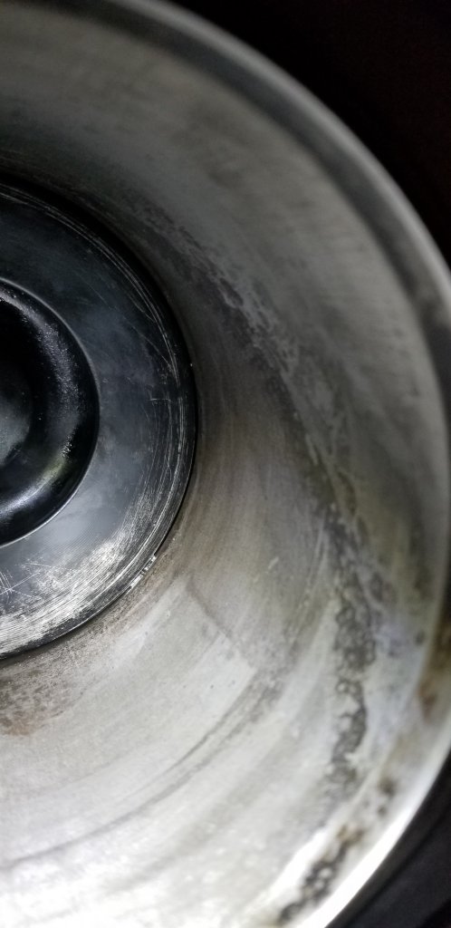

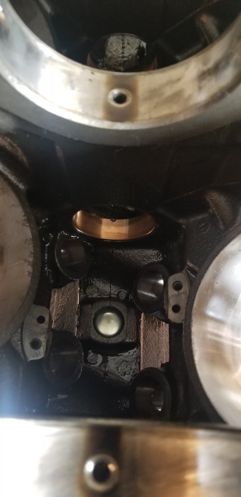

So i cleaned up the cylinders and found this...
What do i do? i see you can get sleeves. im guessing you need special tooling to replace a sleeve.

Can you feel that with a fingernail or a pocket screwdriver, pick, anything like that? May it just possibly be staining?

Why were we cleaning cylinders? And with what? Looks like heavy scoring on piston
I never ever clean cylinders or pistons.

Yes you can feel it. Wd and microfiber rag. I dont think i have a machine shop up here that can bore it. Im going the get the pistons out and see if there's any others.

In order to use a sleeve will need to have a machine shop to machine the bore and install the sleeve.
Was the engine starting and running fine?
Yes the motor was running ok. But im not doing this just to put it back together with a score cylinder. I have to find a shop that can do it... i don't think the the shop i brought the heads to can bore the block. Ill have to find out tomorrow.

You are now looking at a rebuild? If so, you should be able to just bore it out bigger and go with a oversized ppistons No need for sleeves, unless they cant clean it up with a bore job. Then you would be better off getting another block. But, that is just my opinion.
I did a tractor not long ago that had a bore like that, the guy did not want to change the sleeves (a sleeved block) so I honed it and put new rings in it. It's been running great for him. I do not recommend it though. It was not my choice but his.

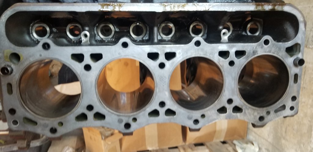

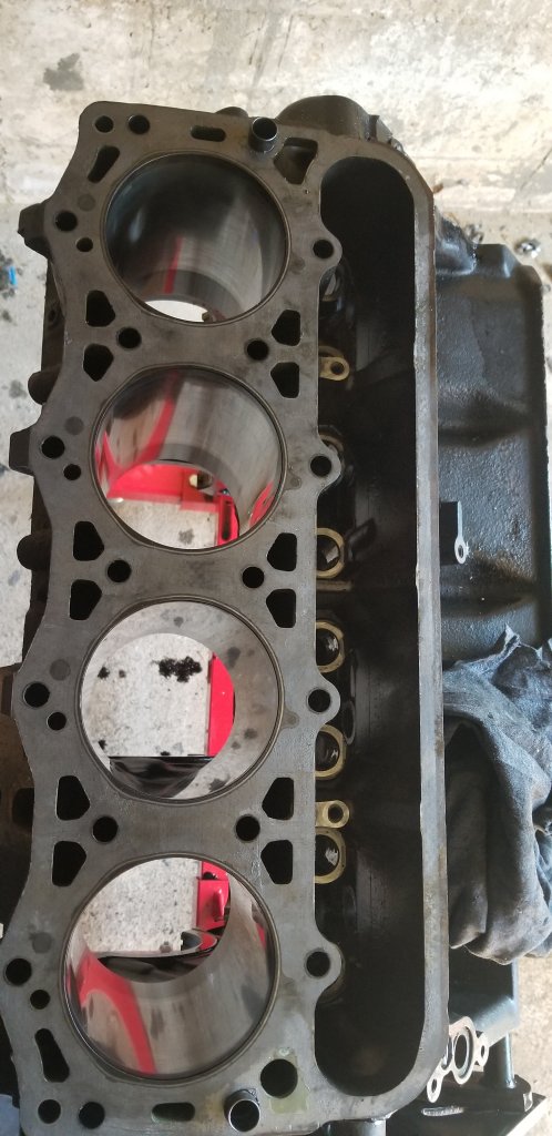

I got it on the stand today and pulled the pistons. One other has some slight pitting. But the other 6 look great.
I have to tear this down completely to get it bored, correct? Front cover,cam,crank etc.?

So she's empty. I thank everyone for their input and im sure i will be coming back for help on the rebuild.
The shop that has my heads can bore it. It was just a misunderstanding.
