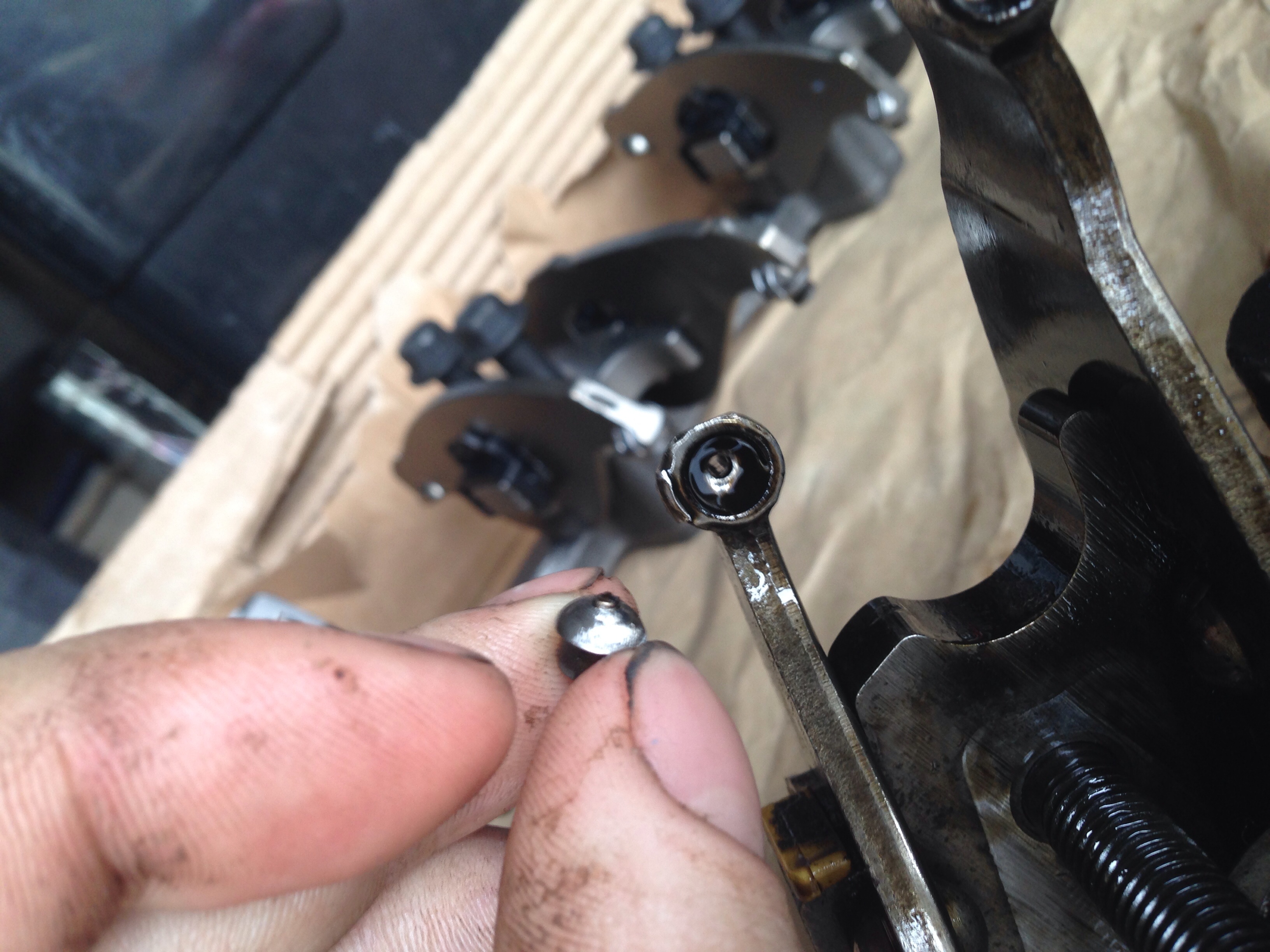

well got the passanger side pulled apart so far and got all the rockers out, and left the little plastic pipe coolant in one piece so far. upon inspection of the old rockers i realized that 3/4 intake arms were about to let go, the clips that holds the swivel button thing (sorry dont know what its actually called) were broken off only thing olding the harden tappet in there wa the pressure against the bridge

Here's a picture of the tappet out of it's seat cause the retainer broke, you can also see that it has a little nipple on the rounded part caused from the little oil galley to help lubricated it, which didn't do it's job and caused some bad wear. But when it had pressure held against it, that little nipple kept it from swiveling
