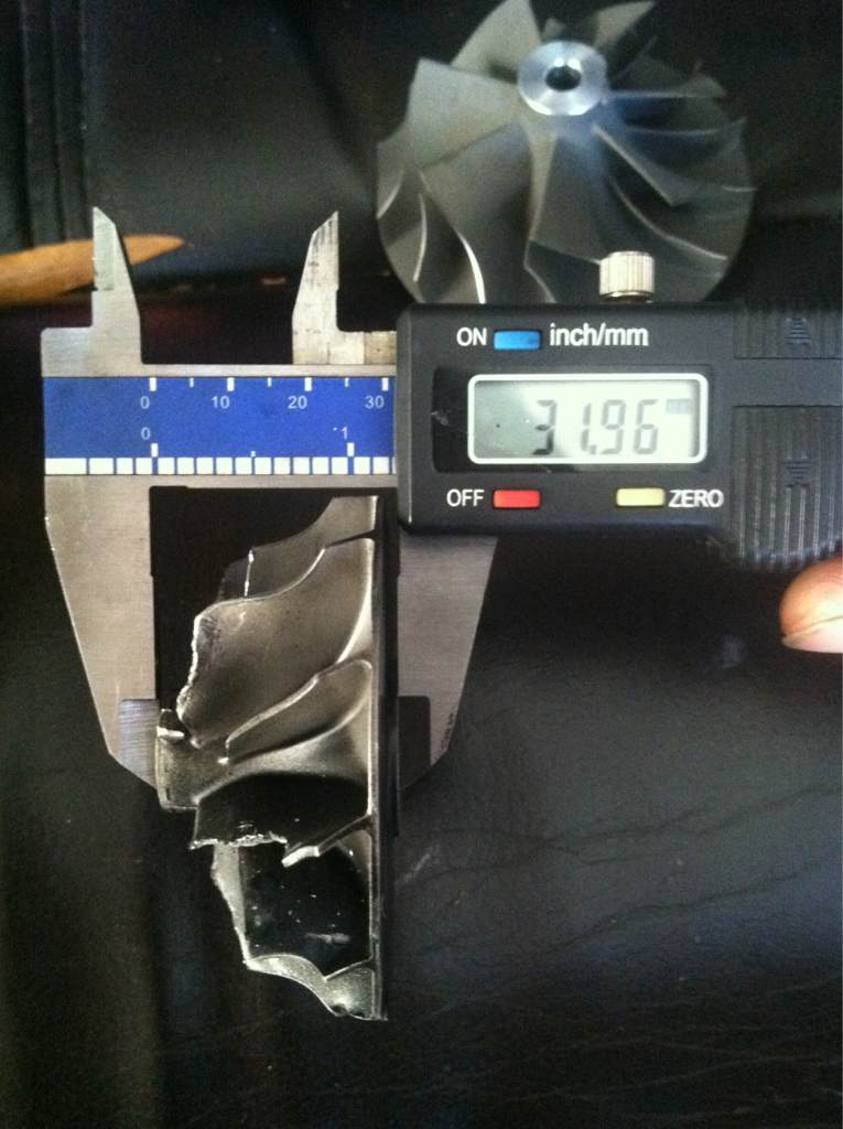

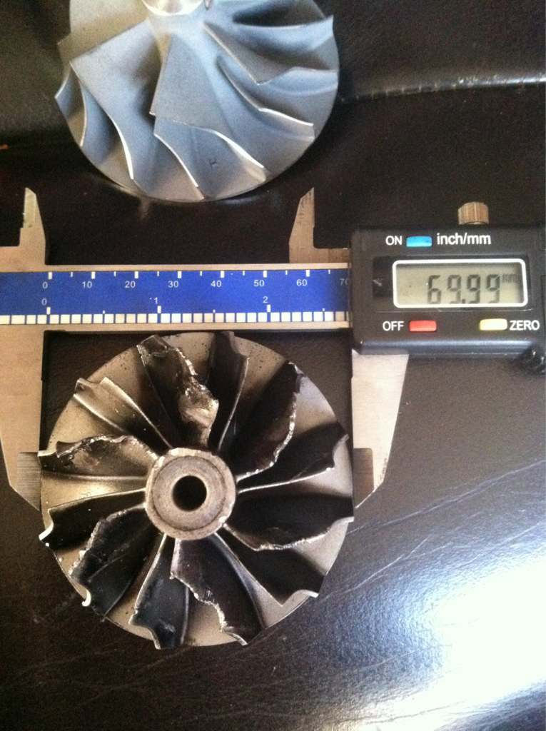

I'm sure this is a lost cause but My brother is looking for a place to get a new wheel for the IDI ATS turbo. Anyone know where to get one or have a used one? Thanks, Chris

Thanks for the info 0 Xero 0. I ended up getting a bigger wheel, shaft and machining the housing to accept the bigger wheel. Good info for anyone else with the same problem though.
-Chris Cayer
