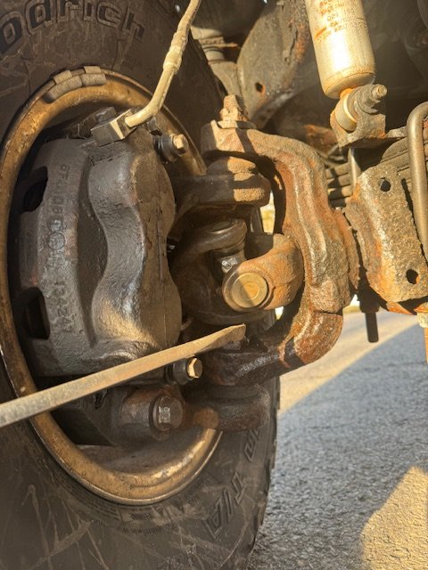

After installing the front AXLE u-joints / seals / bearings... Now I have a slight weep on the driver side coming out of the axle tube....
My guess is there is a seal near the diff. the axle slides into ?
I sprayed it with brake clean and keeping an eye on it..... But I fear the worst.
at least I know yanking the axle again will be easy since everything is fresh.
any input?

Yeah, there are inner axle seals inside the axle tubes. They’re kind of a pain in the ass. Requires pulling the carrier, and I’ve only done it with the tool from ford, but I’m sure there’s a way to South African engineer it to install the new seals

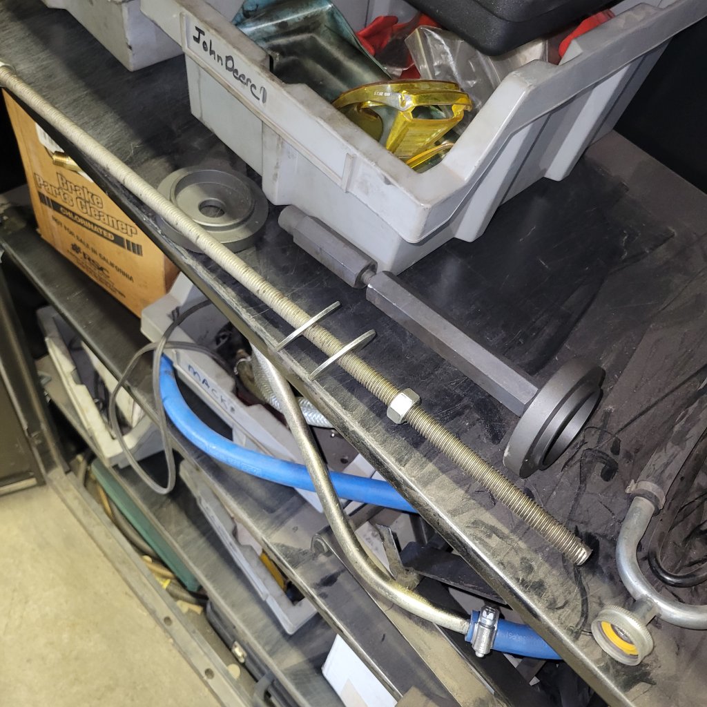

Nah,
The half inch rod and nuts is for pressing in the new seals. I've had luck just prying the old ones out with pry bar.
I have the actual tool for this but for dodge.. I've never had to use it for a Ford.

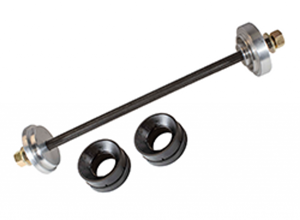

I’m rebuilding a d60 out of a Superduty and I found this. It’s pretty cheap actually and simple to use. Just need long extensions to use it on the passenger side. It’s for the bearing/seal in the chunk, then you have a dust seal on the outer tube, then I think a vacuum seal inside the knuckle, unit bearing etc. I was able to get some greaseable spicers for the axle u joints. I still have to buy a damn ball joint press though, I’ve used cheap ones before and they just break. Who makes one that will hold up without the snap on price tag?

I found this for a little cheaper.
I think I can make it work with some threaded rod and a backer plate on the other end...
