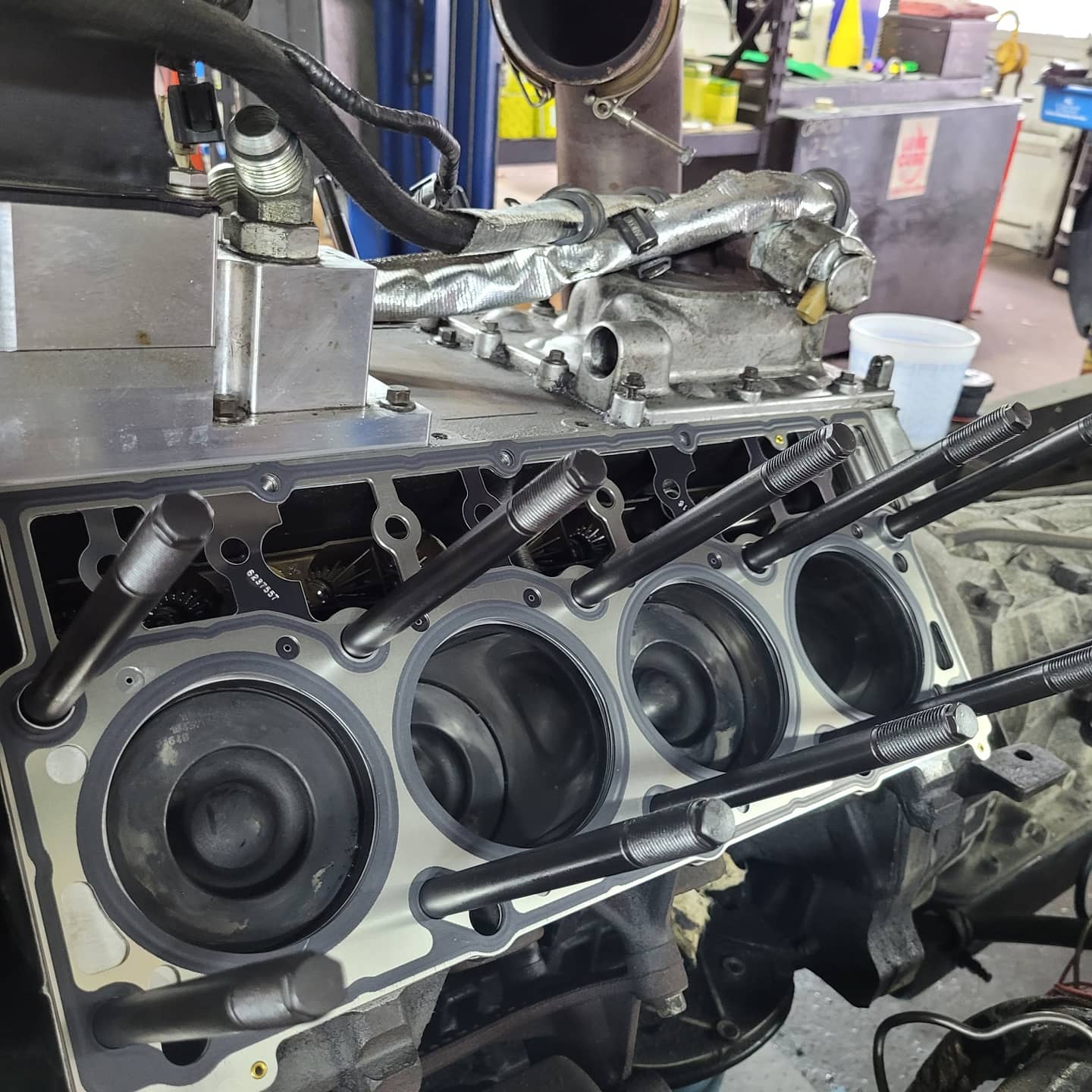

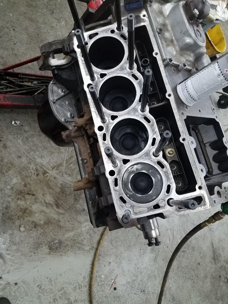

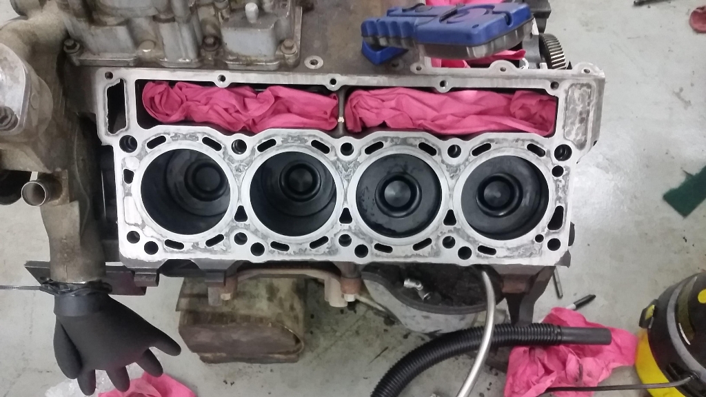

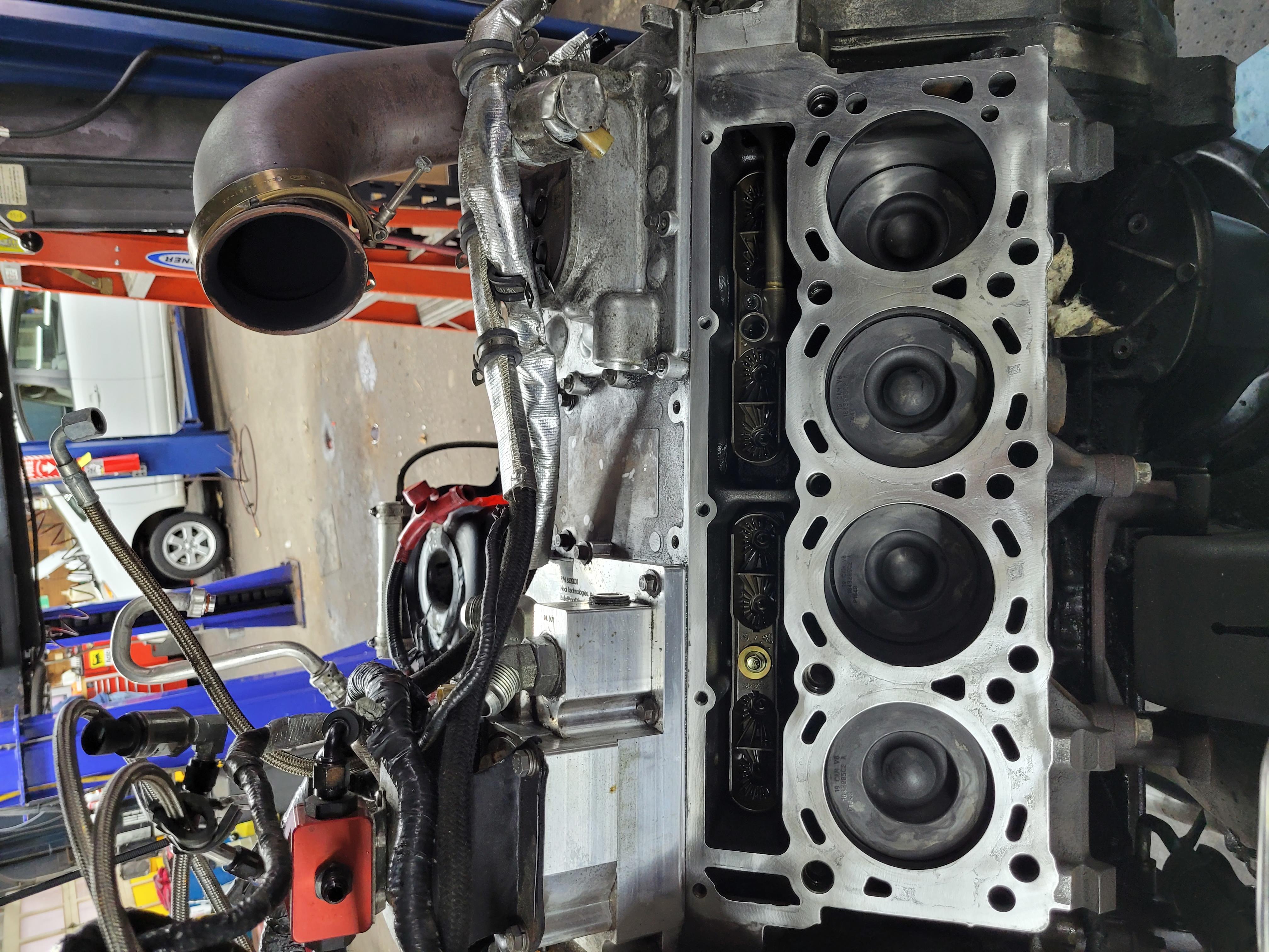

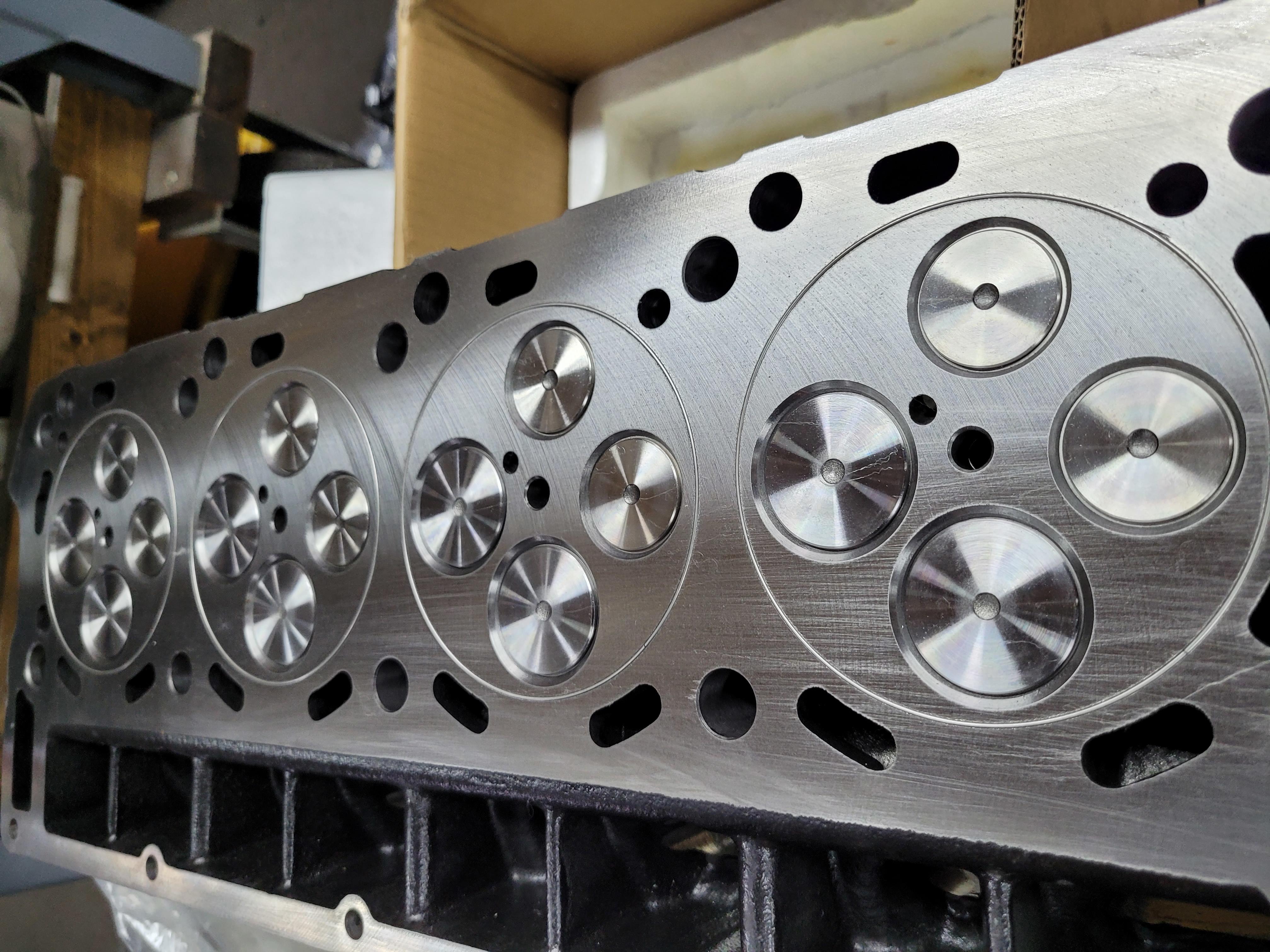

Deck was prepped spotless. Ran a fine scotch Brite room disc to remove any gasket material. Use one of the yellow finger rolocs for general clean up.
Wiped surface with acetone and lint free rags.
Sucked any liquid out of the stud holes. Blew them out with air.
Threaded all the studs in all the way. 4 stage torque sequence. Etc

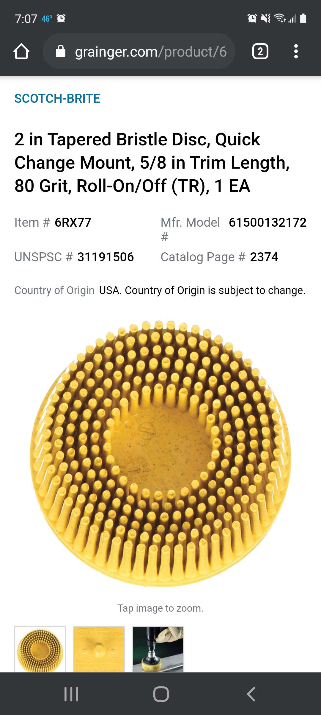

Picture of this "disc" that was used please.
Block looks way too clean. Looks like you removed the stains... If you remove the stains that means you took off metal, creating an porous surface...
So you used a rotary took to clean the deck?

This is as clean as you can get it by hand without milling. Any cleaner and you took off metal. I bet your failure is between gasket and block.

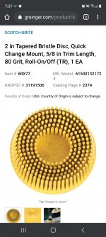

I use these all the time for prepping mating surfaces on engine blocks to adapter plates at work.

Sorry, but I have to agree. I don't see how you could keep from taking off too much metal (uneven surface) on your 6.0L block deck with that. The curse of too few bolt holes (or stud holes).

Not arguing your point that I possibly removed too much deck. Doesn't seem like I did from my pics. Just got it really clean.

at work all i use at most is a red scotch brite pad too prep blocks and heads, most of the time with an mls gasket just a razorblade across the deck is enough, doesnt need to be shiny and spotless. general rule of thumb is if you cant feel it with your finger its fine. if you dont think the use of a roloc wheel is the issue, you could also straight edge your deck too check for warping. i think no more than .002 is what is generally allowed on a deck.

I'd have block surfaced and hope it isn't too bad where you need to adjust piston protrusion

In the Ops pictures you can still see the stains on the deck. I clean every deck to the same level as the op with an air rotary tool and have yet to have a failure with around 30 stud jobs. Unless the deck itself is warped or uneven, I doubt the amount he took off has anything to do with why they failed.

Judging by the pictures.. The items that are still present are actually erosion. So no, you're not going to clean them off. I want to see decks like mine cause those are spent with razor blades and about 1.5 hrs each side with a light dusting of a green scotch Brite
