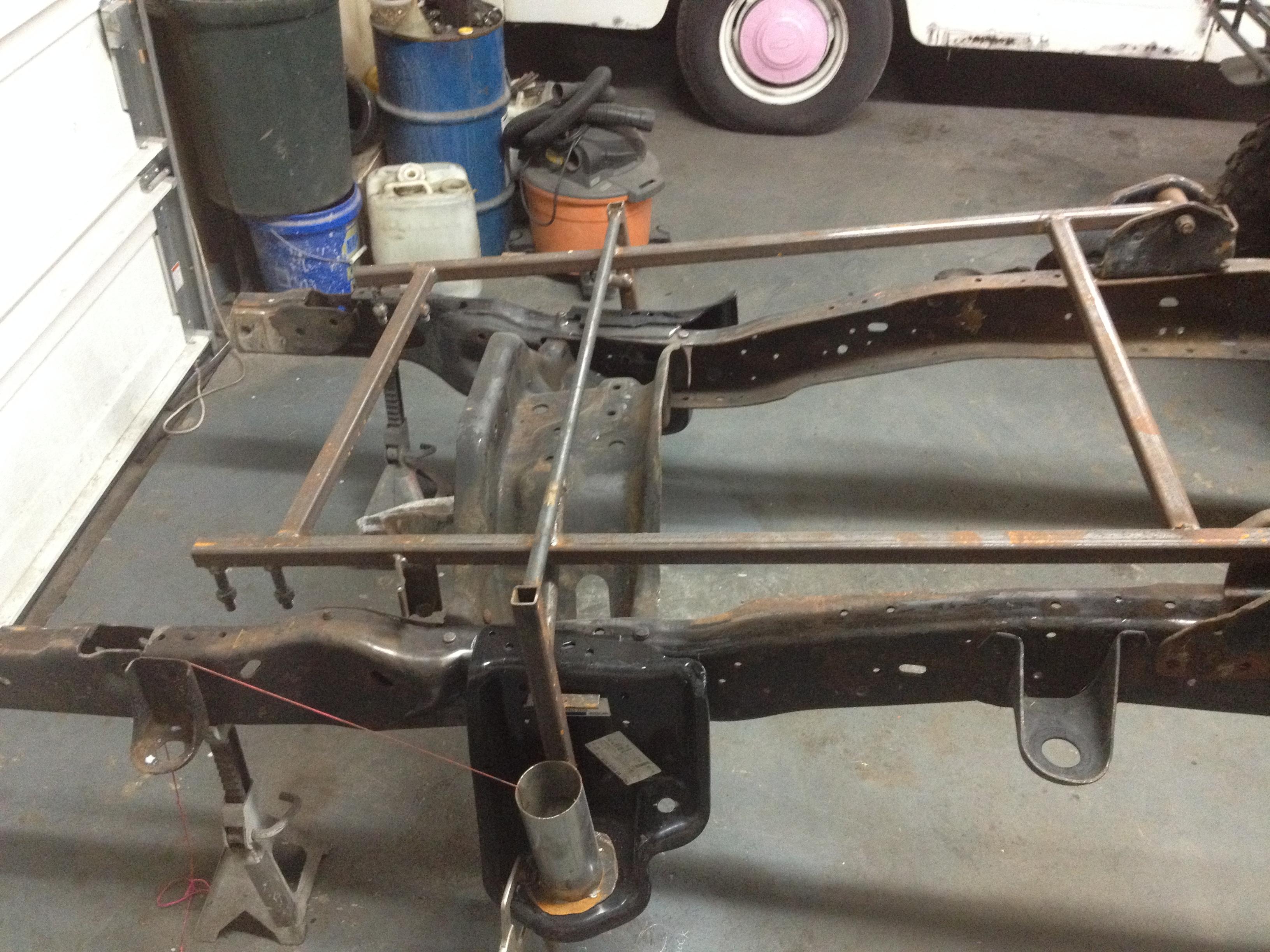

Going into the weeds a little: I made a transfer jig on the 05 frame before removing anything. Then I used that jig on the 96 frame to locate the spring perches, sway bar mounts, traction bar mount and the steering stabilizer mount. This is how I located the sway bar mounts where I have them.

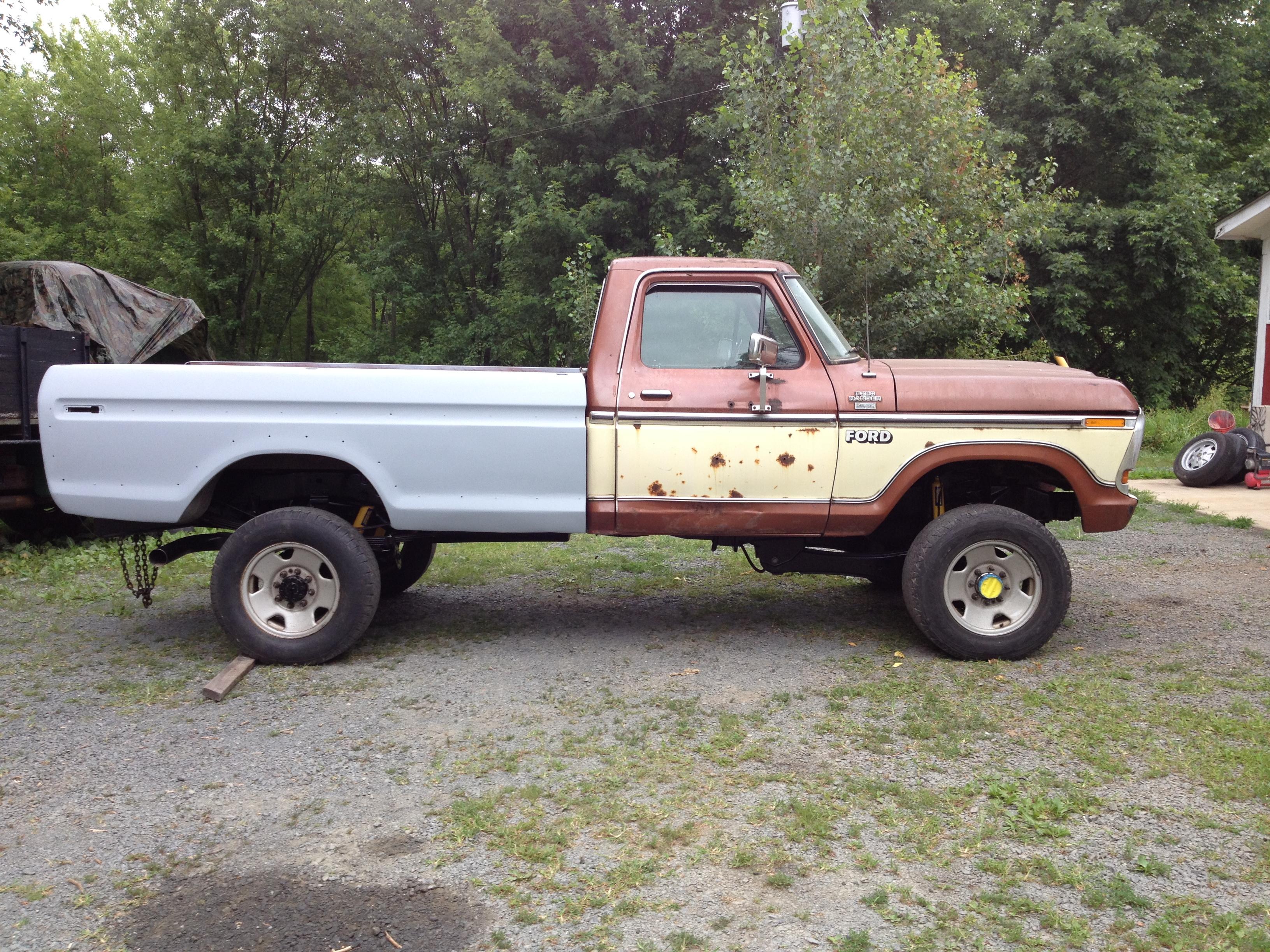

The 78 body is in immaculate shape which is the primary reason I decided to do this project. I came across the body as a "roller" without engine or transmission which made it ideal for this swap. I bought it from the grandson of the original owner, after the grandson had drag raced it for a couple seasons and got board with it. Aside from the visible surface rust in a couple places, there is no rust anywhere under the truck or hidden behind fenders, bedsides, cab corners, etc.
Here's a couple more pictures of where it's at today. I upgraded the rear tank to the 38 gallon so I could eliminate the front tank to make space for the electric pump and filters. I started the engine a couple days ago to check for any leaks or issues and found a small oil leak at the dipstick. Frustrating because I put a new oil pan on the engine and replaced the O-ring. I have a feeling the O-ring was not correct because it didn't seem like it had enough "compression" when I installed it. Now I know it didn't compress enough :(

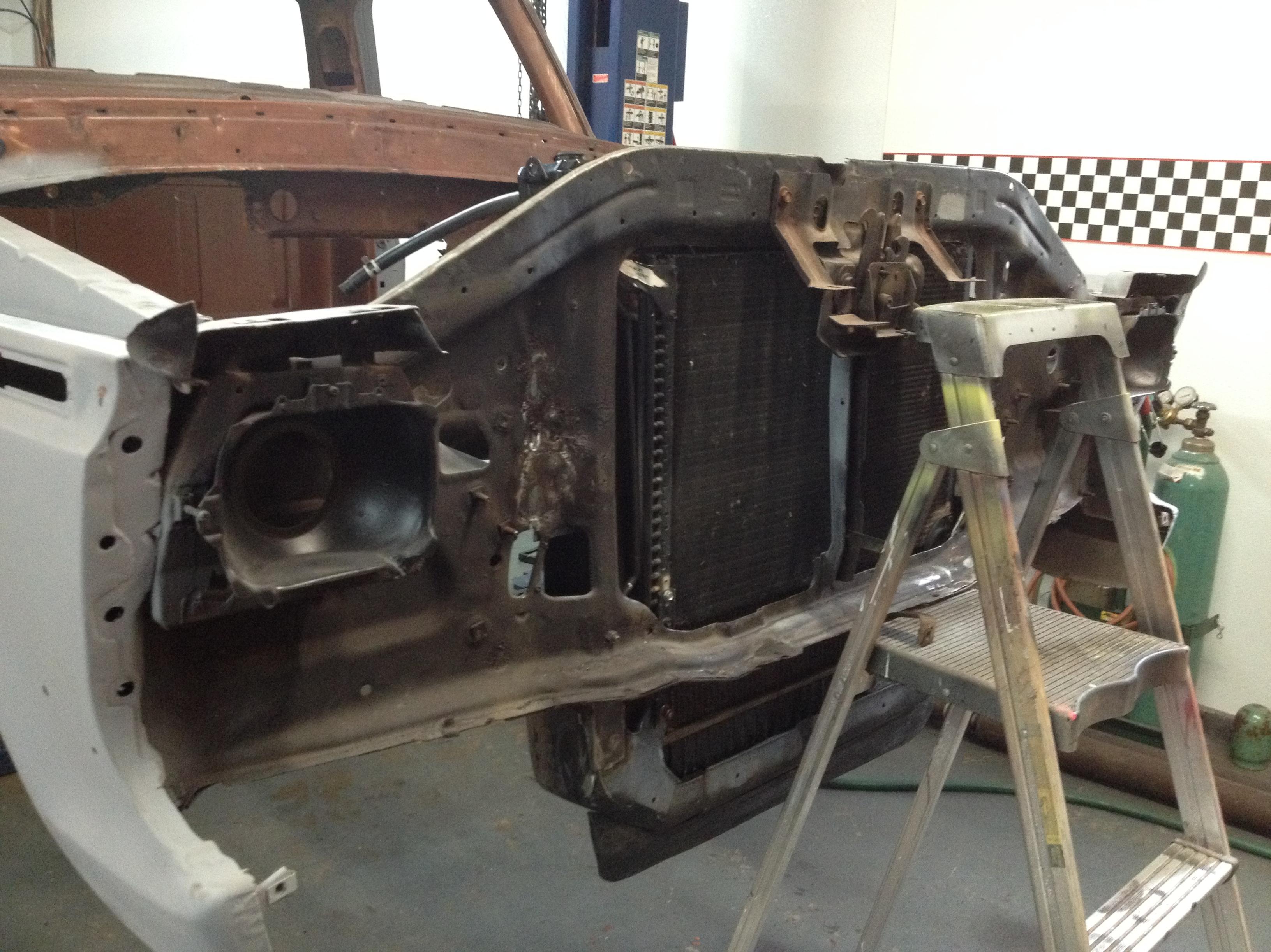

All the mods to the radiator support are done. I had to make new radiator support to frame mount brackets because the 78 frame is narrower at the front. The 78 mount brackets were "in board" of the inner fenders and the new brackets are now "out board" to line up with the 96 frame brackets. The old "in board" brackets had to be cut back to allow space for the 96 radiator lower support. I cut them plumb to the support and boxed them so I could drill a hole for a bolt to hold the 96 lower radiator support. They are boxed to the width of the 96 lower radiator support.
The lower radiator support is the bottom section from the 96 and was cut where it starts to widen out. The lower sections fits well between the 78 inner fenders but I did need to trim 1/2 inch off each inner fender to give the width needed for the lower radiator support. Six bolts hold the 96 lower radiator support bracket to the 78 radiator support. One last mod was narrowing both rear facing sides of the 96 lower section to allow clearance at the sway bar brackets.
The upper radiator brackets are from the 96 support. I cut them off and welded them to the 78 support.
The AC condenser fits perfectly in front of the radiator. I had to "massage" all 4 mounting brackets to get it snug into the 78 radiator support. The brackets were all flattened out so it would tuck into the big opening in the support. The bottom two bracket had to be removed and lowered on the condenser for best fit.

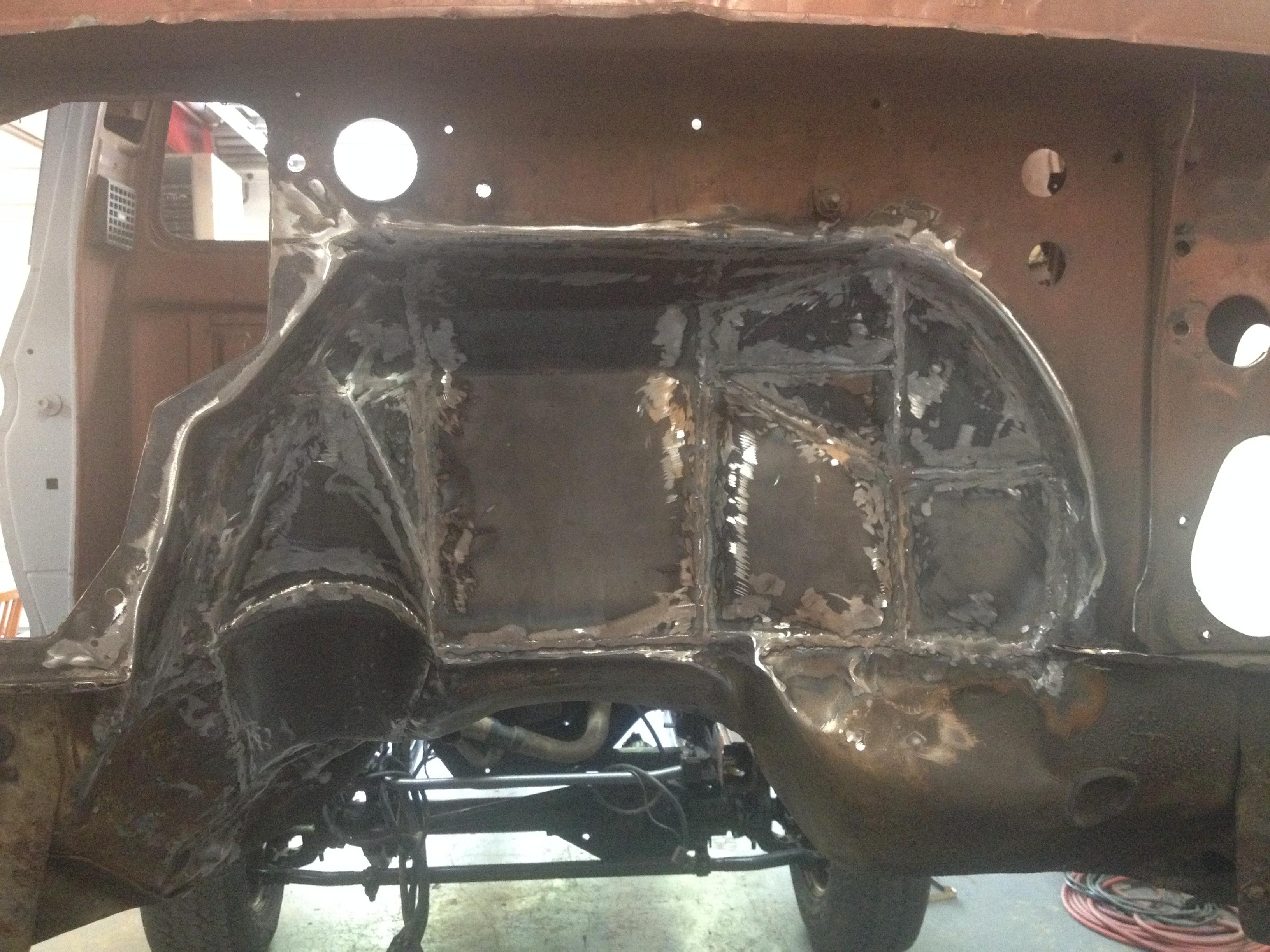

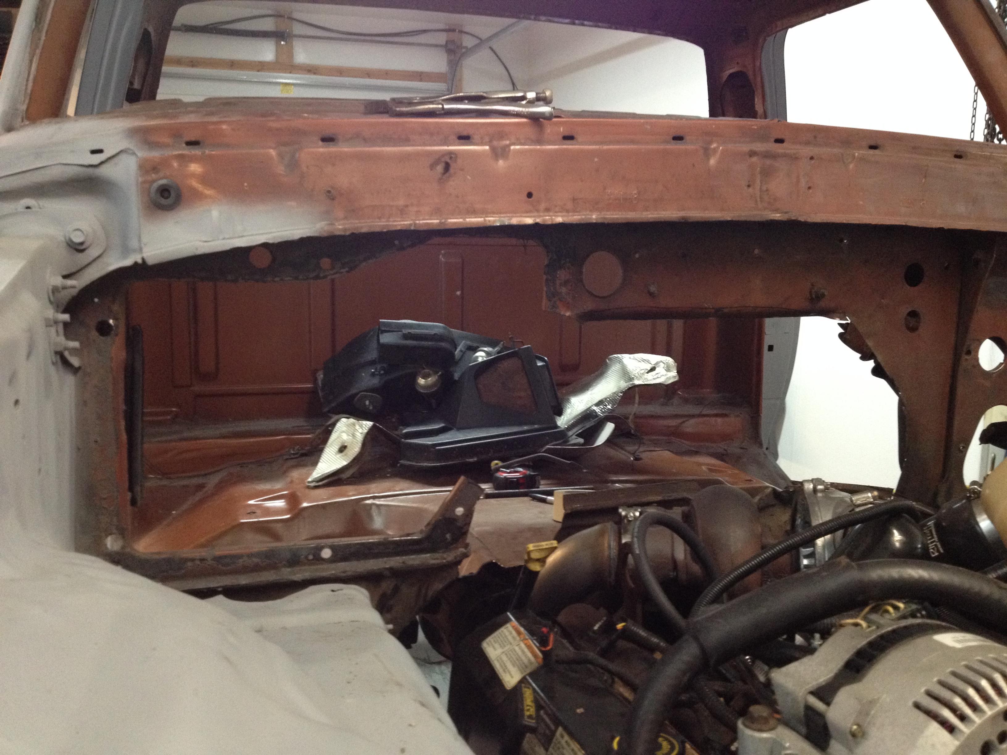

The firewall turned out to be more work than I was hoping for. I first tried some gentle massaging with the 4 pound hammer but it quickly became obvious that cutting out the firewall was necessary. I had to cut into the heater/AC box area as well to allow space for the down pipe. So 13 pieces of sheet metal later and a whole lot of welding, plus some trimming on the heater/AC box here's what I have.

Here's a couple more pics. Notice I used this "re-sheet metal-ing" as an opportunity to fit the accelerator pedal. Although the pedal isn't in the pictures, you can see the three bolt holes for it. I also carefully spaced the sheet metal work around the engine so I can re-use the heat shield and still have a reasonable air gap between the shield and the engine. The shield is easily re-molded with a rubber mallet.

No, it's not a matter of up/down but rather forward/aft. Some "up" would help but I'm really pleased with where the body sits over the tires now so definitely didn't want to lift the body.
I "think" the engines are set back further in the mid 90's frames versus the late 70's frame. The reason I say this: there's too much extra space between the fan and the radiator. The fan shroud doesn't quite cover the fan so I'm going to need to make an extension on the front of the shroud to cover the fan (probably 1 inch). I've long since scrapped the 78 frame so I can't measure it, but I do think the engines are a bit more forward in the 70's trucks.
Another possible option for avoiding the firewall work would be to move the engine forward in the mid 90's frame. Not sure if this is possible though without looking further (oil pan clearance?). One draw back to doing this might be knocking the center of gravity out of whack that I'm sure the Ford engineers so carefully balanced these trucks around which allows them to handle like a fine Italian sports car LOL
