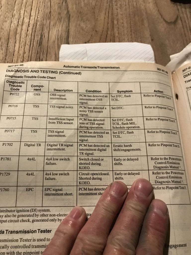

If you felt a bang and lost OD, the OEM style snap ring might have popped off the OD piston return spring. They like to do that. Sonnax makes an upgrade spring that will not pop off. It is a spiral ring that has ends that lock together.

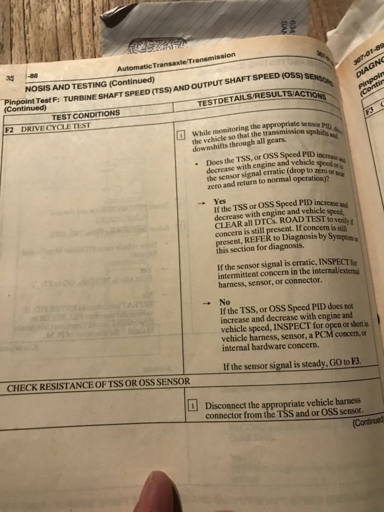

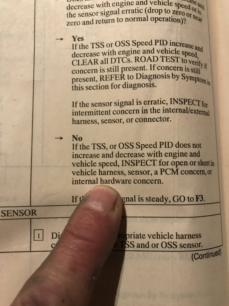

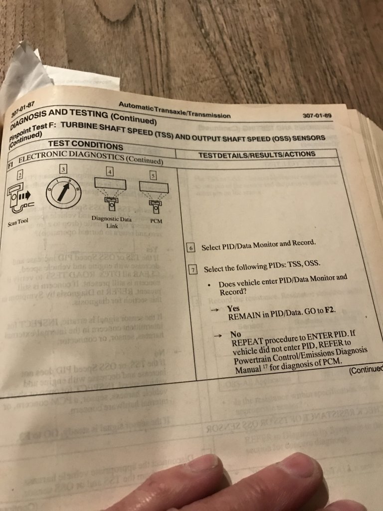

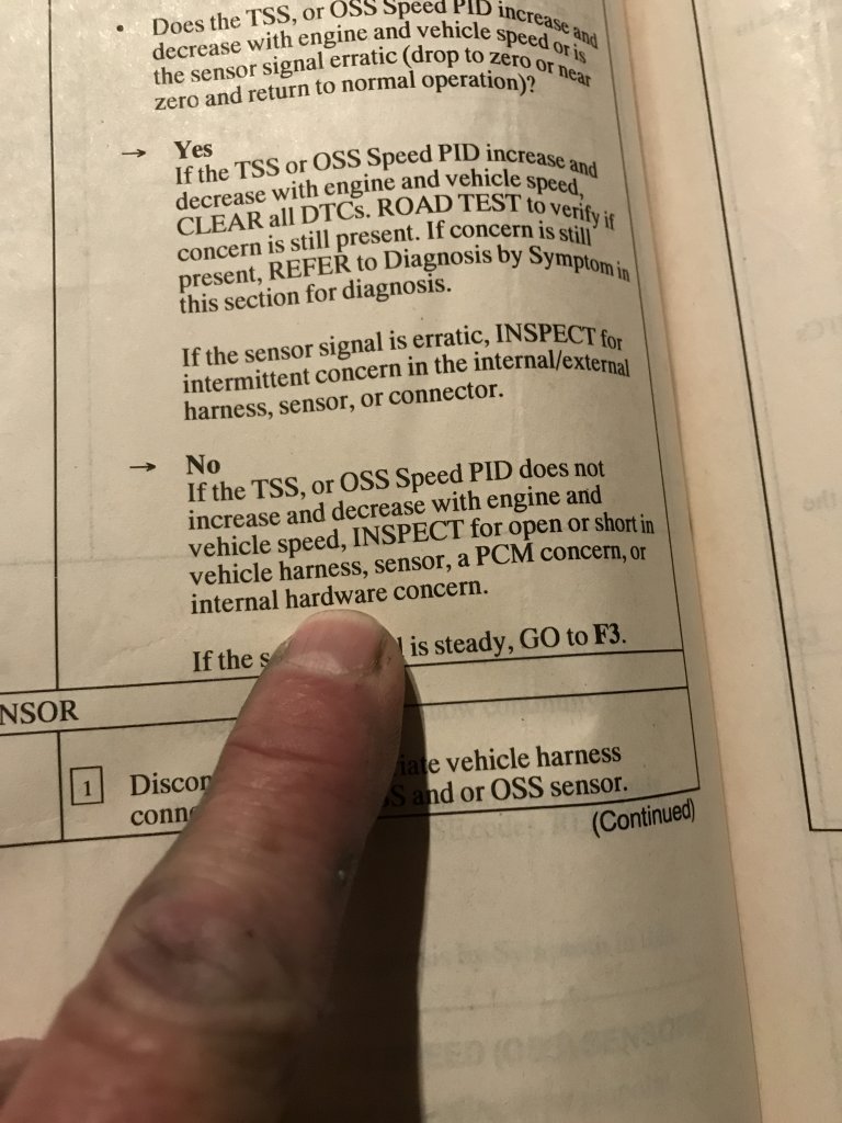

I can post the pinpoint test for the two codes. They are electrical and at the end if electrical checks out, internal concerns is listed. The electrical issues that you check do not cause a bang. When those two codes come up and it is mechanical, it’s in the OD or coast clutch. The coast clutch usually causes shavings and they stick to the TSS magnet if driven for a bit.
Aug 10, 2015
141
10
Maryland
Both go to pinpoint test F.
