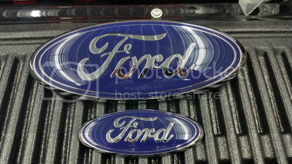

Stock emblems

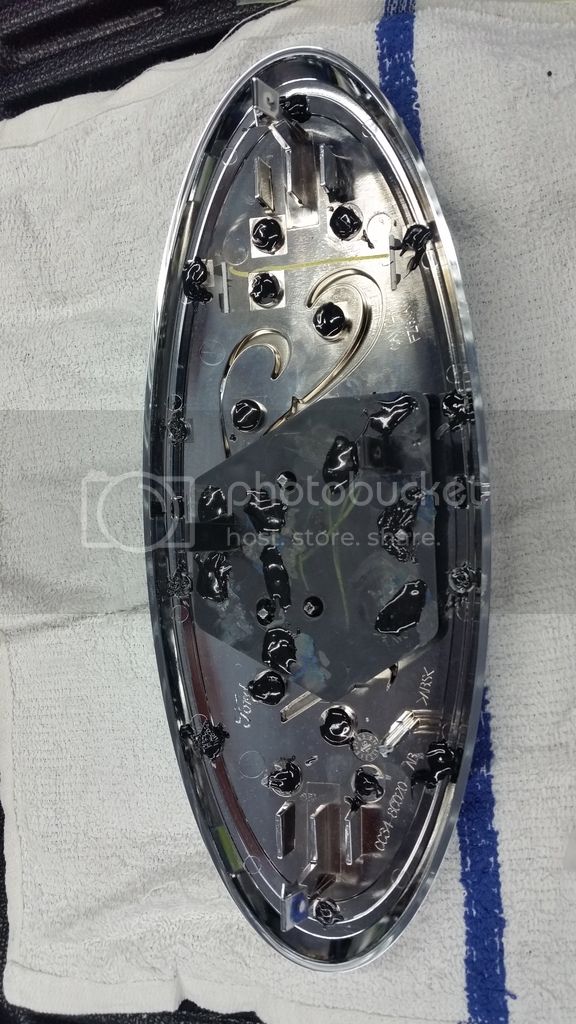

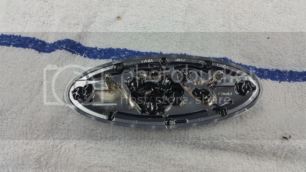

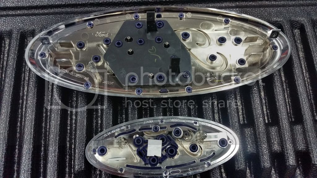

The back of the stock emblems. To seperate the emblems, you want to grind away the mushroomed/rivet. I used a dremel to grind away the mushroomed plastic. Once everything is grinded, you just push out the blue part with a suitable tool. The painting part is up to you.

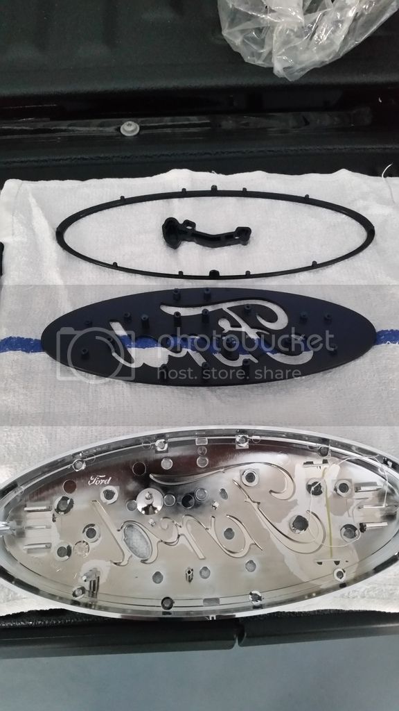

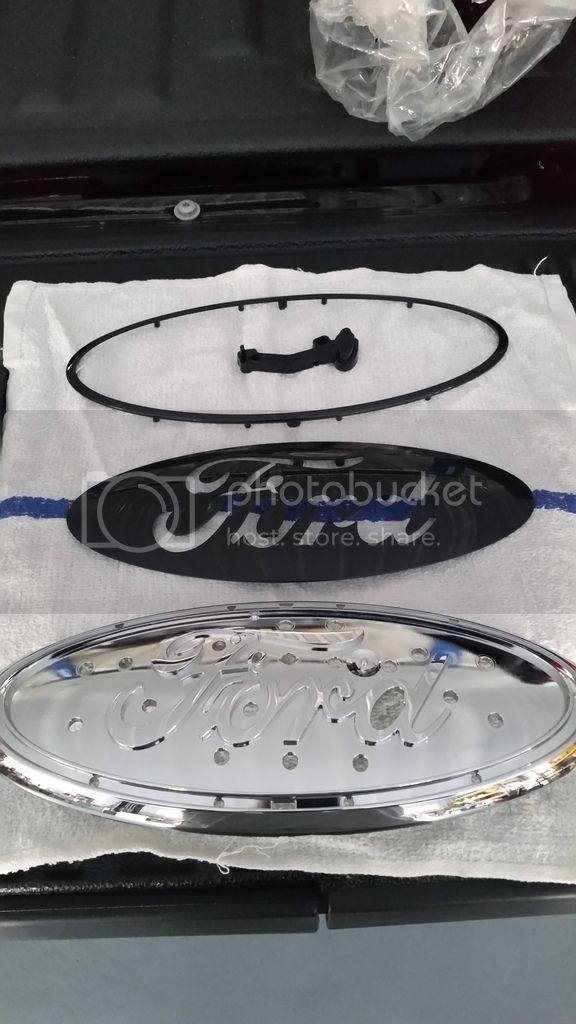

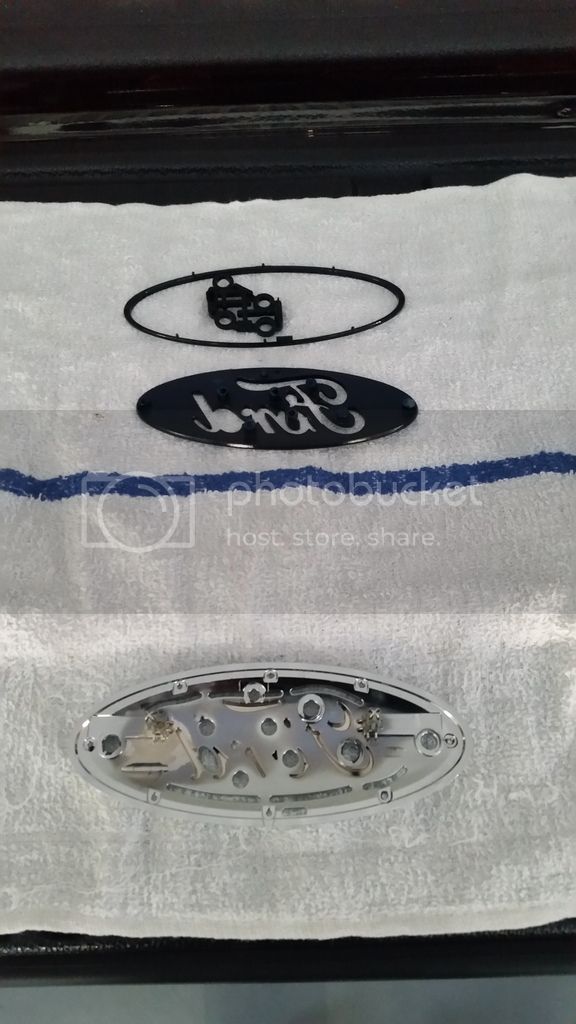

Here are the emblems back from the paint shop. The small piece is the center of the "D" and the center of the "F" script end.
Front

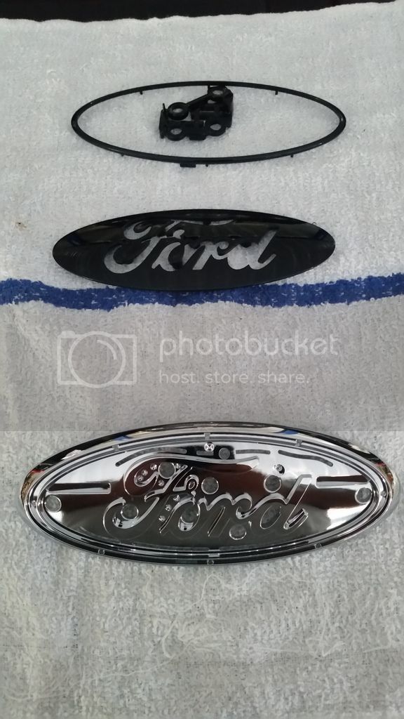

Rear
I used a 2 part plastic epoxy from Kem Automotive that I got as a sample.

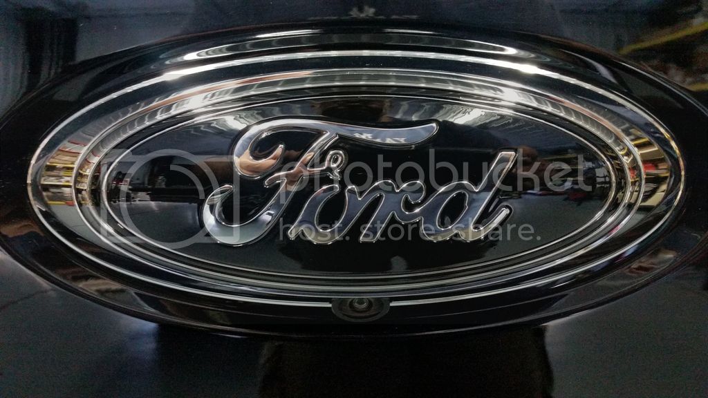

Rear

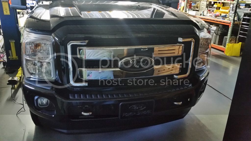

Front (not pictured is the center black piece epoxied in)

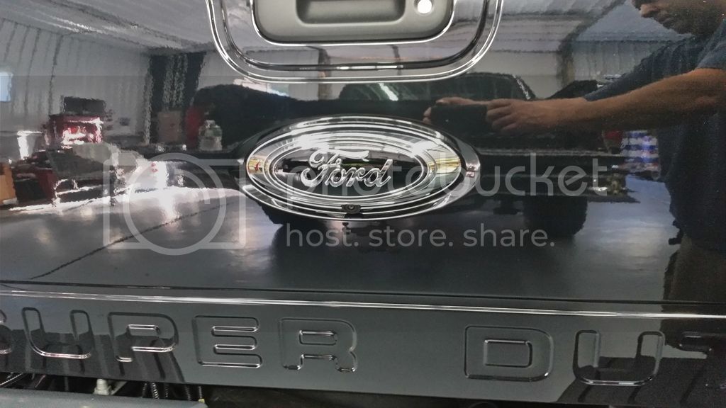

All together
The rear emblem just pops off. On the bottom of the emblem is a notch, very carefully, not to scratch anything, insert a small tool to pry it out. Once you get some clearance between the emblem and camera base, it comes right out.
Front
