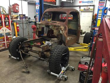

Pops and I building a 49 f6 rat rod style. Got 06 axles under it, BTS e40d, and a 700hp 12v. ( he wanted to do a 12v haha ). Anyways, I got a question on trans set up. I want a ratchet shifter, but then still need it programmable for shifting. PCS is what I was looking at but do I need a harness from an obs? Or does the PCS just control everything? Power and ground to the controller and PCS trans harness. Run wire to tps and that's it? Need a little info. Thanks

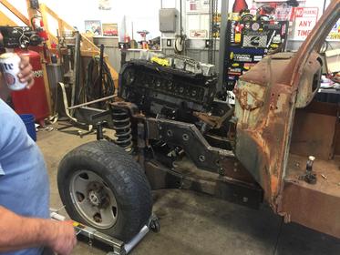

Looks like it will work well with how you did the front frame section. I wish i had done mine differently. It's possible to do a 7.3 in a 48-52 just cant use fender wells and IIRC the motor has to be sat pretty low. There's quite a lot of room in my 53 especially on the passenger side. hardest part was keeping it short enough to fit under the hood with how i mounted the motor but it was kind of necessary if I wanted to keep the 53 VIN and title as a 53

Yea there's the latest. Sorry forgot I had this thread on here Haha. 4 link in back, 3 link in front. Motor already for pick up at millers machine shop.
