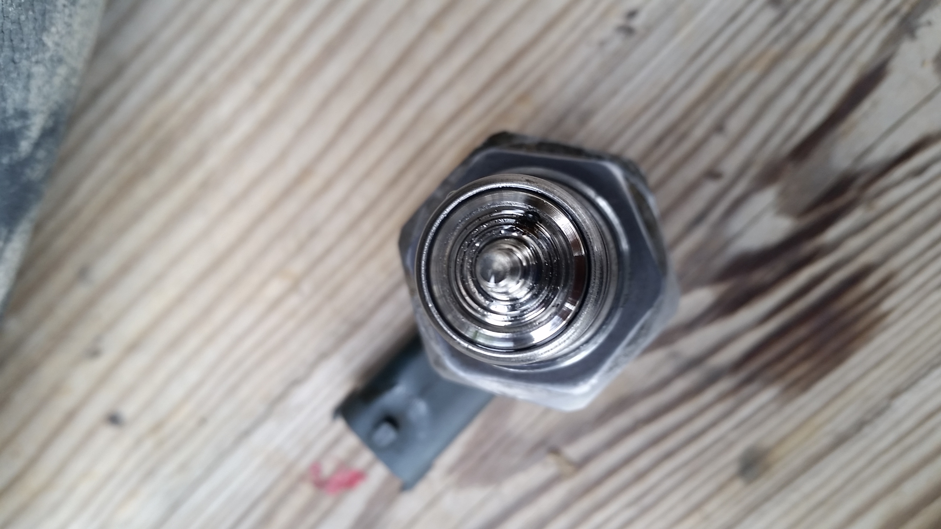

Waiting on the title to show up before I throw some money at it... played with it a little more out of boredom and found this.... pic quality sucks, but that's metal. Guess I'll be replacing it all...

Eh, it's not terrible I guess. I bought the truck assuming it needed an engine, so this is a pleasant surprise.
