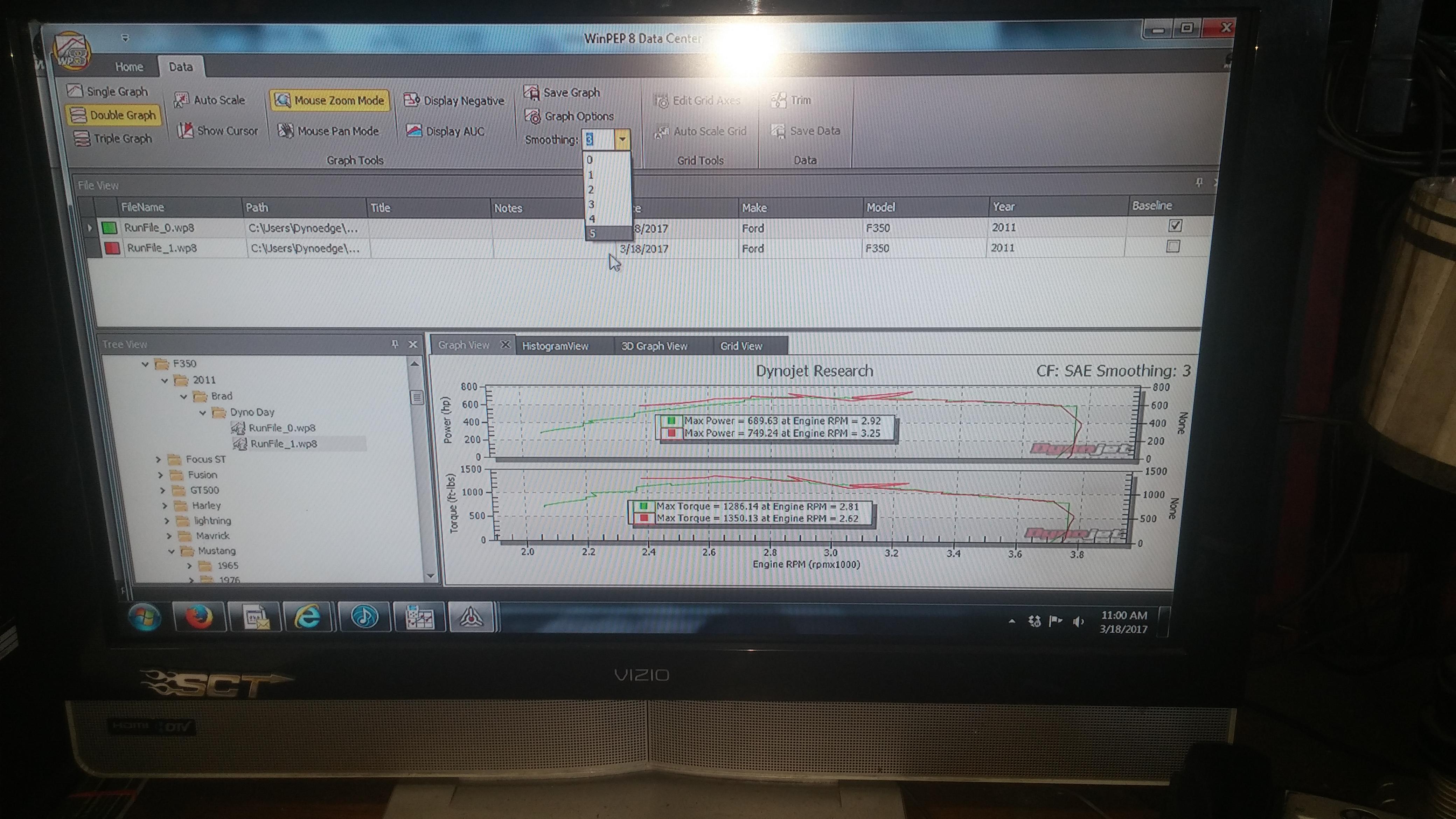

I made 750/1350 with a 364.5/74/.91, so if you have the bigger exhaust turbin I doubt you're leaving anything on the table

It's funny there's always a non believer
It also went 12.85 with a DA of 6900'
It was in a cclb 6.7 with a dual fueler. Here is the dyno screen shot and the ticket from the track, although I dont know the weight.

Duh! A 6.7 is slightly different than a 7.3. That’s like me coming into the 7.3 section of the forum and saying I made 793hp with no turbo....
.....on a 540 Merlin boat engine!

This is also the 7.3 section. Not even a comparison! So...

I think the point is that in a 7.3, the 364.5 will not clean up the fuel needed to get to that range. That is why it "won't work" for that power level.
