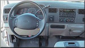

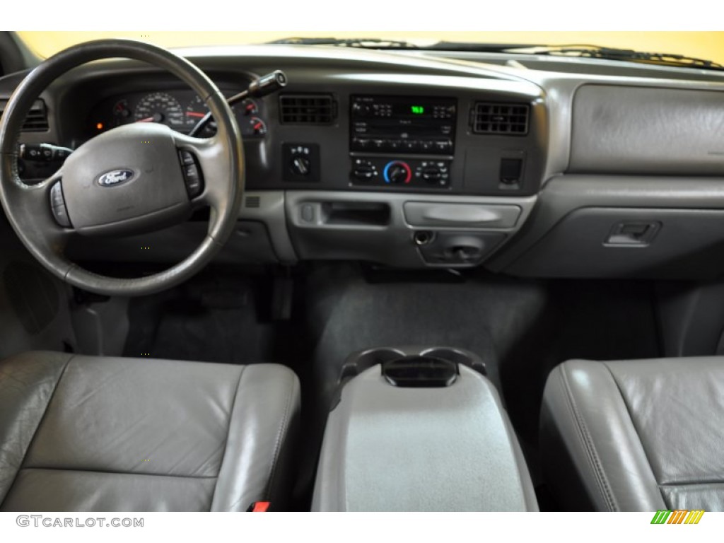

CSIPSD
5,284
Bend, OR
So this is ugly...
But this is not???
Curious WTF is the major differance?
Good lord some people make a mountian out of a mole hill.

Yeah Joe I like the 02-03 clusters because the gauges a spread out (2 on each side) and IDK seem better and nicer to me But hey if I could install a 08 or 11-13 cluster I would because those the nicest cluster out of all. But hey Joe that's my opinion LOL.

Good god....I am curious if you are even serious or just wasting time to see if anybody has knowledge of the crap you come up with.
My first ? is have you ever replaced cabs, repaired wiring, etc.. etc... to even be asking about the swap. The info Kyle provided is what you would need to use an 03-04 6.0 cluster with a 02-03 7.3 PCM.
If you want the "newer" style cluster you need an ENTIRE 02-03 7.3 wiring harness. Not just dash. EVERY bit of wiring in the 02 up trucks changed. Harness behind the dash, firewall, engine harness, cab harness...etc...Also they are completely different harness's between auto and manual.
You technically probably could interface the 99 harness with the 02-04 CAN system if you had every schematic, pinout, and 100ssss of hours to make them work together.
IMO, if you are serious do an 05 dash and 02-03 7.3 donor truck for the wiring you need and have fun.
If I have time tmrw I will post some pics of the fun you would be in for. Ohh.. and if its a 99-01 truck you need to piece in a part of the 02 firewall to really make it "right".
