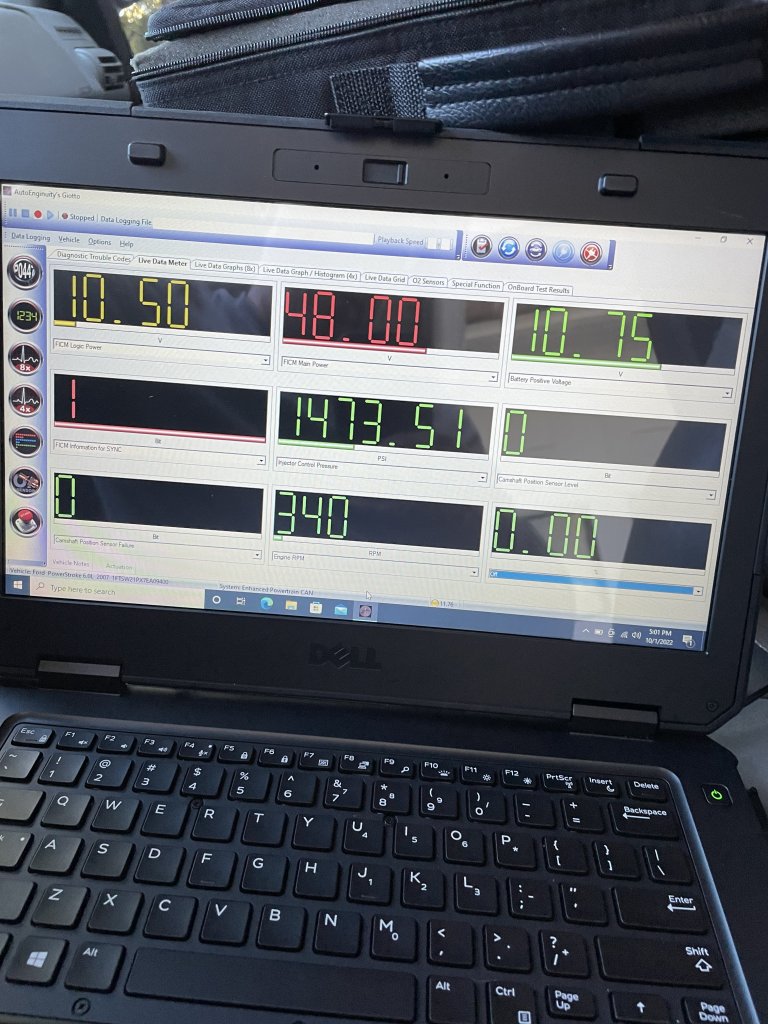

A new injector harness has been installed and a new plug on the main harness so all three seat firmly in the FICM. The truck now "sputters" when it gets past 550-600 psi ICP. The FICM sync looks good as does FICM voltage. The batteries were tested but drop to under 11v when starting as seen in the snapshot below. The high pressure oil is slow to build but the system may still have air in it as it hasn't run long enough to purge the air yet. I never see the cam position sensor change states but it doesn't show faulted. Currently waiting for the fuel pressure fitting to arrive to verify pressure. Any suggestions beyond checking fuel pressure? Could the cam position sensor be bad without throwing a code? Thanks.
