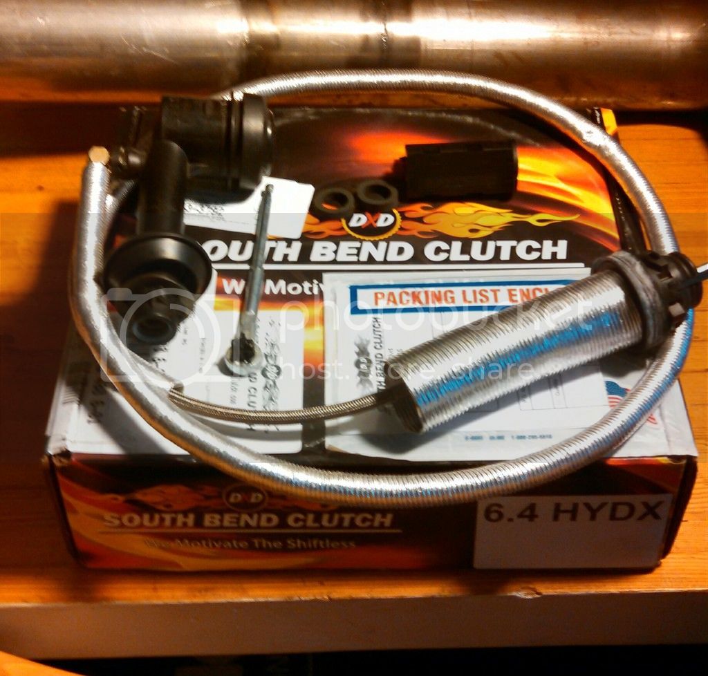

Been going through the truck addressing a few reliability issues we had our first season out, one of which was the stock master slave assembly.
Well South Bend gave me the honors of trying out the very first 6.4 ZF6 steel line master slave assembly.

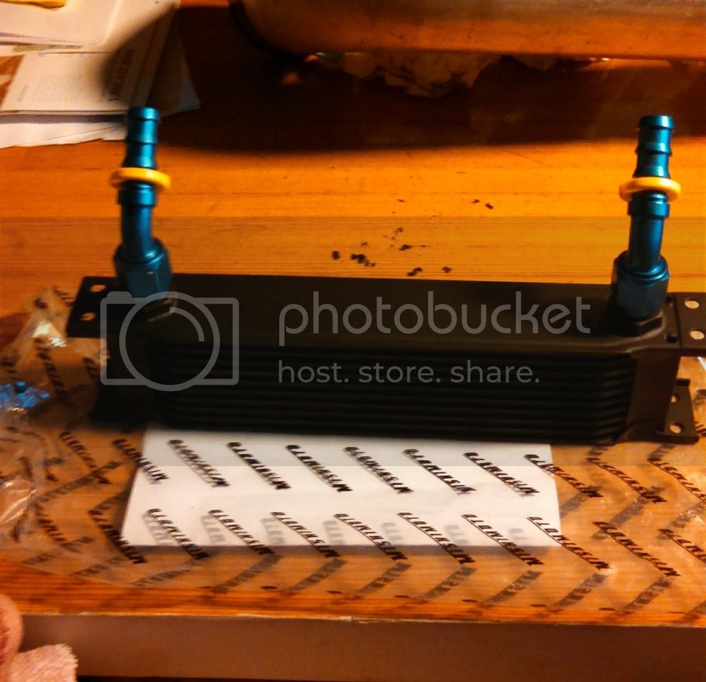

Also going to install a small fuel cooler for those hot days when Im the last puller and have to sit in line forever.
[/URL]

I'm interested in how that new slave cylinder works out. I will be buying one if it works well lol.
[ATTACH=full]159036[/ATTACH]
sweet! why not a small ice box like the drag cars use for days like that?
I dont see why it wont work well. Anything is better than the plastic crap especially with a DD clutch.
live life full throttle
This will be nice and simple. Plus there will be more ice for my beer! :pint:
