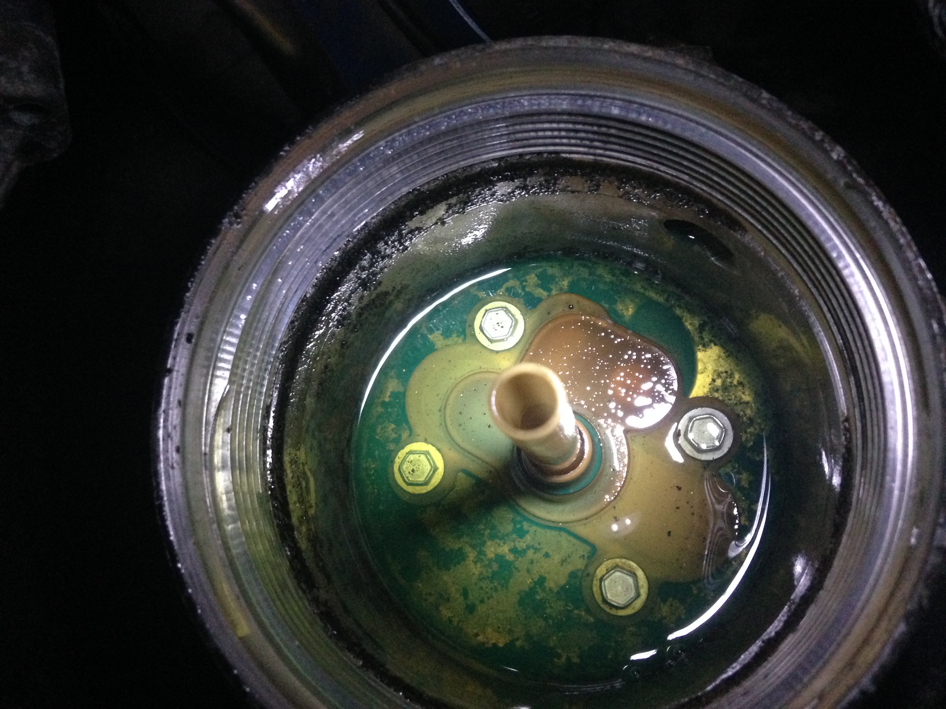

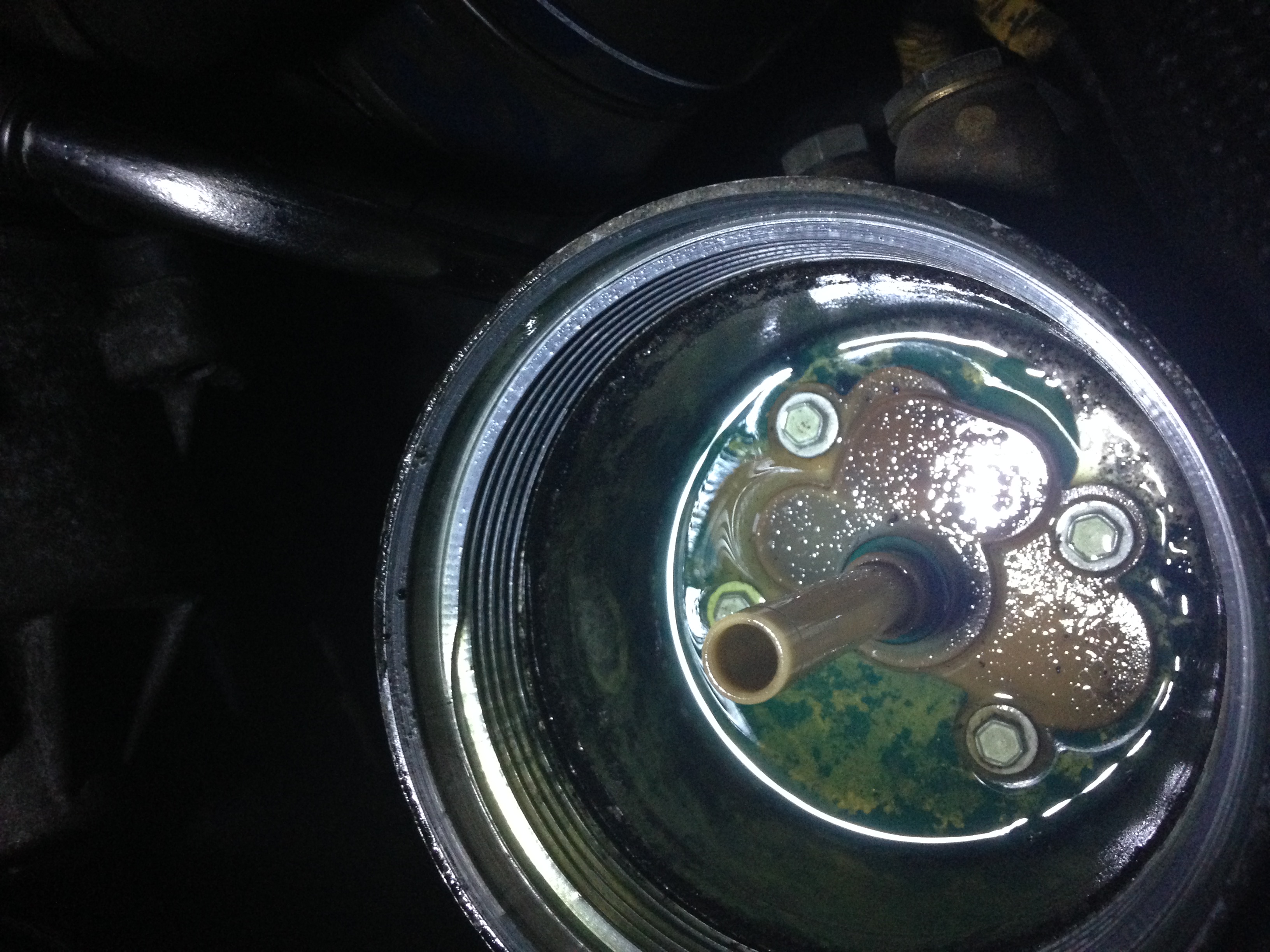

just had a though and decide to open the fuel filter on top of the engine. I'm guessing this is not good!!!

Chit, you pisted those pics as i was replying. Yeah, youre f***ked. Looks like a fuel system is in order. All that rust and what not is more than likely in your injectors and hpfp.

it crank be does not try to start, no smoke, no hudrolock, oil level still the same. yes the truck is bone stock and there is a beeping sound coming from EGR valve area when key is ON
ok so I only need to replace HPFP, injectors, HP line, cooler and fuel filter bowl? I can take those from the old engine I remove witch had the rod through the block. the only thing I have to buy is the HP line kit with injectors seal/washer....

You will also need to replace both fuel rails and flush all the lines, and you may check that nothing ended up in the low pressure pump. If it did, you may need to drop the tank and clean it out as well.

opened the fuel filter on top of the old engine today and it was clean as new. so i removed the injectors, fuel rail, HPFP and fuel bowl. will send the injectors for testing and still waiting for gasket, seal and line to come in.
