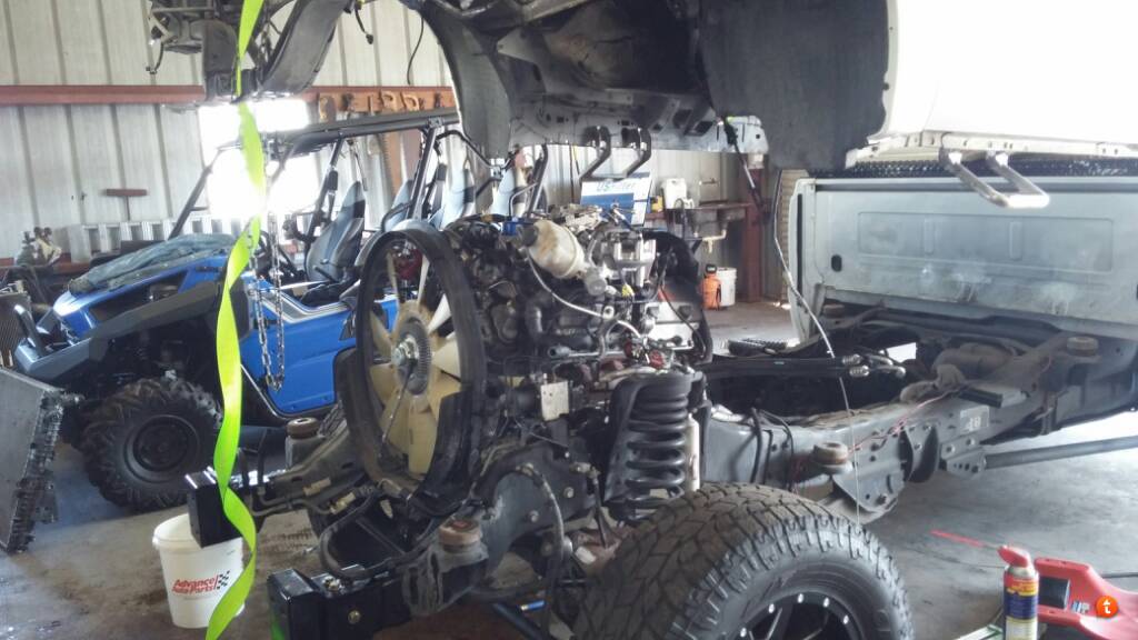

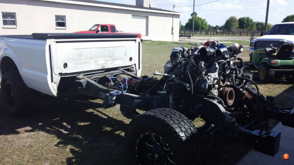

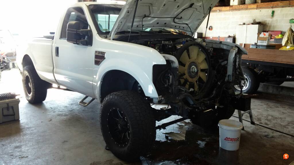

Well guys just started saturday on the truck. This is my 1st ever cab off project and also 1st 6.4. Started around 8am sat morning and by 1230 we had the cab off including all coolers, intercooler, and radiator (was leaking) replacing with Mishimoto Radiator. Spent a couple hours on it again sunday and got the oil filter housing and fuel filter housings off and the turbos and accessory drive and wiring out of the way plan to pull the heads tomorrow or thursday.
