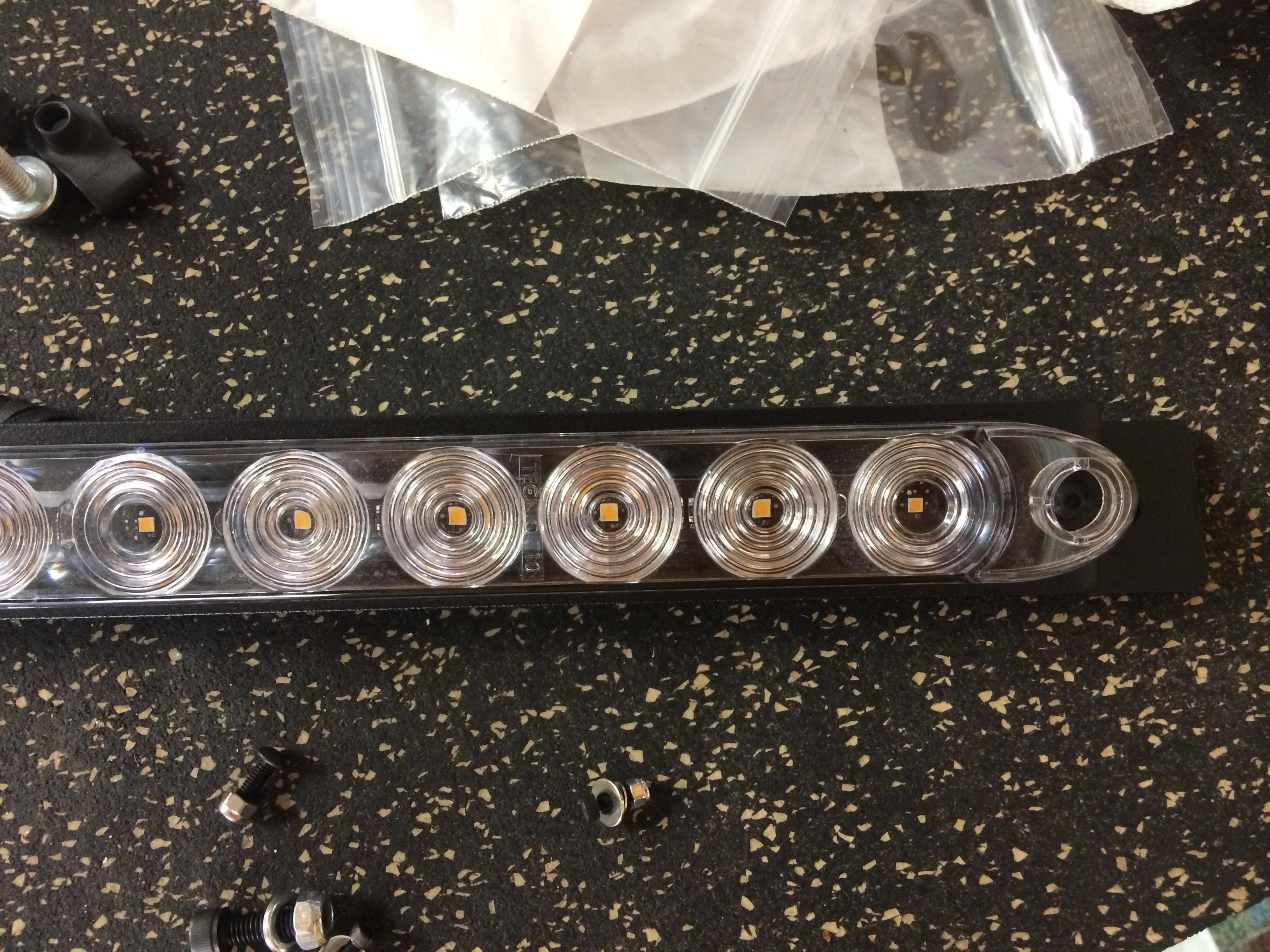

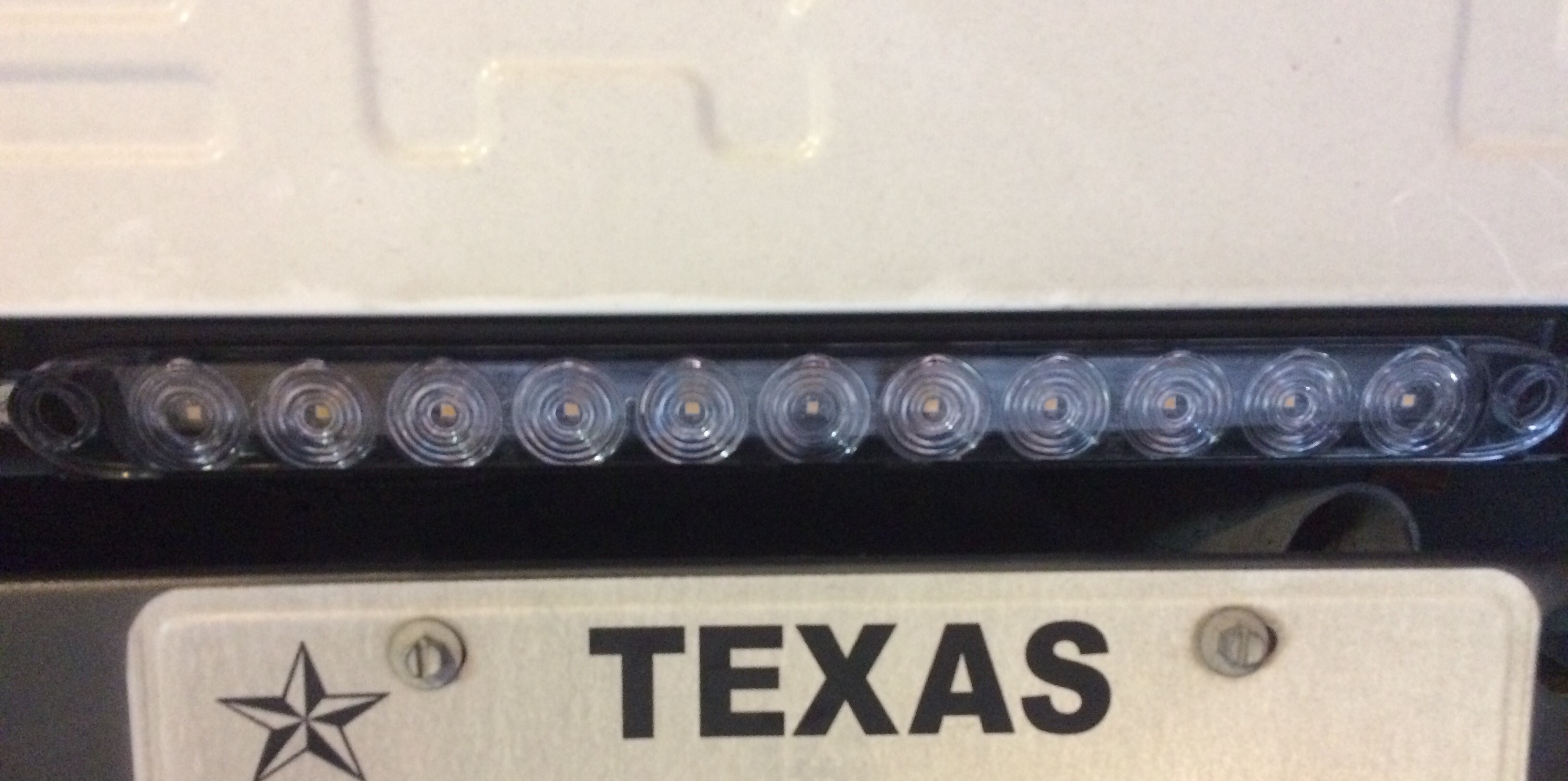

On my 12, there were two plugs that had blanks plugged in above the hitch and behind the rear the driver side wheel. I used the ford kit and it plugged right in.
I actually cut off the 7 pin and used the pigtail to power a third reverse light mounted under the tailgate. Works great.
