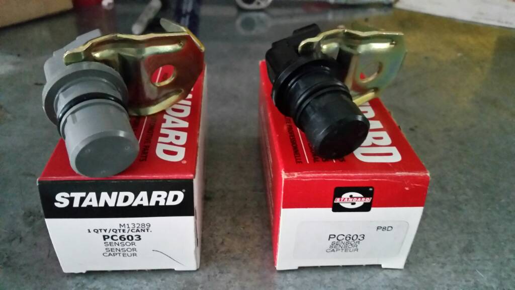

This just makes me even more happy I got a free black one last summer. Pretty sure it was Lincolnlocker who found them for sale online a couple years ago and bought them all I think.

READ------> http://www.powerstrokearmy.com/forums/showthread.php?t=43949&highlight=Delphi&page=16
Black ones are still out there
Also.......
There are two different Delphi part #s
- HTS101
- HTS101G <------ This is the one you want.
And don't forget about the magnet trick.

That's awesome I've looked all over for black ones since 2014 and couldn't find any. I have no idea why they would stop the production of them. I always say if it isn't broke don't fix it.

what's the magnet trick? Never heard of that.
Take both CPS designs and try picking up different things (nuts, washers, bolts, etc, etc). You will notice that the magnet in the black design is stronger compared to the gray design style. Don't know if it means anything but an observation due the hall effect design of the CPS.

oh ok yep I have tried that before and the difference was really noticed. The black had almost twice the strength it seemed vs the gray ones.

stronger magnet means stronger signal so it picks it up quicker.
