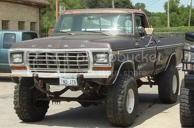

7.3 should fit fine between the frame rails.
Not exactly the same as mine was sourced from an OBS, but you get the idea. Plenty of frame space. Bushwacker cutouts FTW!
