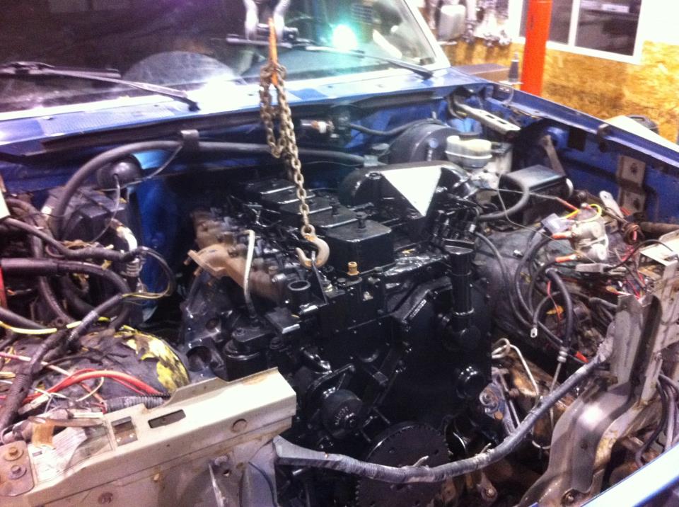

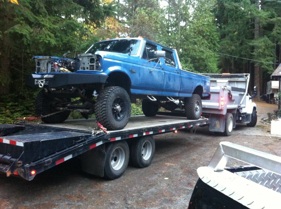

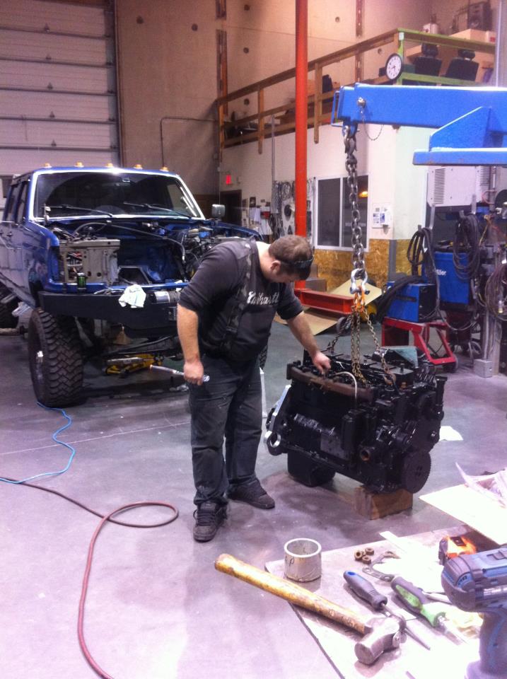

nothin much out of the norm just the age old installing a cummins into a ford

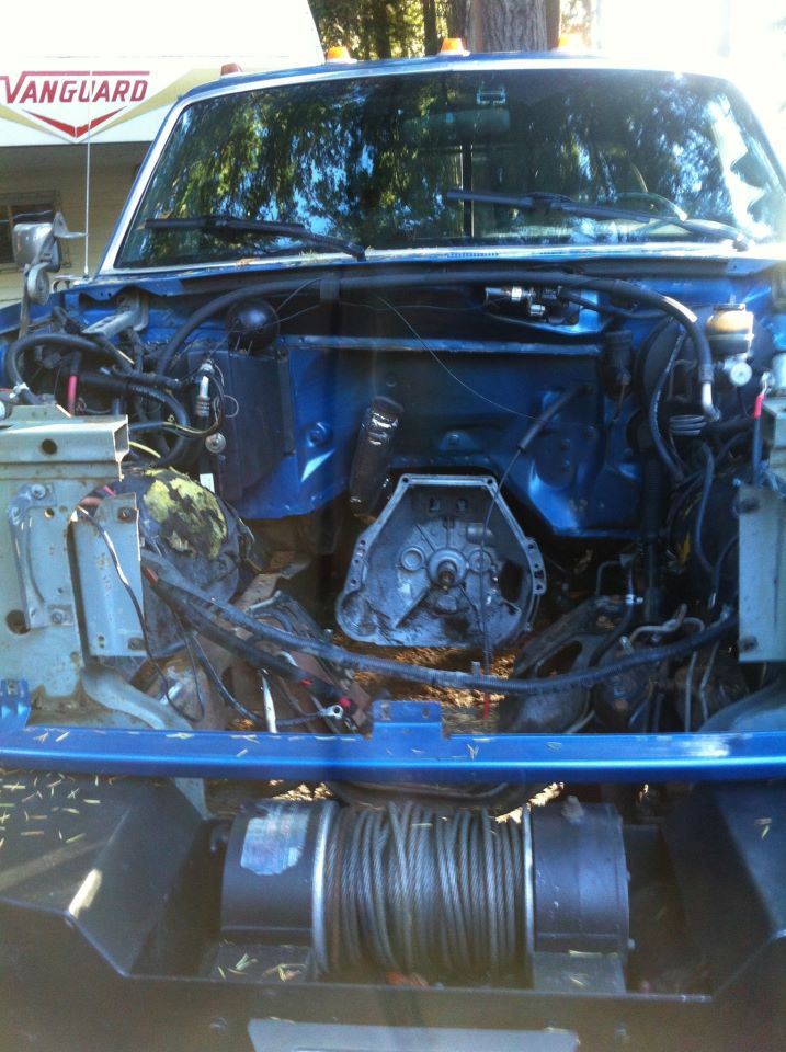

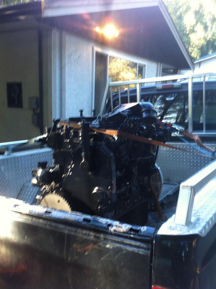

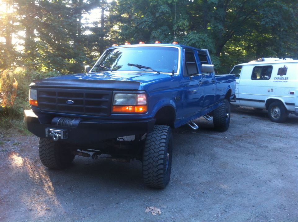

97 12v basicly stock for now re-timed the pump and governor springs . running the fordcummins plate on the zf5 :fordoval:
