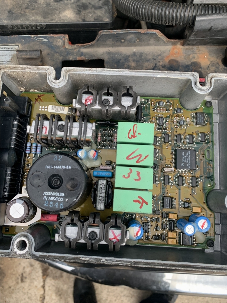

Just thinking out loud: Doesn't that IDM have the "140V" mod done to it (it looks like it)? Not sure if that might cause any problems like you're describing if the mod went south??? Cheers!
Mar 19, 2019
50
Yes sir I did that 6 or 7 years ago. All the solder looked good but who knows.
Picked up new IDM and 3 extra relays just in case tonight. Swapped in new IDM and she cranked up and ran
