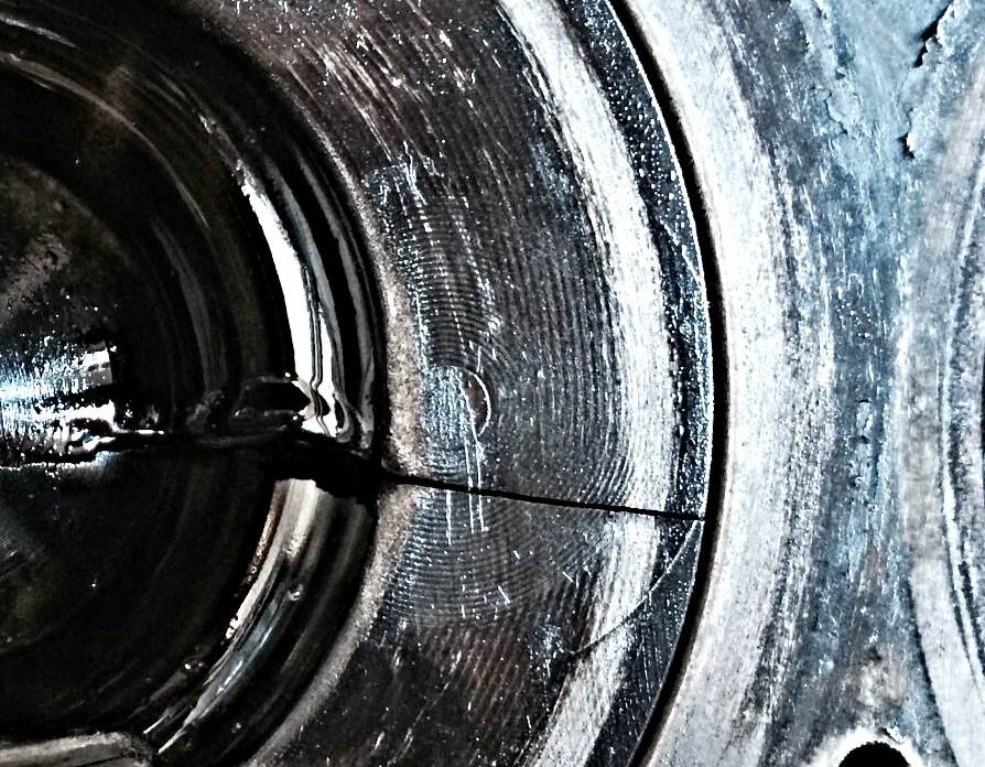

Not to derail but IMO if I could go back I would have done springs and pushrods when I had mine studded.
Never raced mine just loaded bed headed home for the winter, Everything was cool as a cucumber temps wise and didnt break 1000 when I was pullin through Tehachapi Ca. Passing semis.....(BEFORE* Intercooler and Rad.) but I did exceeded the maximum EBP based on the photo above. I had been told that EBP would be fine unless raced..... So i didnt Check it because i wasnt close to WOT for only long enough to downshift. Wasn't racing didn't go WOT because charger, Z-max, turbos (mods in sig) were less than 1500 miles old. But that didnt matter. About 6 hrs later in the middle of the desert with 20* temps I was stuck 672 miles into the trip with no heat and still 1700 miles from home... No fun.
Not to scare anyone just my personal experience. Heard of many people that didnt and were fine, but my truck and the ones I've been around almost all of us have had problems minus the one who did springs and pushrods.

Forgot to mention when I was stuck in the desert I only had the 71 my 59 came in so late I had to put the truck together without it. And the EBP was higher because of that but again I was told not to worry. The 59 really helped but doesn't completely fix the issue but can't expect much better from a somewhat factory compound setup with no gate.
