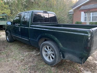

I just bought it this weekend it’s a 99 f250 2wd front axle, but has a transfer case. I worked on it a few months ago and told the guy ( who had just bought it) if he got ready to sell I would be interested, so here we are. It has a lot of really nice suspension work. Dual hpop’s, s467, magnafuel pump, roll cage,4 link with summit machine links, driveshaft loops, Custom radius arms, adjustable coil buckets, the adjusters are in the bed, ssbc brakes. It’s built very well and is pretty strong, I have a lot of clean up and a few things to tidy up on it but overall seems like a really nice build. It appears to have been done for a while. I just snapped a few pics, I know they are bad, I will clean it up and get more. Any info on who built it and what they planned or did with it would be awesome.

It definitely has bigger injectors, I may pull them and have them flowed if I cant find any info on the truck. It’s the strongest 7.3 I’ve ever been in. not as fast as my 6.4 truck was when it was built with max powers and all, but it’s no slouch.

I been working late these are the best I got in the dark. I will get more tomorrow. Thanks.

Sweet truck!
Looks like a lot of fun!
Any plans to do 4x4 front?
